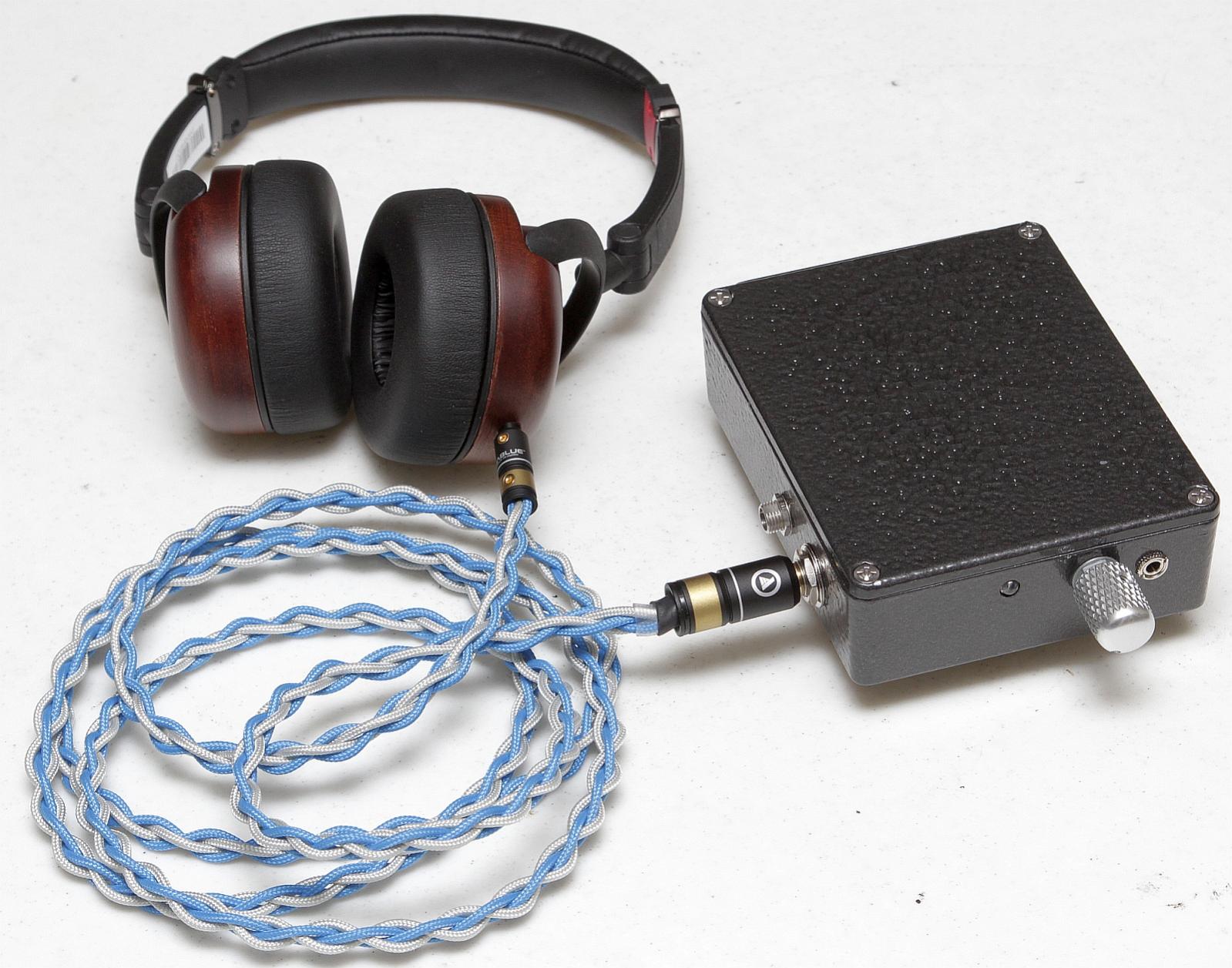

So here is my rough build on the PCA on steroids. Waiting for power supply bits. IFR610 doing the heavy lifting running 119ma bias with Similic 10uf on the inputs and 3300uf Pany FR on the outputs. 15000uf caps on the power supply lines from Apex Jr. one of the vendors on DIY. Currently running a lab supply until the other PS bits arrive.
I also have a battery only PCA and have been going back and forth listening to both playing the same songs. Source is a FIFO X3 playing FLACs and the cans are Thinksound OB-2.
To my old ears you would not be dissapointed listening through either version of the PCA. The PCA on steriods has a little more bottom end and to me seems a bit more forward. My plan is to turn the super PCA into both a headphone and line preamp. Something small, yet sounds very good.
I have several other DIY headphone amps and this is right up there. Just plan fun to build them.
