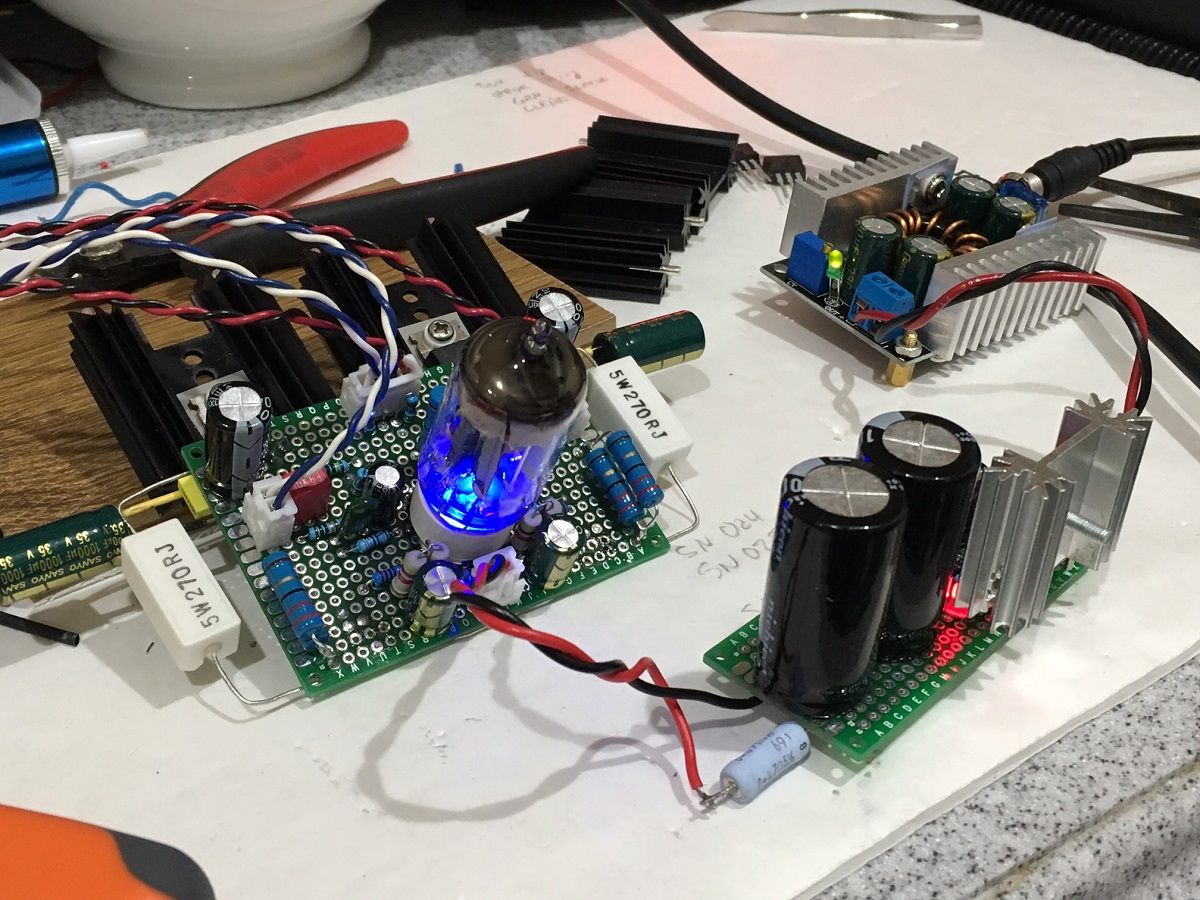

Sodacose's Estudiante Amp
Well this is my first tube amp, ever. Thanks to Sodacose for providing me the tube and schematics and info (available here in his blog).
Schematic:
I had some issues getting it to run initially because I did not have the correct "HV" version of the LM317. So I am using a simple 270R 5W resistor as the MOSFET current sink. So very similar to the PCA in topology. It's running off of 45.5v rails at present (3.5v hit due to MOSFET cap Mx). Gives me about 89mA bias current which is plenty for the OB-1 or DT880-250 cans.
I did modify the circuit a bit - I added a 1uF 63v Wima MKS input coupling cap plus a 680pF 100v film cap to ground on the input to filter out RF pickup and added extra 1000uF for 1470uF total output cap (just cheap no-name Chinese caps - but measured relatively low ESR). Right now the LM317HV is simply replaced with 270R wirewound cement 5W resistor. I am using IRF610's as I have those on hand. Works fine with the IRF610's and some local heatsinks. When I do get the LM317HV's the four TO220's will provide a 4-point under-hung bolt pattern to the bottom panel of an aluminum case for a heatsink.
It's a neat little circuit and sounds wonderful. Just test listening right now. No measurements yet but I can tell it has the classic SE Class A harmonic profile that we all have come to love from the PCA. This is a stereo tube hybrid amp that fits on a 6cm x 8cm veroboard. The cap Mx is probably not needed if you have a clean linear source of 48v. I am using a DC-DC step up SMPS so, amd trying to filter out as much as possible - plus I wanted a soft start mechanism to gradually apply power upon turn on to avoid in-rush current that would trip the SMPS into shutdown.
I'll probably start a new thread to show details of this build at a later point.
