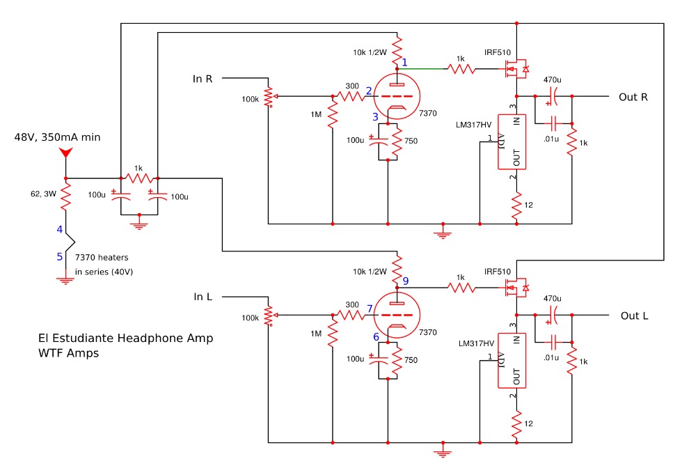

I actually have a hybrid tube amp design by Sodacose in the works. It's very similar to the PCA, but uses a tube instead of a JFET. I also have to build, one of these days, the inspiration for the Silicon Harmony: the Glass Harmony by Hugh Dean, a 28w into 8ohms SE Class A tube/mosfet hybrid amp. I think Hugh says that it is still the best amp he has heard ever.
Here is the design by Sodacose:

...the Glass Harmony by Hugh Dean, a 28w into 8ohms SE Class A tube/mosfet hybrid amp. I think Hugh says that it is still the best amp he has heard ever.
Wow, this must be something special. I see it is an old design. Any schematics?
Sorry, no public schematics for what remains to be the epitome of great musical sound from the Master of Musicality, Hugh Dean. 🙂
