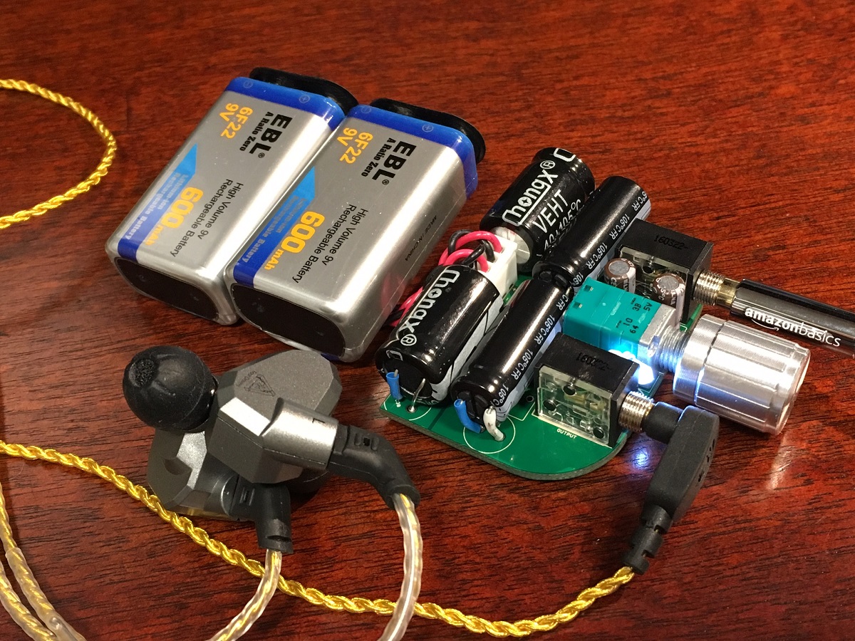

Here is my current all electrolytically cap coupled daily listener with my new 4-driver IEM's. The combo is very intoxicating - deep deep bass and superb highs. My verdict on the FR's is that they are excellent and do not appear to need any help from a film cap bypass. I would say that the treble is very clear - almost too sharp for some. The 1000uF 16v OSCON plus 470uF Nichicon AK and 1uF Wima is still very good sounding to my ears - perhaps a little more laid back presentation but with more bass punch due to larger value of nearly 500uF more when using 16ohm phones. Albeit, these are 1o6dB sensitive so doesn't take much power.
I am using 2200uF 35v 105C rated (no-name Chongx) caps for rails, 1000uF 25v FR for output, 10uF 35v Silmic II for input (brown caps). I took it apart for the photo of the insides for y'all.
