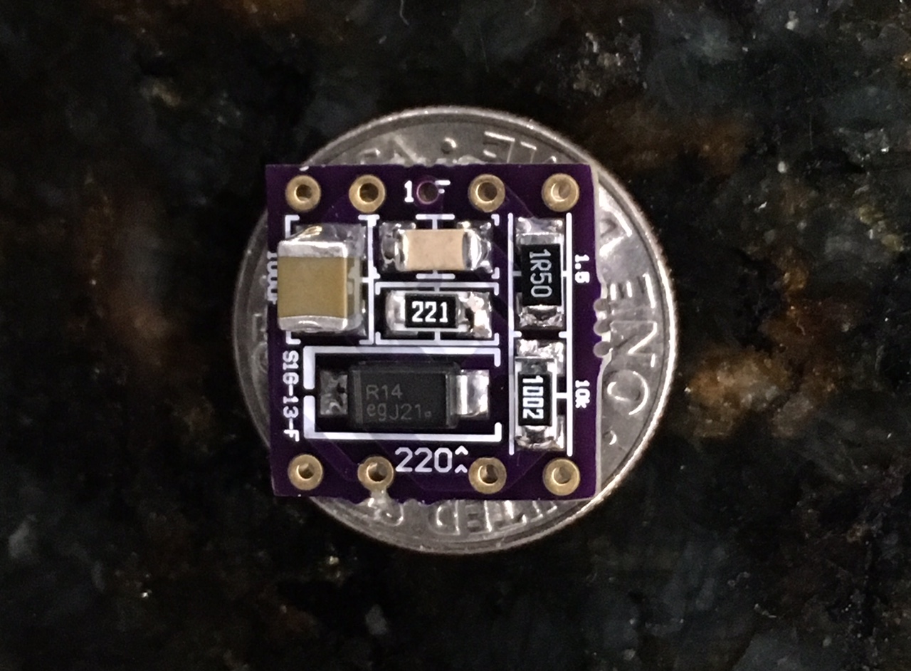

Hey RaptorL,
I just received the cute little cap multiplier you sent me! Very nice of you and superbly made. I never imagined something like this could be made to fit on a dime, literally. Great find on the micro sized 100uF cap (1210 SMT).
Thank you!!!
Thank you!!!

The BOM shows 16v but I think he may have went with 50uF 25v in practice?
I'm glad it arrived and you like it!
I did go with a 47uF 25V due to the input voltage being ~18V. At $2ish a pop I didn't really want to test the voltage handling capability of the 100uF 16V caps. However, I would like to know if the cap actually sees 18V, can you still get to the bottom of yours to put a DMM across it XRK?
Fortunately, the board labels will be good when they do release 100uF 25V capacitors in 1210 size. We're just not there yet technologically. 😉
Edit: There isn't a minimum for OSH either, I paid $1.50 for 3x of the cap multiplier boards, shipped... I'm kinda thinking they lost money there. Also on both of the boards there's a little test for silkscreen minimum size (which seems like the 10k/diode name on the cap multiplier board is about as small as they can go without smearing), and a tented via silkscreen overlay - to explain why "1uF" is cut off. Their tents don't fill, but otherwise they're quite good boards, especially for the price.
47u stacked?
Haha that's what I said. I may try cramming two side by side to achieve the same thing, even if one hangs slightly over the board edge, but only if 100uF will make a further improvement in the noise measurements over what 47uF can already do. I'll have no way of knowing, since I can't seem to get my sound card playimg nice with Windows/RMAA. X, you could perhaps test this, no?
You mean test 47uF vs 100uF relative to noise?
Nah, just test whether or not in the PCA (set to 16V input on the MOSFETs, or about 18.5V on the input to the cap mx) that capacitor actually gets more than 16V DC across its terminals. Would be nice to know if people can use 16V rated capacitors or not.
