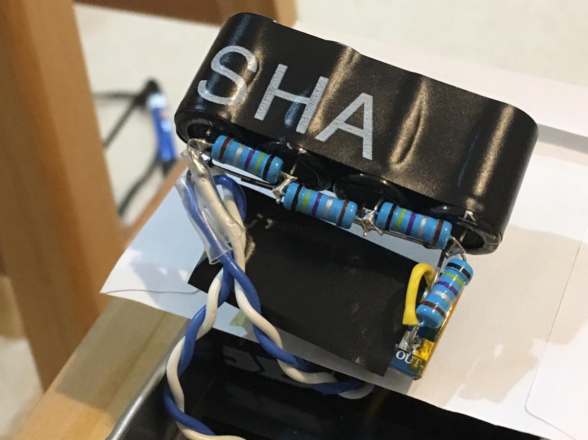

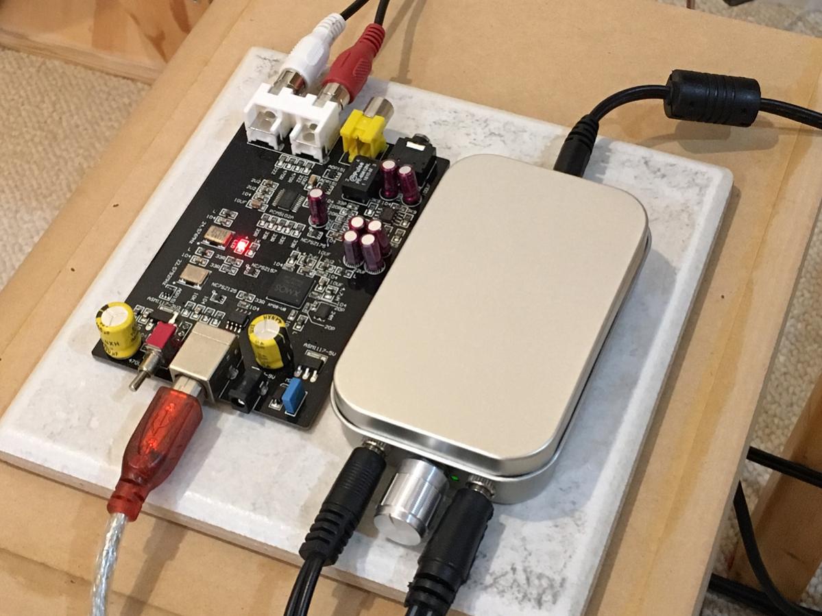

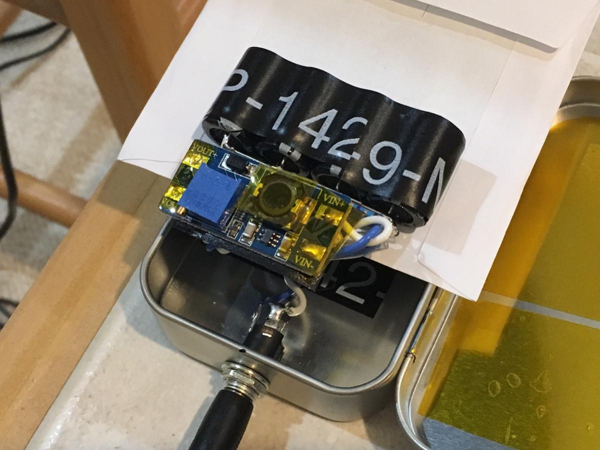

Desktop internal PSU DC boost and RCRCRCRC
I forgot it is actually an RCRCRCRC (4 caps!). Each cap is a 2200uF 25v and each R is a 0.47R 1W. The DC step up is the MT3608 as mentioned in above post. These units are little marvels of engineering and under $0.50ea. They boost AND regulate. The chip itself with proper heatsinking claims 2amps - don't believe it but 200mA seems ok. I have blown a couple up by pulling twisting the trimpot too far on the higher voltage side. The chip itself literally explodes and glows red hot and spews smoke - quite a dramatic show. So be careful when twisting the set screw CCW.
Here are some photos of the combo, you can see I wrapped the caps in black PVC tape and added Kapton tape over exposed contacts of step up board to prevent a short inside the amp case. The 5.5mm power inlet jack can be seen on the end. The DC step up is on the moment you plug it in. The amp does not turn on until the volume knob is clicked on. I leave it plugged in and on 24/7 so no need to worry about turning off. I tried 18v Vcc - it works well but generates a lot of heat as the resistor array was too hot to touch more than 2 seconds.
I will add a 10uF 50v x7r MLCC at the input right after the first 0.47R.
As a side note, this preamp will drive 10v peak-peak (at <0.5% THD into 270ohm load of the built in load) so should be able to handle any power amp. I always see people in Pass Forum asking same question on a variety of threads: "can this drive an F4 amp?" I guess the F4 must sound really special but it is a current amp with -0.3dB gain so it needs a powerful preamp. This pocket amp would be the perfect preamp for an F4, IMO.
