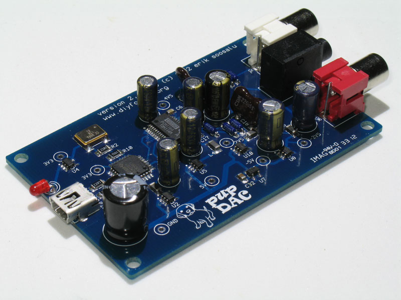

If you're looking to build a system of 'smalls', take a serious look at this DAC:
PupDAC Overview. I just finished mine,
and am using it with this USB decrapifi'er:
DoodleBug Overview
They are both available in kit form here: Beezar Audio
I am very happy with mine, and definitely recommend them as a great match with
the 'X' amp.

Thanks for the tip Funch. That PupDAC reminds me of the XMOS U8/BB PCM5102A DAC that I have. I just need to put it in a case. It's $43 from Aliexoress. Sounds great. Needs driver disk bough (included).

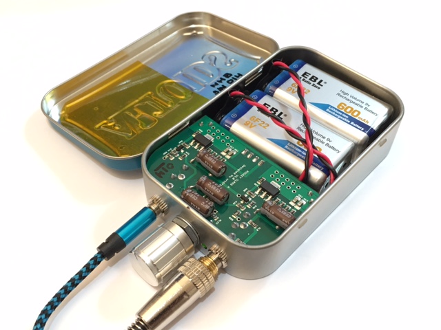

I was wondering - can one DC couple this amp and leave out the input caps?
No. The input to the JFET gate requires a DC bias provided by R4. It's about 1.5v to 1.8v and allows the JFET to control the bias setpoint of the MOSFET. The AC coupling allows the DC bias to work.
You have to AC couple the output anyhow. If you notice the review by Michael, there was no shortage of bass, treble, or sound stage/imaging despite being cap coupled.

Thank you, but I did not really fix anything. Would still like to know what the cause was - it might occur in future again.
Could it be heat? I have read about thermal shutdown somewhere, but how would a mosfet behave if it gets too hot? I was running on 19,3V at the time (when the distortion in one channel started) and as I said - the mosfets could only be touched for 2/3 seconds max. I have since tuned it down to 18V. Considering to glue small heatsinks to the mosfets for my uber version.
That might be heat. Those MOSFETs are rated at 3w max dissipation but I would guess the little on-board copper plane is good for maybe 1w max. Running at 19v and say 75mA is 1.42w ea (mosfet and resistors) so I would not be surprised it it was too hot. Those resistors are rated 1/8th watt x 4 is 0.5w. Assuming half the dissipation is from the resistors, they would have been running too hot. The resistance changes when it is too hot - not sure if it goes up or down for metal thin films - I am guess up. So it may have causes a very low bias situation because R goes real high?
Here is my latest unit designed to drive a 13.8ohm load with 115dB sensitivity (Andromeda's). With two 1000uF Oscons and a 10uF Silmic II on output and 10uF Silmic and 2.2uF Wima on input. With LTSpice sim I get 0.05% THD at 106dB SPL with 96% being H2 and balance just H3 and. Ofhing else. Frequency response is flat to 15Hz at -0.5dB. This unit is going out to Poland tomorrow after a 4hr burn in. The sound is perhaps the deepest bass impact Inhave heard on my 55ohm OB-1's. Actual test at 270ohm load and 700mV (about same drive level as 106dB on Andromeda's) measured only 0.02% THD and all H2, H3 almost non existent (-90dB).
Awesome X. My current cans are also 55ohm, so I assume this cap configuration is pretty much ideal for low impedance headphones? I have been reading through the thread just yesterday with the view to order caps for some rolling. Thanks, now I know what to get, unless Stellar has a different opinion. 🙂
Sorry, just a noob question - with two 1000uF caps and a 10uf cap in parallel you have 2010uF per channel on the outputs?
What are the part numbers of those 1000uF oscons? I assume they fit the board without alterations?
Here are the cap part numbers from Mouser. You need two per channel or 4 total.

Thank you for the part numbers. Finding the Elnas was no problem, but I was not sure about the oscons. The oscons are 16V, is that ok?

16v is the right one. The part number starts with 16...
