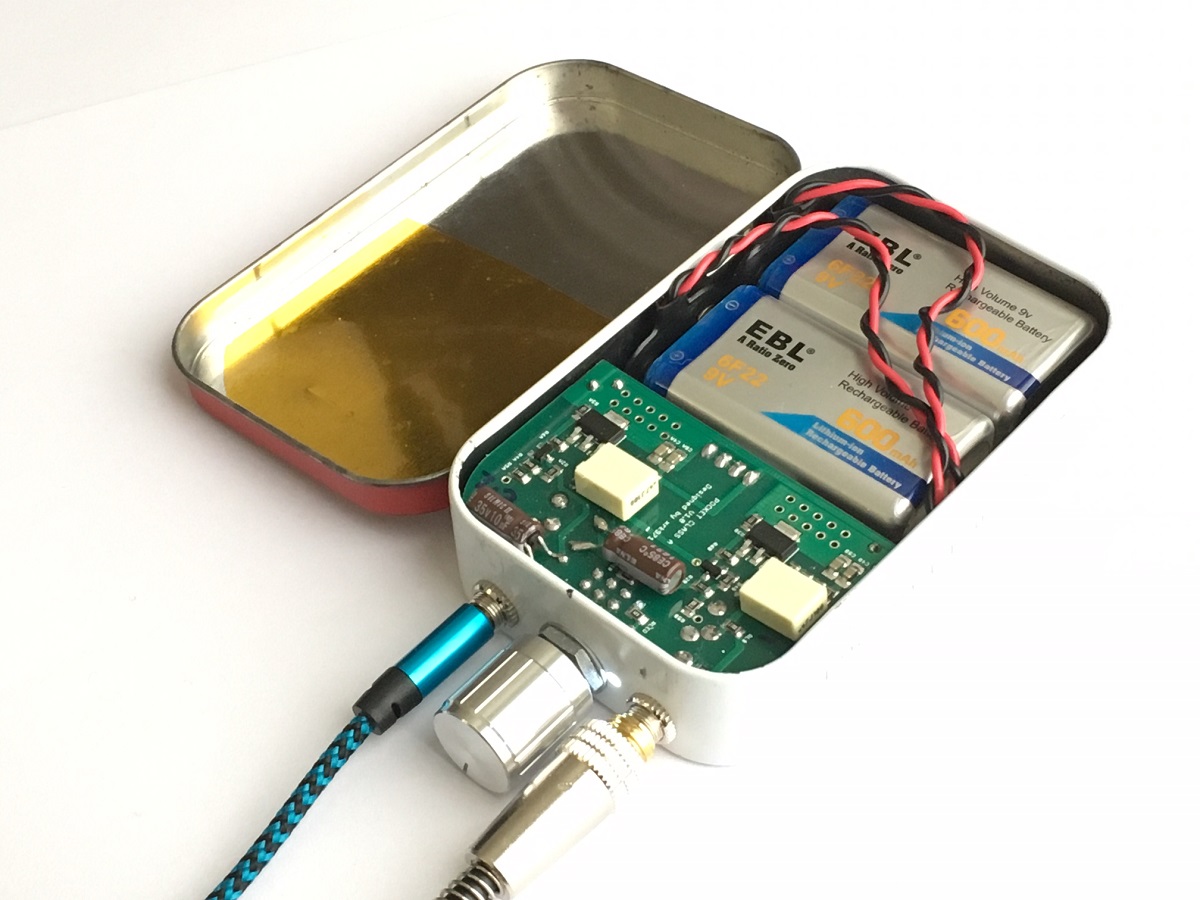

Nice. Now you just need to hire a tool and die shop to build you a custom hole puncher that can put all four holes into a mint tin with one pass!

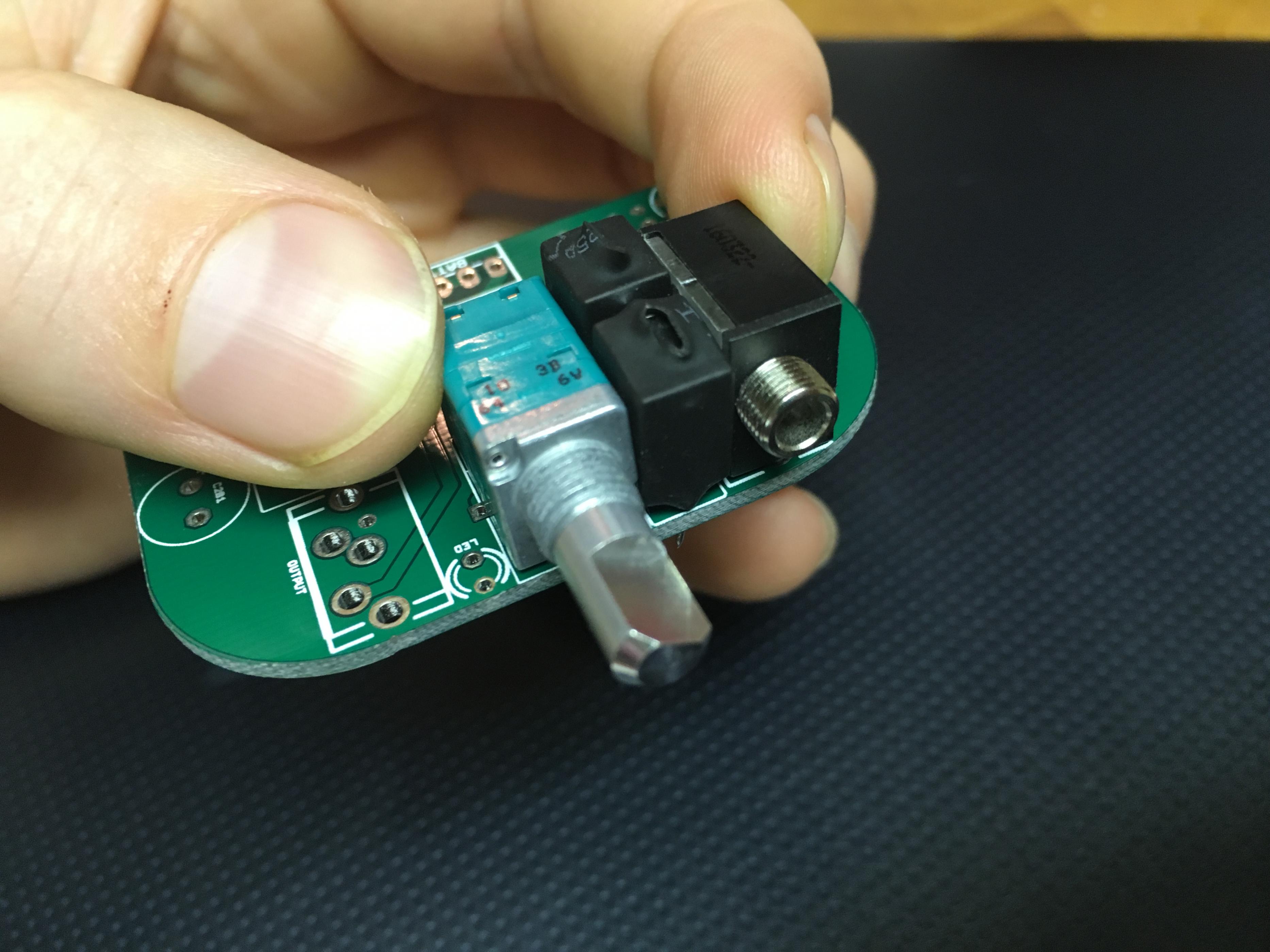

The single paper punch is amazingly effective. I have had 100% success ratio with it and it's pretty fast. I ream the pot hole with hand reamer after main punched hole. LED hole is still drilled. But while process is not too bad.

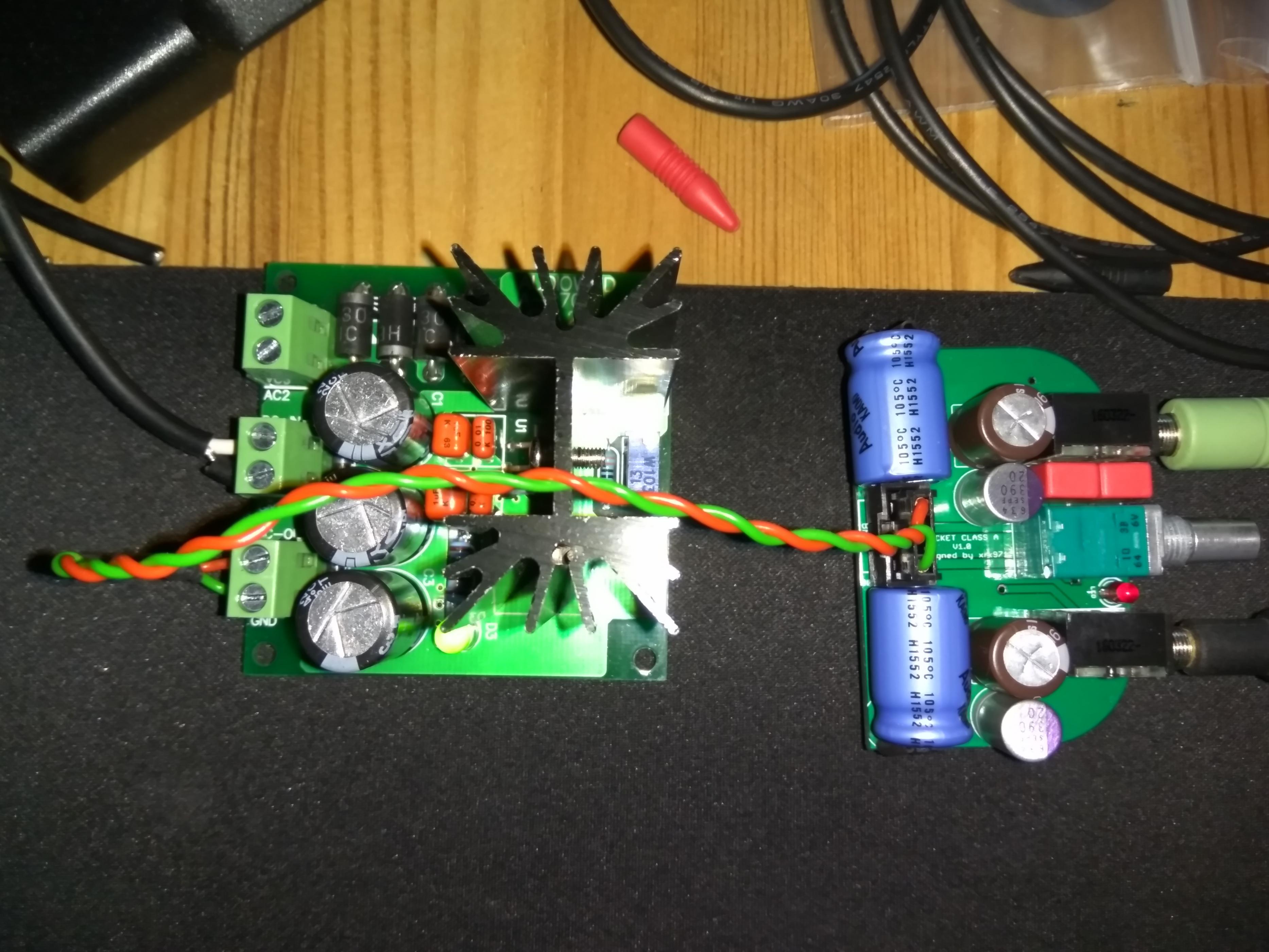

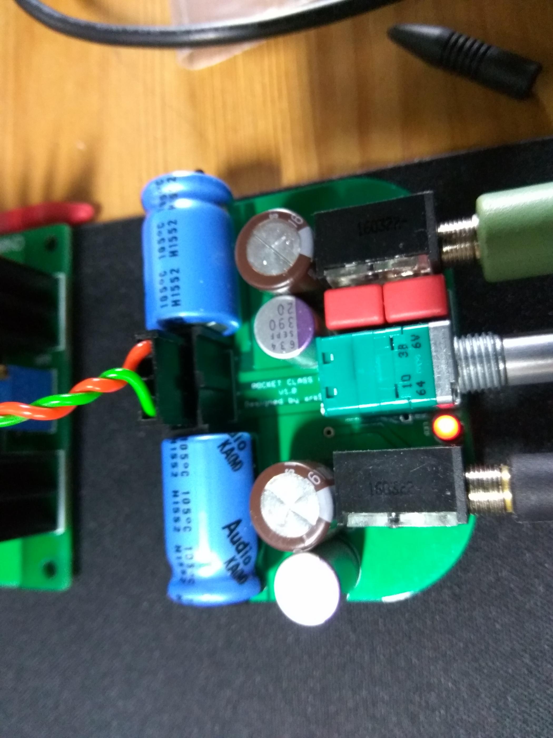

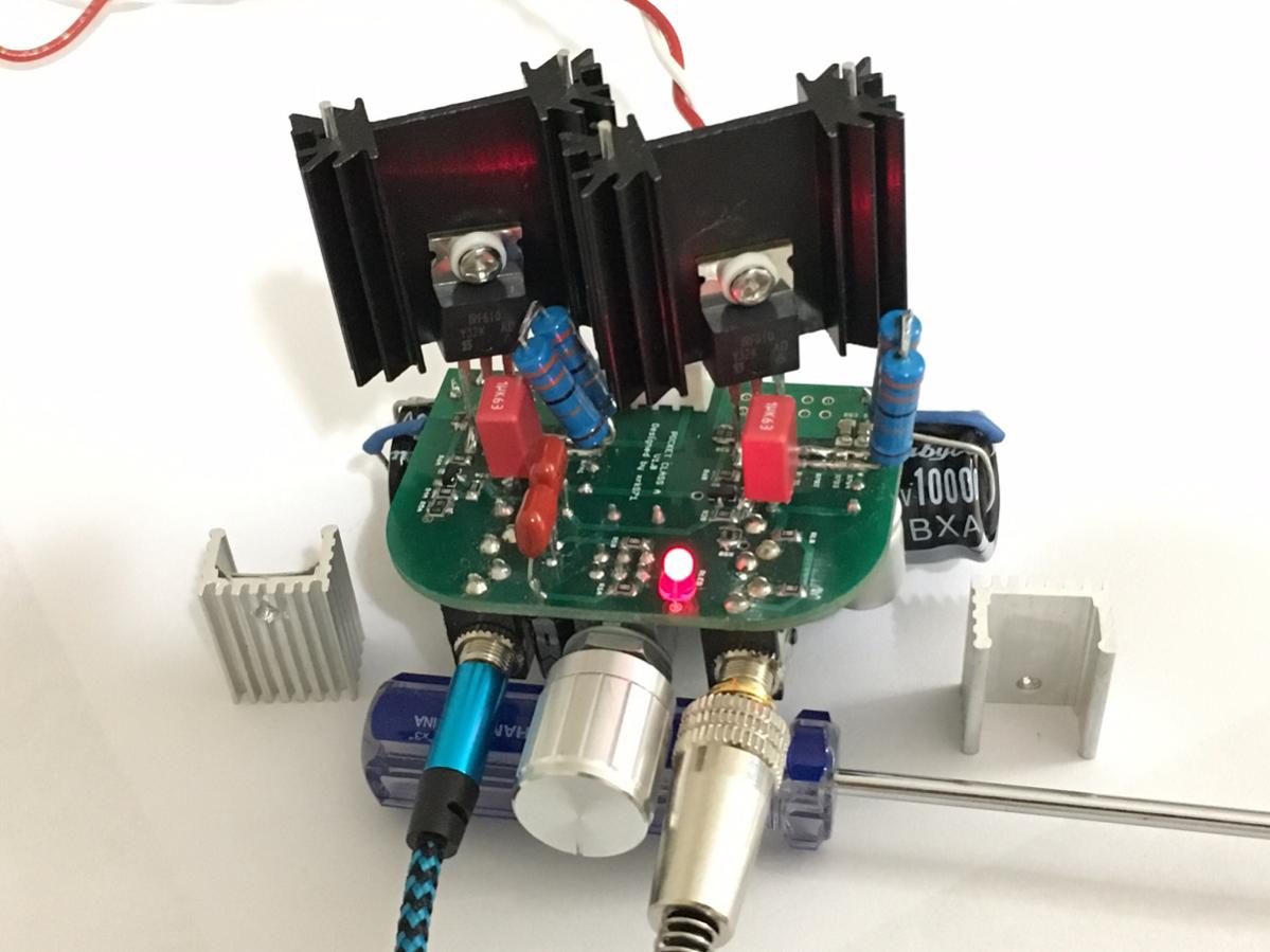

Hi, here is my version of the pocket amp with a mix of silmic 2 and Nichicon KA. It works very well on the first time, listening with a Sennheiser HD590 it sounds very good 🙂.

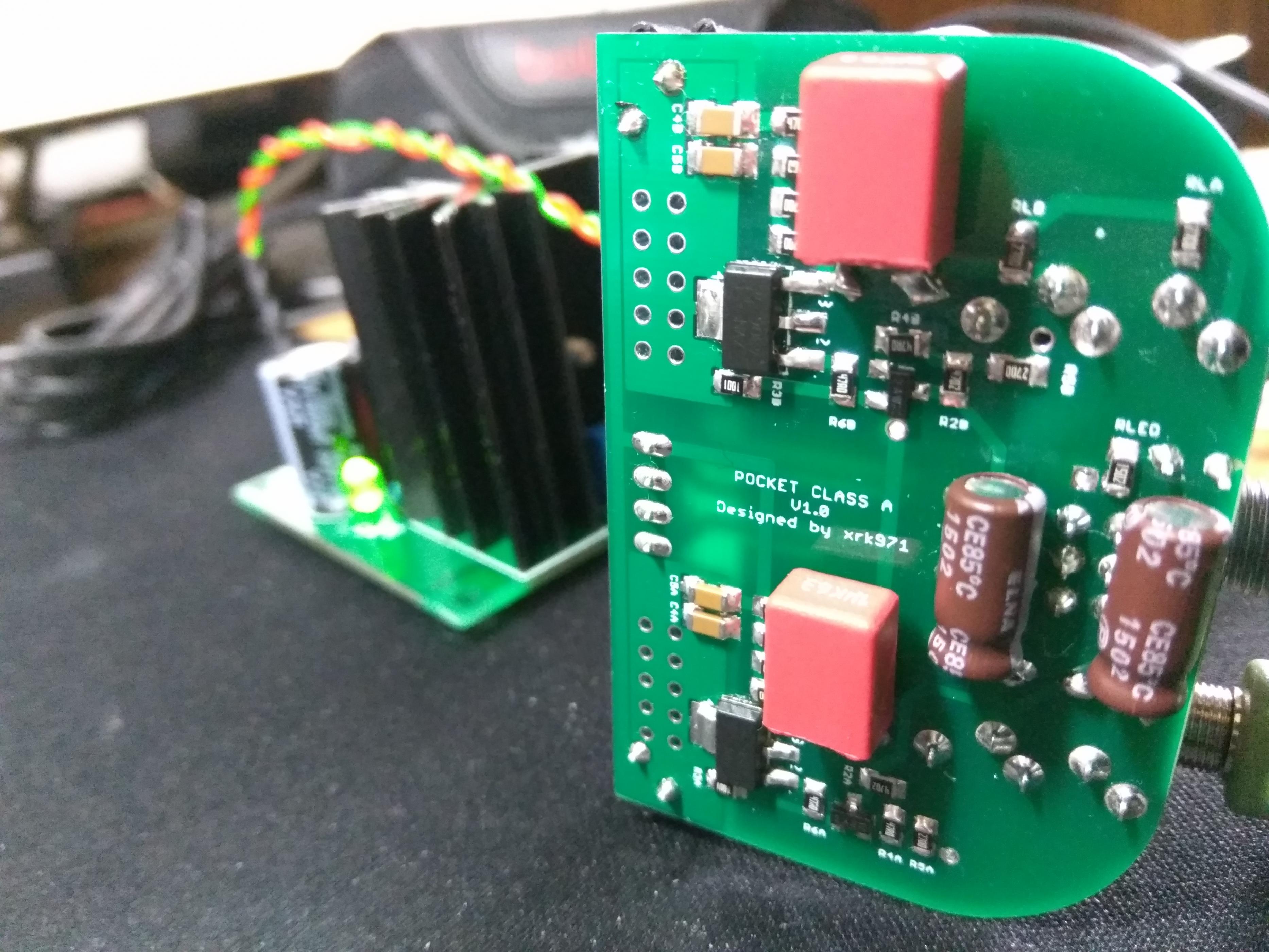

With matched Fet's tensions are very closed with 60ma at 16V in both channels. Do you think I have to get rid of this 1uf 63v Wima on the back of the board keeping just the silmic II 100uf?
I want to make the second board working with 18V for a desktop amp. Thanks for this very cool amp xrk971.

hey aren't the KA on the power supply, which means that it's not in the audio path? and you have what looks like OSCON + Silmic on the output?
Yes, KA are on the power supply, not the best use for them I think 🙄. I should try something else like 10000uf 25v for rail cap you think?
Output is Oscon 390uf 20v and Silmic 100uf 16v // with wima 1uf.
maybe it's not the best use of the KA hahahah im sure the 10,000uF on supply can't hurt 😛 will be massive though
This amp has 10,000uF 25v rail caps.

Very nice work Jacorius! Glad it worked out the first time. I found that the 100uF Silmic doesn't need a 1uF film bypass. It's easy enough to remove it and listen.
Ok, thanks I will try that with some tweeks in the rail caps 😀 (2200uf 25v for example)!
Yes, with 2200uF you can boost rail supply to 18v. I see you got the regulated PSU from eBay that I got. That one will get you 18v with a 19.5v laptop SMPS as input. Make sure you use a name brand one like HP, Dell, IBM, Sony, Acer, etc. the cheap $7 ones are very noisy.
For the moment I find a 18V SMPS coming from a Cisco switch. It works very well with the small regulated PSU. My headphones are dead quiet even with max volume.

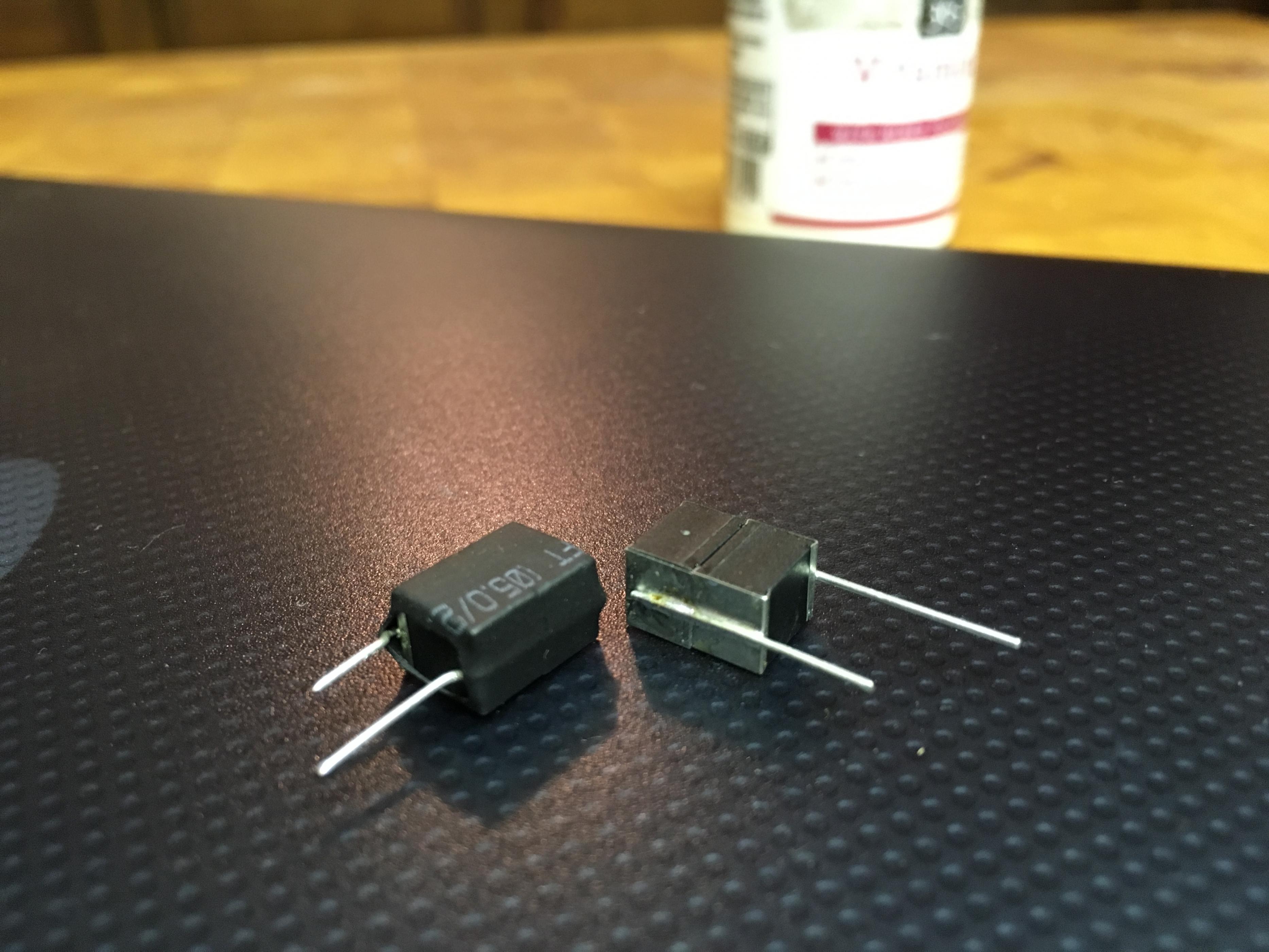

Slick packaging there StellarElephant! I have a high end ultralow noise PSU that I bought and it has these black caps that are about same size and appearance - I wonder if they are PPS? They are on the diode bridge snubbers.

Btw these WIMAs have a completely unmarked black case, so you may indeed have them in your PSU, X.
