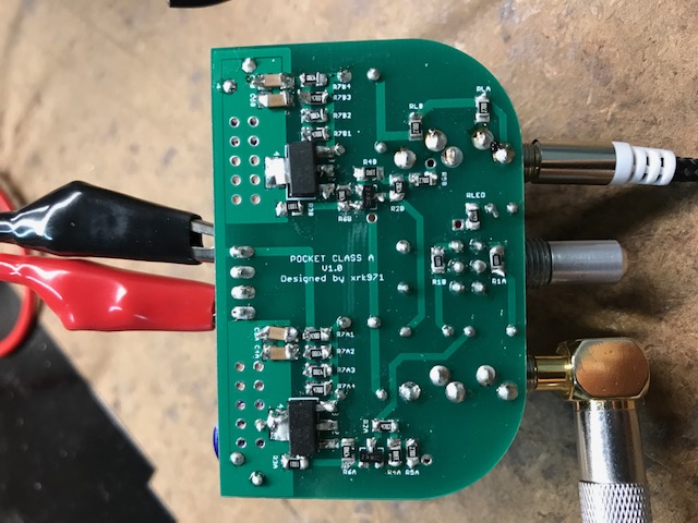

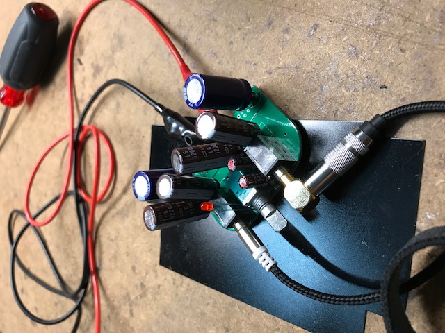

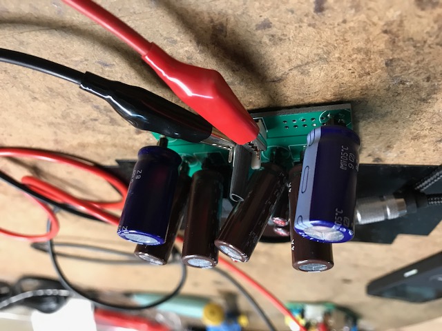

I've attached my board for reference.
I am using an open frame 18V 40W power supply, and I am clamping the wires to the outer battery pins (see pic), I ignored the two inner pins, is this correct?
I wore two anti-static bands, one is the cable-less with a cap, and the other is the old school wire attached to an exposed metal switch on my PC.
I had trouble soldering the mosfet and jfet, and I am worried they may be damaged by heat?

Pin 2 of ZVN4306 should be same as PSU or 18v. Are you measuring relative to GNd (0v)?
So strange that you have 3v on pin 3 but 0v on pin 2. Is your PSU putting out 18v - that should show 18v at pin 2 (1 is pin left, pin 3 is same as 4 resistors next to mosfet). Pin 2 is same as big tab soldered to heatsink on PCB.
I would suggest you solder some wires to the battery input pins (on SMT side) and connect to PSU. The alligator clips may be giving a bad connection.
When you measure across R3, I literally mean across it: DVM probes on either side of R3, which, btw for the top of R3, is the same as big tab on mosfet pin 2.

I think your MOSFETs are bad. Your JFETs may be ok. Try changing out the MOSFETs first and see what you get. When you measure caps measure relative to ground and not across pins. Positive pins of C2 should be same as Source on MOSFET. Positive on C1 (facing JFET) should be about 1.5v if it's working right.
Are the MOSFET heat dissipation areas electrically connected to anything? It looks to me like babysupra may have a solder bridge between one MOSFET drain and the cooling pad. This might explain why one channel misbehaves, but not the other.
Can you post close-up pictures of both sides of the board?
