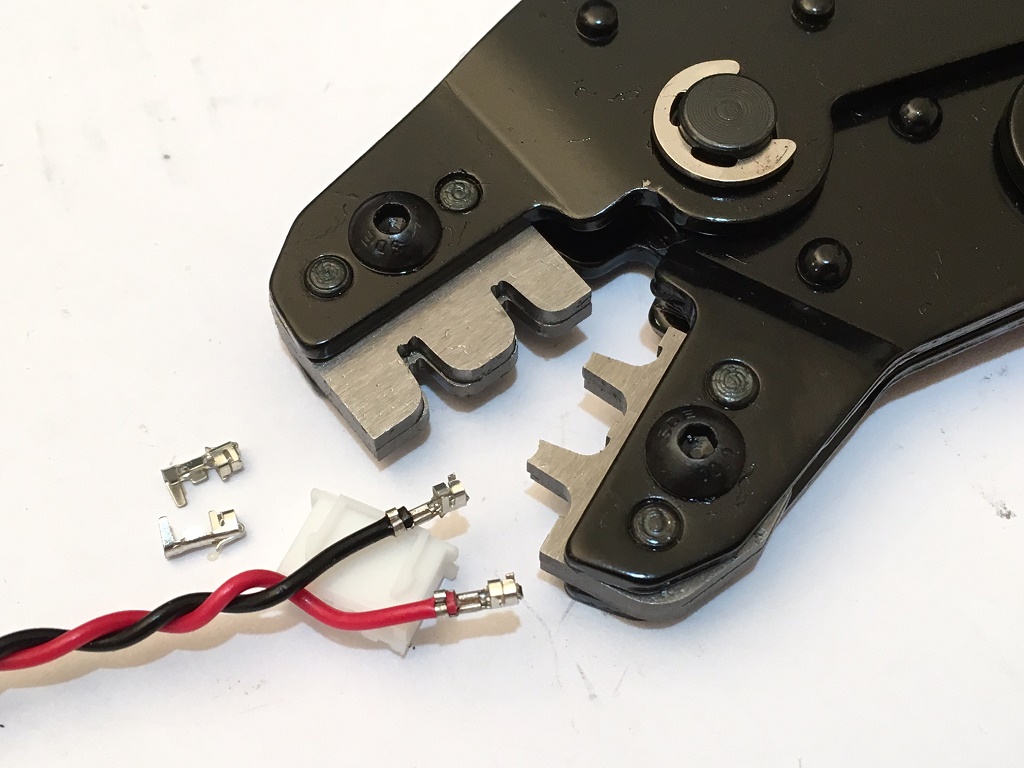

JST connector crimpers
Most of you guys probably are ok with hand soldering the 4 connector JST battery connector to the tiny 9v battery leads since you only make a couple of amps. I have been doing this by hand and believe me, it gets old after the second amp. Plus its not very sturdy, I always have to apply a small amount of solder and then use the tips of my cutters to fold and squeeze the tabs over onto the wire and insulation. A very unsatisfying and time-consuming proposition. The battery terminal wiring was perhaps the most painful step in making these amps. The rest is quite enjoyable.
Anyhow, for $23, this has all changed! I just bought the IWISS JST terminal crimpers. I wish I did this sooner. In 30 seconds, I can make a perfect beautiful professional crimp connection that folds the tabs and pierces them into the wire and the insulation to hold it all together. It is an amazing tool that really saves time if you have to do this a lot. Now that I have it, I can find uses for the small 2, 3, 4, 5 pin JST connectors for a lot of things. Like: audio in/out leads to the PCB, fans, LEDs, signal switches, power leads for batteries (like RC model LiPo battery packs), etc. The uses are endless and the connection is super secure and the connector shell and parts are very inexpensive.
Here is a photo of the first ones I crimped. It came out perfectly.
