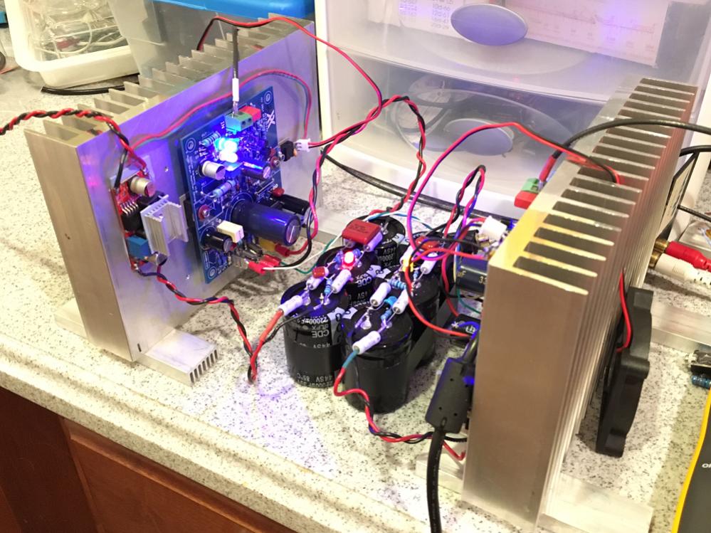

In glorious stereo! Running 1.25amps bias, 32v. Simply amazing sounding on OB-1 cans. These are true monoblocks with separate SMPS power supplies which are able to achieve -126dB flat noise floor with no peaks from 60Hz line or harmonics (like a big 32v battery that can pump 2.5amps all day). Absolute silence when music not playing. On some tracks with large dynamic range, the crescendos can really sound frightening if you are not expecting it. It hits like a crack of thunder that catches one unaware.
The CRCRC filter is point to point, the DC to DC step up converter is available on eBay or Aliexpress - look for XL6009 buck boost converter.

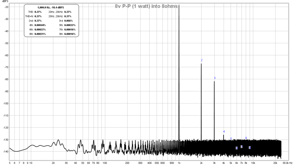

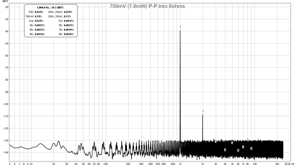

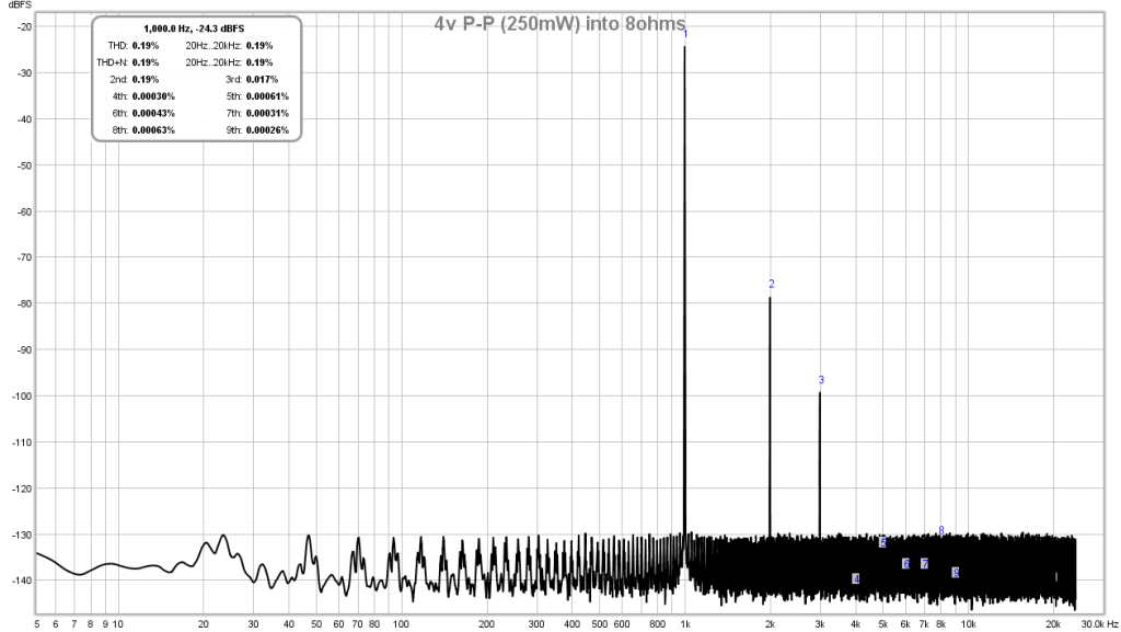

Measurements of Silicon Harmony (1.25amp bias) with 8ohm load:
8v P-P (1 watt):
4v P-P (1/4 wtt):
700mV P-P (8mW) - this is still an extremely loud volume on most heaadphones:
A great sounding amp.
8v P-P (1 watt):
4v P-P (1/4 wtt):
What are the values for CRCRC ? Does this values need to be adjusted on scope?

I used Panasonic metal film 3W 0.47R and CDE 22,000uF 35v caps. Configuration is:
RCRCRC. First R is there to limit in-rush current into C to prevent auto shutdown of the DC to DC Step up. There is a 0.1uF 100v film cap low ESR bypass on output end, and 330pF and 51R snubber on input end of RCRCRC. Note that R is also installed on ground side to prevent DC switch noise from leaking i through ground path. I monitored the FFT and added RC stages until noise baxkground was low as if using a buttery: flat at -126dB no noise or mains bumps at all. Listening confirms dead quiet as in cannot tell it is on when source is zero.
