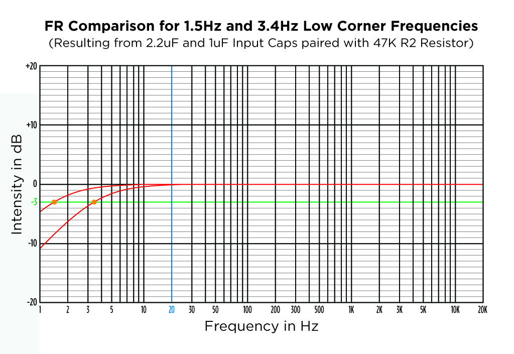

1uF may actually be plenty...with a stock 47K local feedback resistor (R2), anyway.
I've been having fun learning to make bode plots. If I'm doing it right, then either 1uF or 2.2uF will give full bass extension, since both set the corner frequencies close to the "textbook perfect" 2Hz. This results in no appreciable roll-off in the audible spectrum above 20Hz...well maybe like -0.1dB in the case of the smaller cap. I certainly don't think I'd be able to hear the difference...🙂

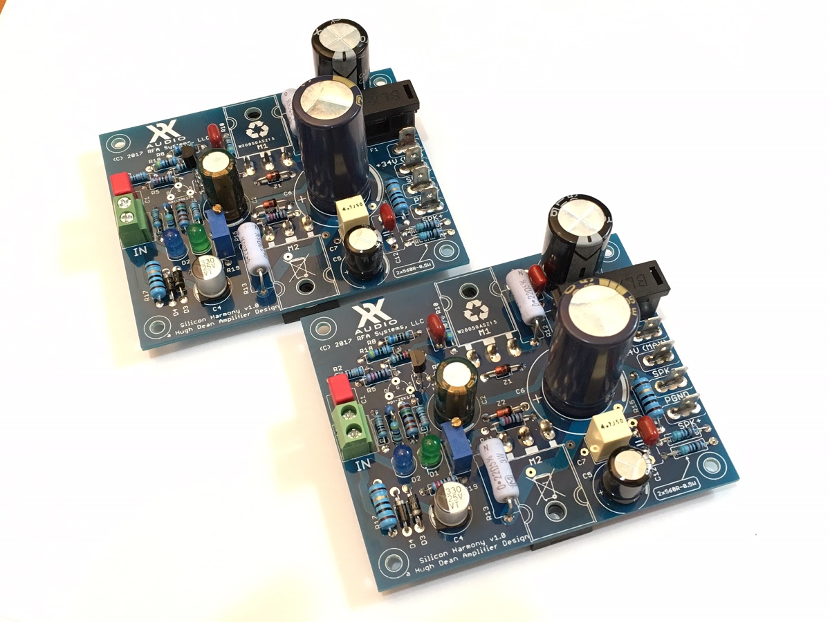

Presenting the Silicon Harmony - a CFP SE Class A amp with CCS developed in conjunction with Aksa. Intial tests at 1.5amp bias and 34v linear supply is simply stunning. Immense power and dynamics on 55ohm Status OB-1's.
Nice and convenient PCB design😉😀.
Nice and convenient PCB design.
Yes, the layout designer did a fantastic job! A true work of art 🙂

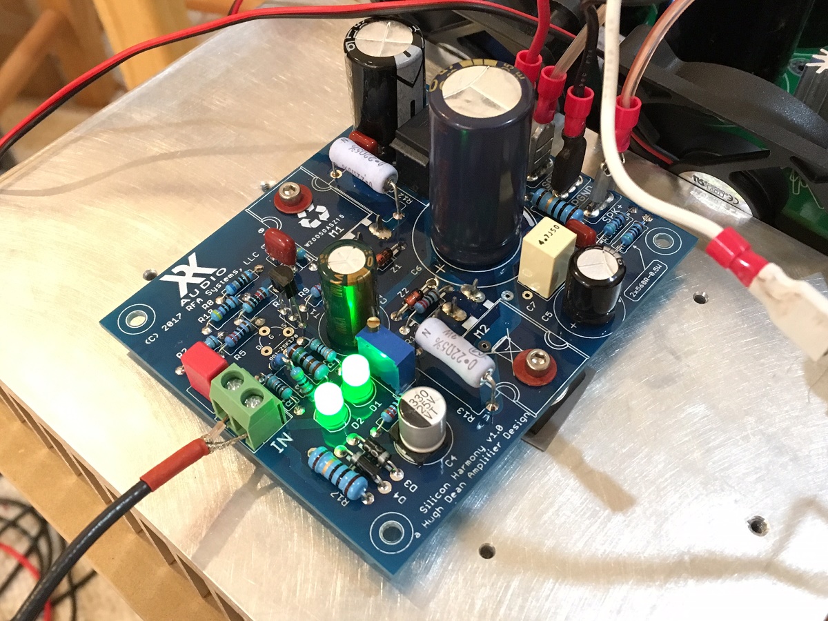

Nice! Are those boards available X?
Sorry, these boards will only be part of finished special edition desktop amps - still under development so spec's are not firm yet. It will be a fairly substantial sized case and PSU given the heat output (circa 45w to 60w per channel).
