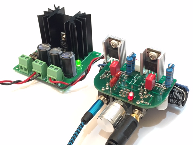

Testing the desktop version of this amp with a 19v laptop SMPS feeding a Linear Technologies LT1963A low dropout low noise regulator set at 18v. Amp runs at 113mA bias through IRF610 MOSFETs. Tested with 33ohm load parallel with 250ohm headphones in order to listen to effect of lowninpedanxe loading. Sound is very nice and bass is very good. No audible hum or noise at all. Amp is fitted with two massive 10000uF 25v rail caps and also using two 1000uF 16v oscons:

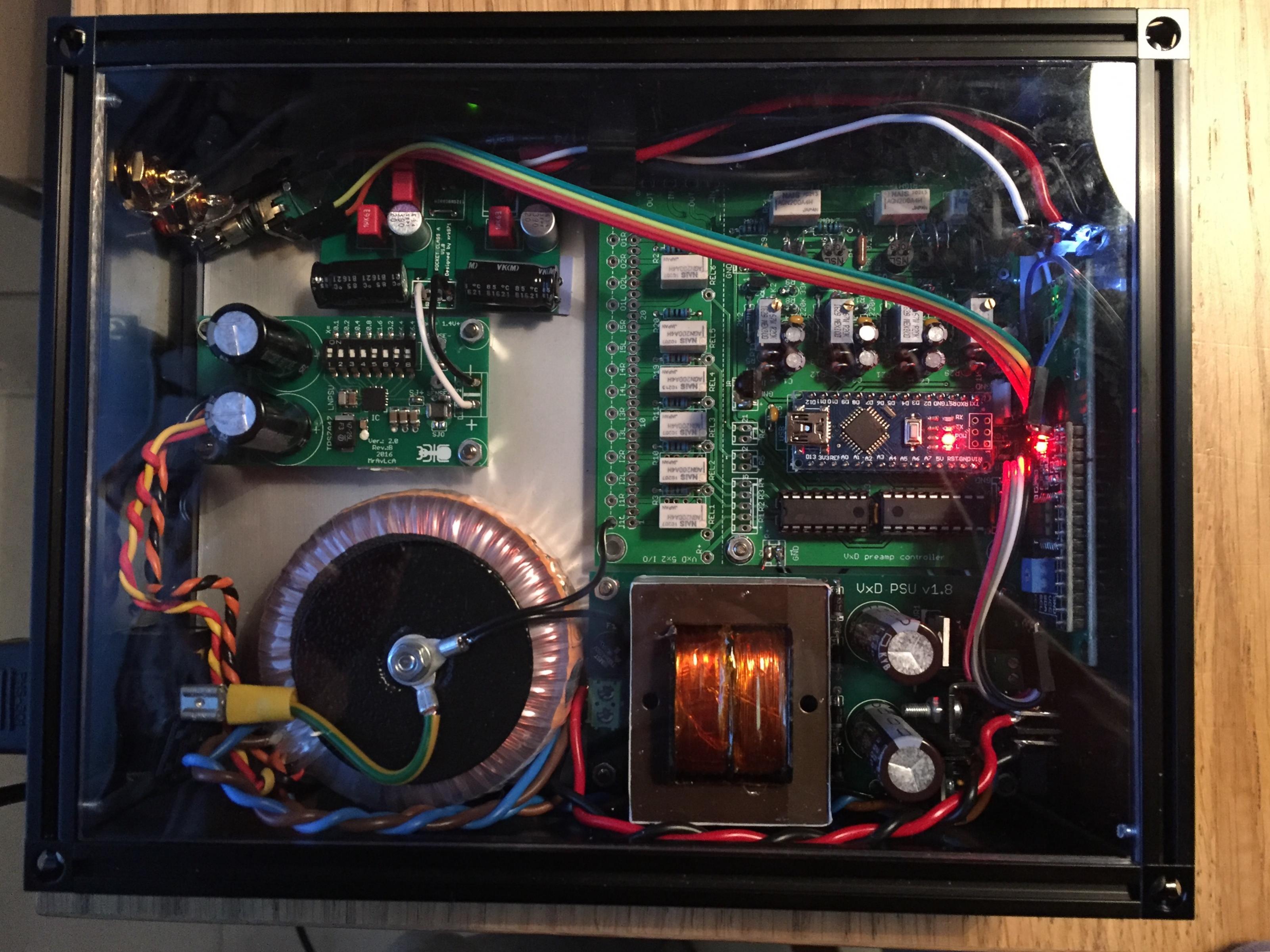

Here's my version of the xrk971's Pocket Class A headamp as a desktop version.😀
Most of the case is filled up with LDR volume controller and it's power supply. The headamp itself is powered via 30 VA 230/2x15V toroid and user Mravlca's TPS7A4700 LDO board. Voltage is set to 16 V.
FETs are matched by X himself and the rail caps are 2200 uF/16 V. Otherwise it's a stock build and the bias is running at 57 mA in both channels. The FETs are connected to aluminum bottom plate via silicone pads. I still need to make some kind of aluminum bar on top of the amp board to squeeze it tighter to the base plate with M3 bolts and nuts.
I propably will make new version of the face plate by using clear plexi glass and replace the power switch with rotary encoder. Now I have only remote control.
The sound is sweet, though I'm poor at describing the details. Well worth the effort!

Morde,
That looks absolutely fabulous. Nice work! Amazing how little the amp itself takes up! I was looking at a similar TPSA power supply regulator myself. How do you like it? Specs are 4uV noise and -80dB PSRR at 100Hz. Very nice. If desktop use and fitted with silicone heatsink - you can boost PSU to 19v if you change our those 16v rated 2200uF caps for 25v ones. The 19v PSU should push bias up to about 75mA to 80mA. Total dissipation will be circa 3.2W. But dynamics will get a big boost.
It's nice to see confirmation that my hand-matched FETs are really matched when you build the amp. 57mA is a great sweet spot as bias current settings go. At this setting you are getting classic -66dB H2 and H3 between -12dB to -20dB below H2, not much else in higher orders, and THD of about 0.05%.
