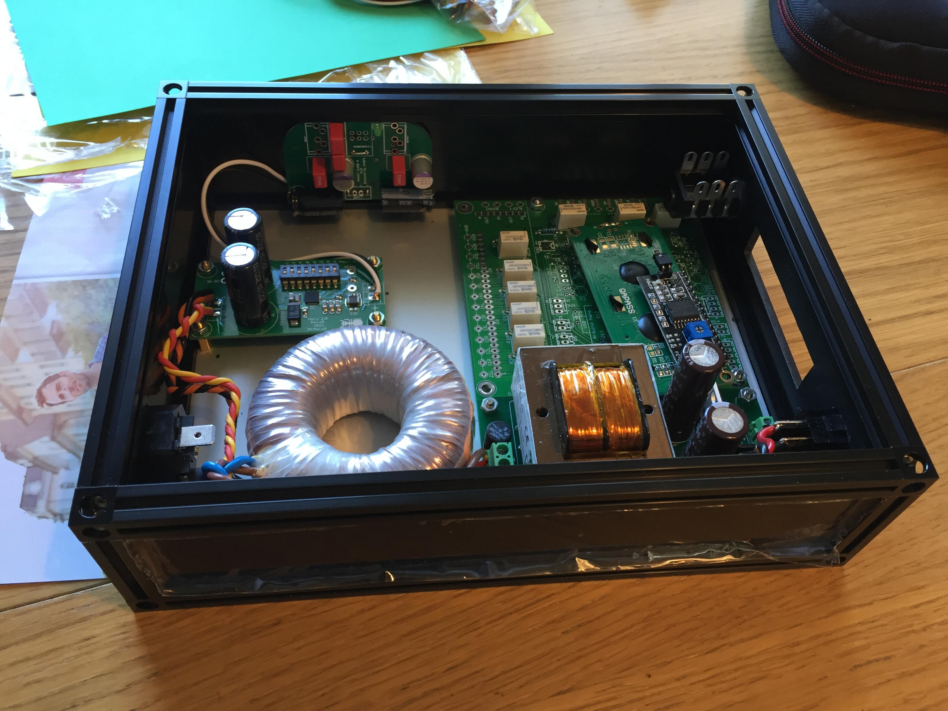

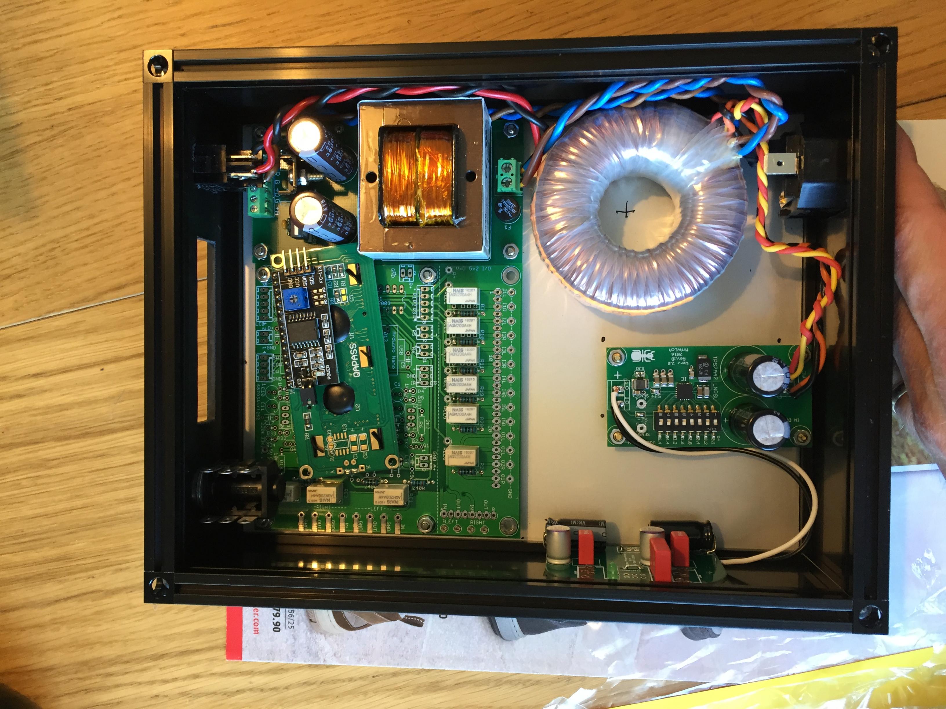

The thermal compound is a great idea, just ordered some. I think I'll try to connect the FETs to my chassis' aluminum bottom plate and if that's a no go I'll get the heat sinks too. See below my build. Most of the space is covered by LDR volume control board.🙄
That will work very well for a desktop amp. Simply clamp board to chassis plate with squishy thermal pad. Wish I put M3 screw holes on the board LOL 🙂
You can also use a clamp bar across 3.5mm jacks which seem very sturdy.
What's the you are using for a PSU? Looks like it had an IC?
You may need to double up thickness of pad to prevent certain pins from touching. Chassis since they are sharp and poke through silicone. Maybe add layer of Kapton tape on chassis underneath silicone to be safe. That silicone works real well. I use it for some class A MOSFETs dissipating 30 watts no problem.

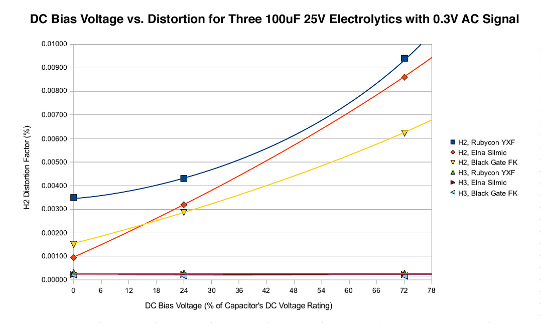

I have built three of the four boards that I have received. All use the 2200uF/16V rail
cap's, and the stock Wima 2.2uF at C1. The first two use unmatched MOSFETs, the
third, and eventually fourth, have a matched set from X, and are from the second
group buy.
The first uses 100uF/25V Silmics/Wima 1uF at C2. (I used the 25V Silmics because I already had them on hand.) Bias is 57.5/59 mA using 33R at R4.
The second one is completely stock (except for the rail cap's). Bias is 58/59 mA using
47R at R4 (33R produced only 49 mA).
The third uses OSCON 1000uF/16V at C2, with Wima 6.8uF as bypass. Bias on this one
is 58/58mA with 33R at R4 (can you tell that it uses the matched MOSFETs?)
I've also tried the Nichi UKA 47uF/Wima 1uF combo as well.
I don't have any good low impedance 'phones, using only my HD800's. I may pick up
a pair of the Massdrop Fostex Th-X00's, which have an impedance of 25 ohms, to try.
So far, my preference at C2 are the Silmics. To me, the sound is more involved with better spatial imaging, and not quite as aggressive as the OSCONs.
I still stand by my earlier observation that this amp scales quite well with better
'phones/sources. It's just a matter of futzing with cap's and bias to match your 'phones.
