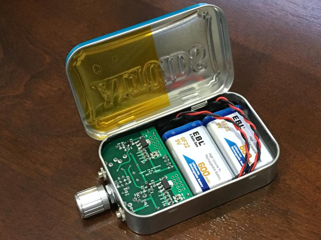

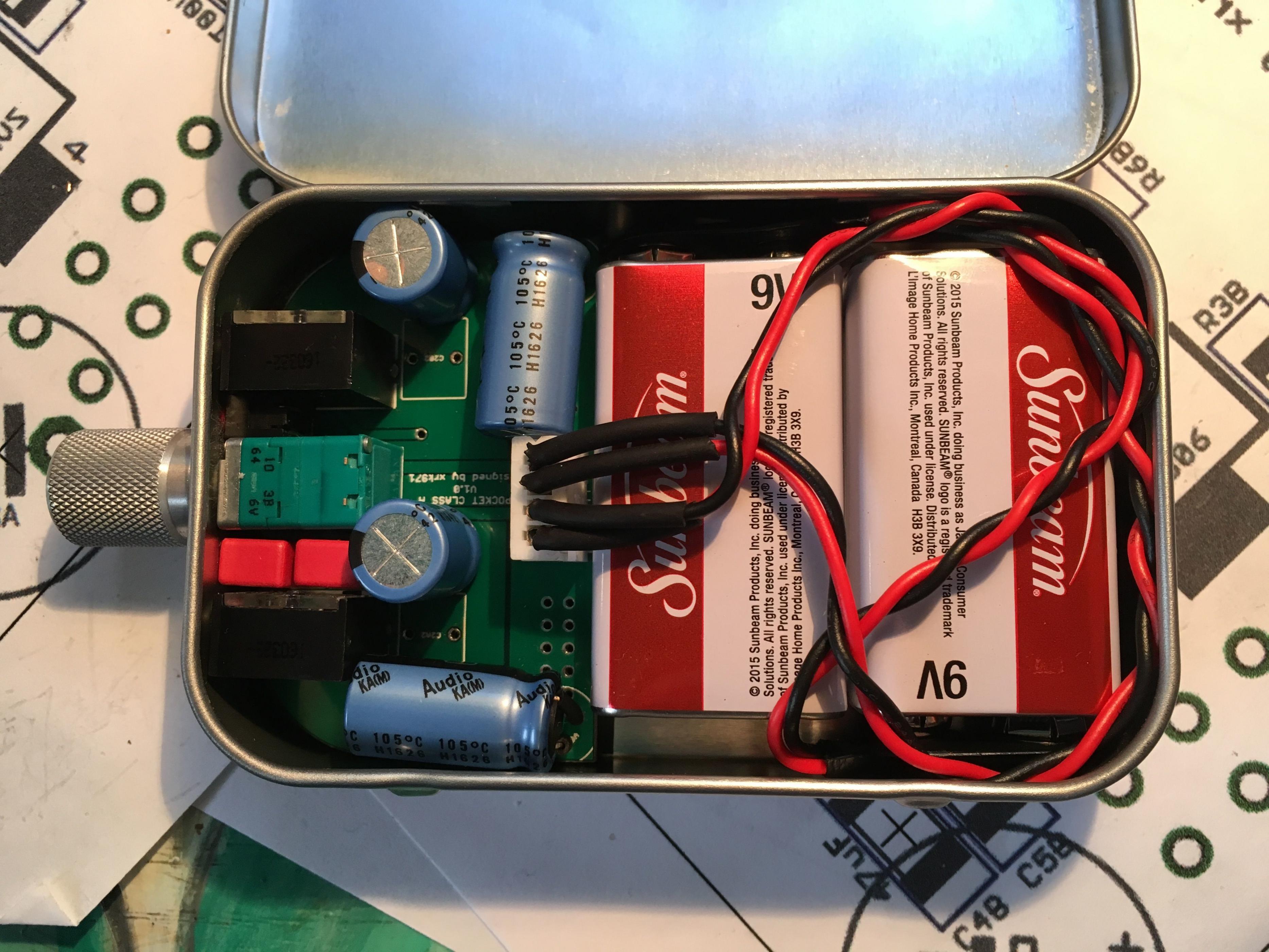

I've been rocking mine in the tin for several days now. Love the sound!

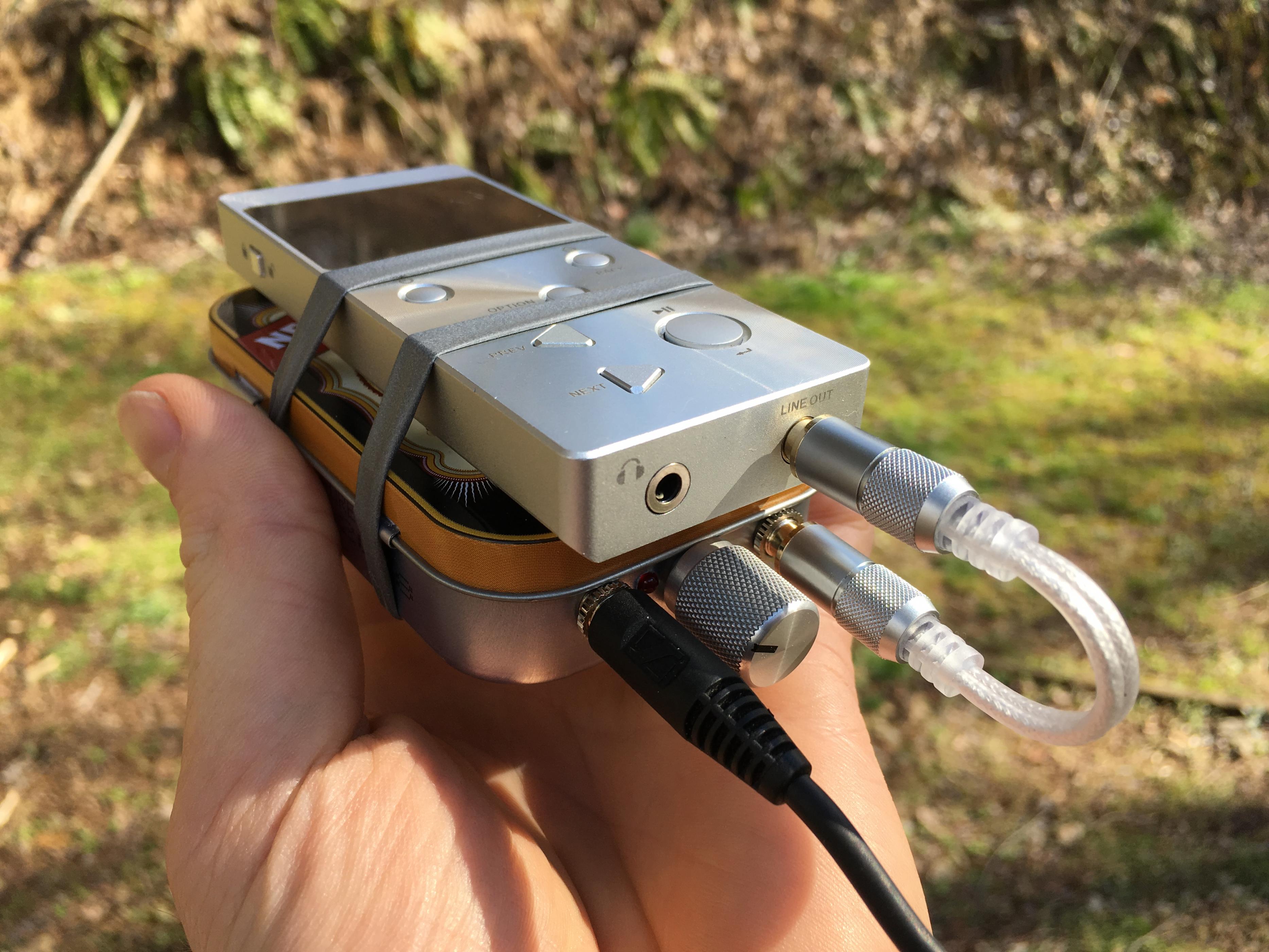

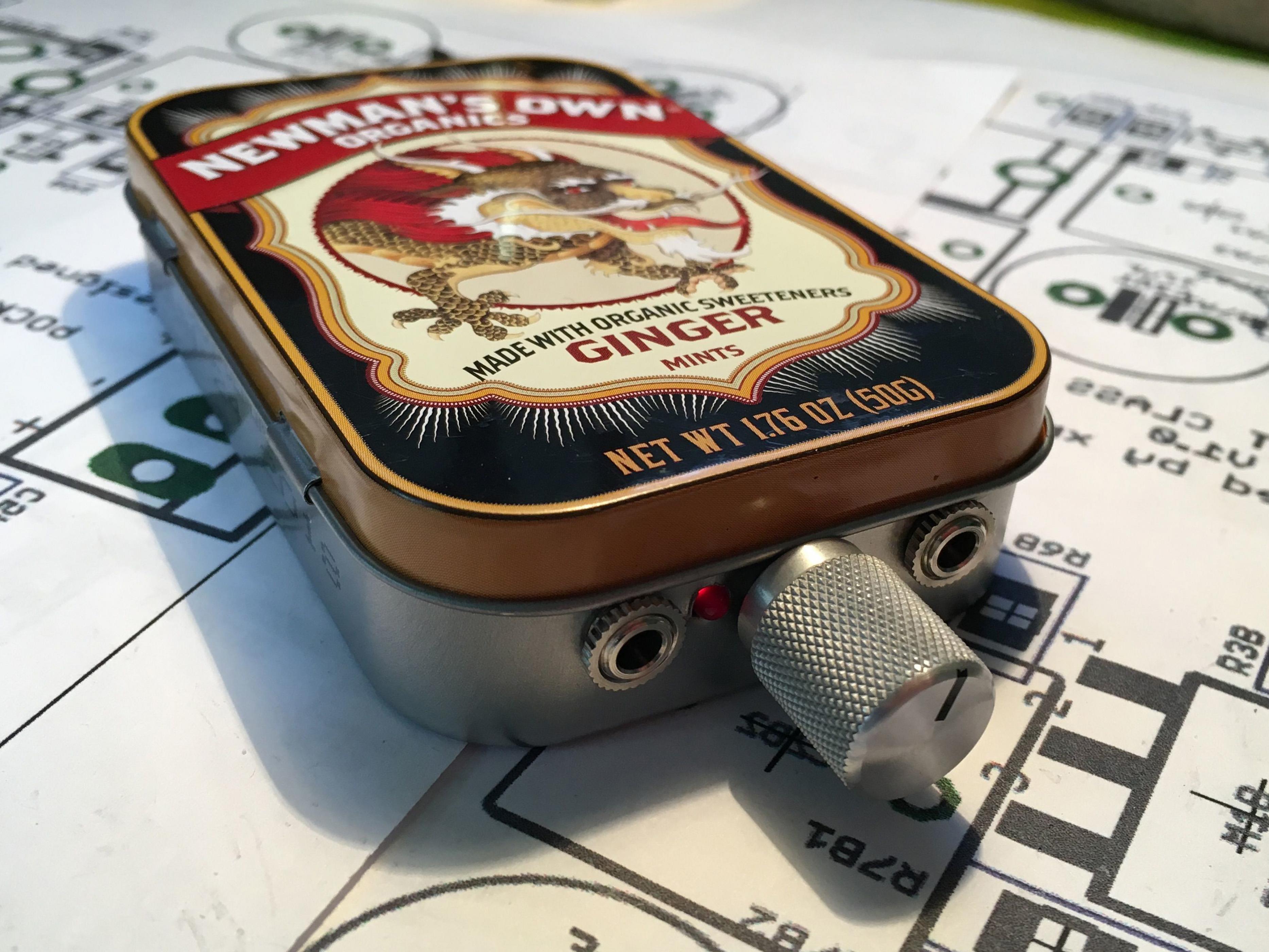

Last pic shows my new portable stack. I mounted my board upside down in the tin so that the input jack would align with the line out jack of my DAP.
I'm expecting some much nicer 9V batteries in the mail any day now. They will charge via micro USB through holes in the side of the tin. I'll post more pics when I do that upgrade.
Right now I'm running mine with no bypass cap on the output. The Nichicon KA series have good treble by themselves. But I'll soon be auditioning several different bypass cap options, in search of the best synergy with my 50 ohm Sennheiser 598 cans. My impressions of different caps tried so far are here, for those interested.

Very nice job StellarE. Love that tin can design from Newman's. I have never seen that at a store.
Glad you love the sound - I sure wish more folks would share their builds here. I wonder if it is just because they haven't gotten theirs buit yet?

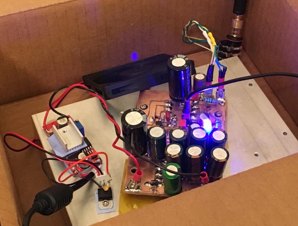

Progress on big desktop amp
I managed to make a first sound prototype of the big 4w into 50ohm Class A amp design that Hugh gave me. It's sitting in a cardboard box now awaiting a big toroidal trafo power supply. However, doing some tests with a SMPS to get some sound out. Very promising so far. A lot of heat though (notice the god size fan).
So far, I have tested it with 8 ohm full range speakers, 60 ohm cans, and 250 ohm cans. All sound great. Very powerful dynamics and bass slam. Musicality and usual SE Class A listener engagement, are excellent.
StellarE will like this: output coupler constists of 1000uF 100v Nichicon, 100uF 16v Elna Silmic II, and Wima 1uF 100v MKS. Input cap is simply 2.2uF 50v Wima MKS.
It's running a single 32v supply and output is centered at 16v so the Silmic is running right at its limit.

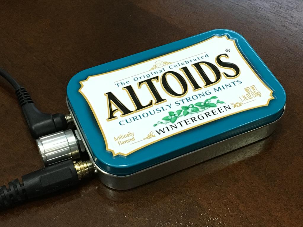

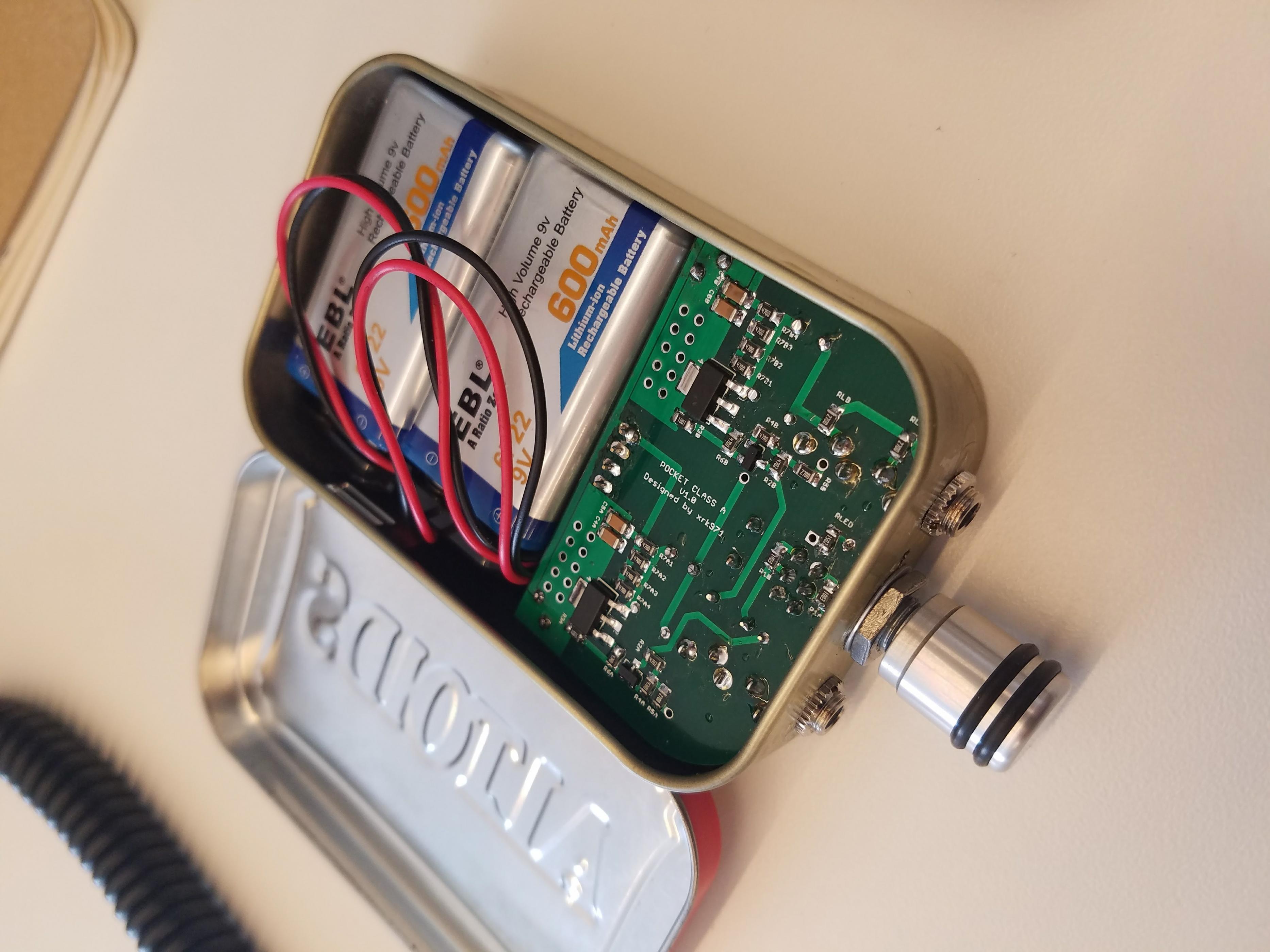

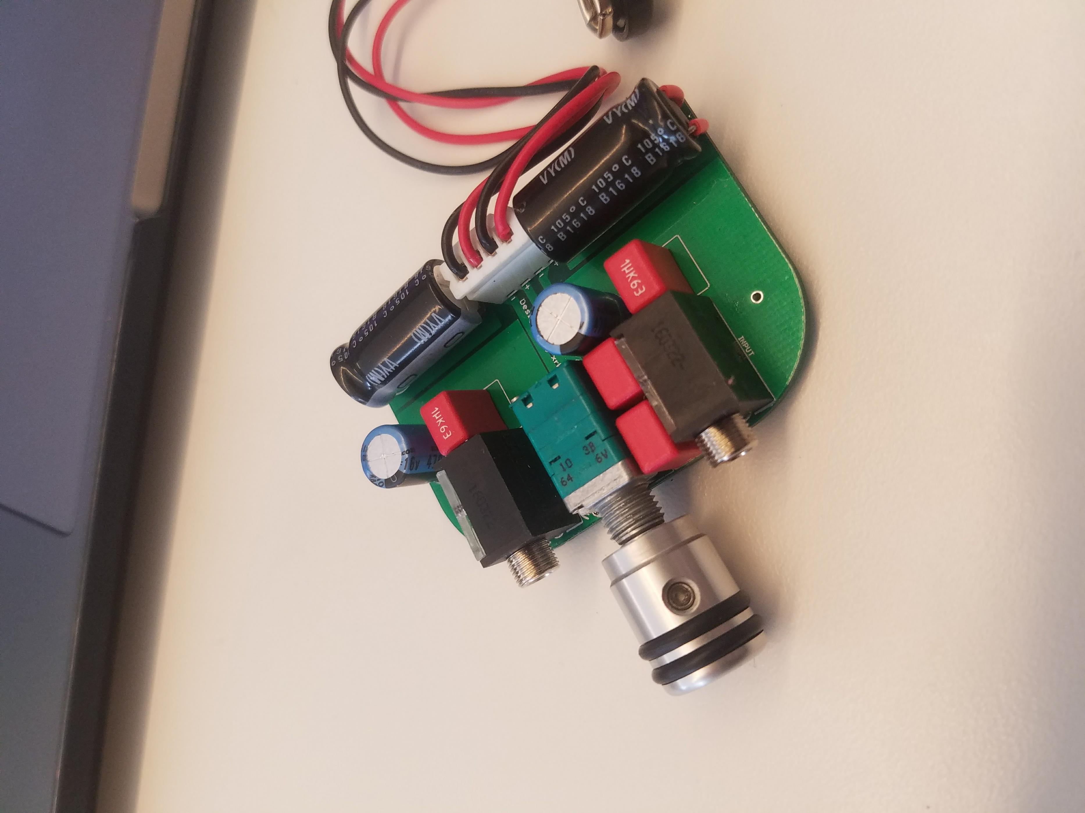

Now that I've got mine cased up, I figure its a good time to share.
First off, thanks to everyone on this thread (especially xrk971) for all of the tips and support on the build. For my first SMT, things went pretty smoothly. I used a heat gun to flow the solder paste, only took about a minute to do. I suspended the board in my third hand and heated the underside of the board to prevent disturbing the components.
At first, the amp didn't turn on, so I touched up all of the solder joints with my iron and all was good after that!
First listen on apple earbuds was pretty awesome. This is my first Class A amp, so I didn't really know what to expect. The separation is incredible!.
Now listening to Tidal through my JDSLabs ODAC and ath-m50s. I plan on trying a couple different caps and adding a power jack in the coming weeks. I have the 470uf on output right now with the stock wima's in the other positions. Any direct recommendations from anyone?
One question, I am having an issue where it only turns on about every other time I click the knob. It always comes on and works eventually. I'm not running the power LED in the circuit. Would this have anything to do with it?
This is is the turn on current surge to fill the empty rail caps and cause the battery smart protection to kick in. Turn off resets battery and cap is still partially charged, so second time always turns on. This was very disconcerting until I figured it out. If you have alkaline cells, it should not happen.
Nice build Potatowedge! Very clean solder joints via hot air! You pretty much have the best combo of caps IMO. I tried the Silmics and was not impressed - especially since it was 100uF max.
