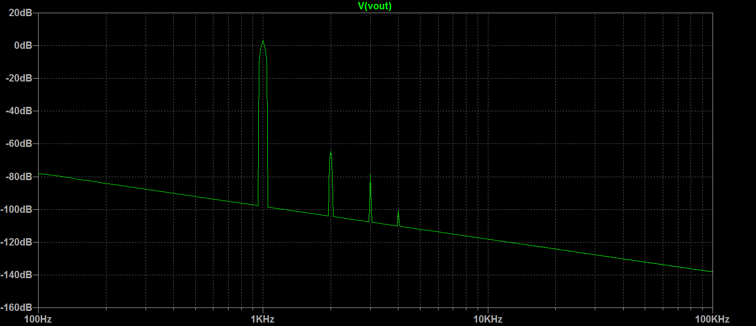

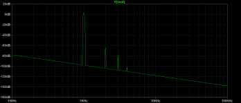

However, I have embarked on the next super desktop amp with 4w of output capability into 50ohm cans and can drive 8ohm speakers to 10w even. Still SE Class A with CFP topology. Hugh Dean has been a very generous and super helpful in providing me a wonderful amp design to go with here. Initial sims are very encouraging - predicted FFT for 320mW into 50ohms (4v p-p) is 0.04%THD with a harminic profile similar to this pocket amp.
Anyhow, themany negative trafeoffs is sort of not inspiring me to pursue this.
