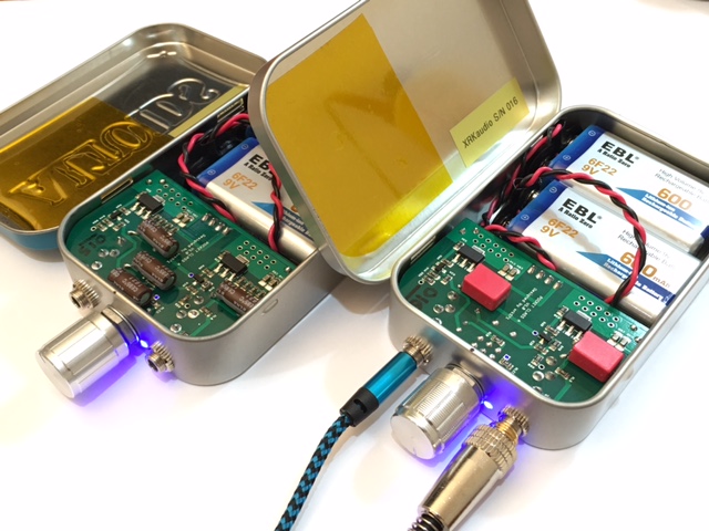

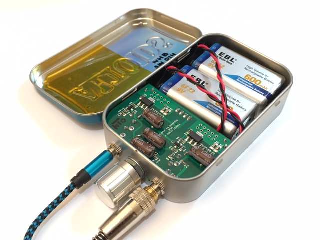

Here is my latest unit designed to drive a 13.8ohm load with 115dB sensitivity (Andromeda's). With two 1000uF Oscons and a 10uF Silmic II on output and 10uF Silmic and 2.2uF Wima on input. With LTSpice sim I get 0.05% THD at 106dB SPL with 96% being H2 and balance just H3 and. Ofhing else. Frequency response is flat to 15Hz at -0.5dB. This unit is going out to Poland tomorrow after a 4hr burn in. The sound is perhaps the deepest bass impact Inhave heard on my 55ohm OB-1's. Actual test at 270ohm load and 700mV (about same drive level as 106dB on Andromeda's) measured only 0.02% THD and all H2, H3 almost non existent (-90dB).

A couple more amps going out the door this week. An NHB with dual 1000uF OSCONs and 10uF Silmic on output, and another with dual 390uF OSCONs and 1uF Wima with only a single 10uF Silmic on input (nonfilm cap bypass). They both sound wonderful. The dual 390uF OSCON has very low ESR for incredibly tight bass.

Just started board #2. Thus begins my adventure with the MicroMELF resistors. It'll be a miracle if I finish without dropping any and having them roll away forever. That said, I'm finding that they're actually very easy to solder. They're so small that there is a lot of extra room on the pads under the terminals.
For this build I'm going to substitute 51K (maybe 56K) for R4 to boost bias a little. I considered going higher but I would like to get at least 1.5 hours out of my OKCell USB batteries.
I soldered in 1K for RL this time around. It should load the output a smidgen more, and with the parallel load of my 50 ohm cans, I'll net 47R vs 42 with stock RL value.
Hopefully I'll finish tomorrow!

Good catch, X. 51R and 56R are what I bought.
They are all .2W Vishay MELF. I guess these "pro" ones aren't the exact "micro" line but same size. They are 1.1.x2.2mm SMT resistors that look like little perfect cylinders. I probably fell prey to the "boutique" hype. IFi Audio brags about using them in their flagship amps. Gave me the idea.
0.2W rating is helpful for use at 470R R7 resistor array so that lets power dissipation go up to 800mW vs 500mW before. But a little known trick with flat SMT resistors is that you can stack two in top of each other in parallel easily. Could probably stack qnty 8 x 1k's to get 1000mW rating.
It would be jolly cool (pun intended) if that did work. Alas, the ratings for SMT resistors are for in free air at a particular ambient temperature. For a resistor sandwiched between other hot and sweaty bedfellows you'd need to apply fairly severe derating to the published dissipation figures.
No free lunches. I am just talking about double stack so no sandwiches here 🙂 but yeah, 1w is too optimistic I am sure. Clamping the resistors against silicone heat sink and proper sink works well.
