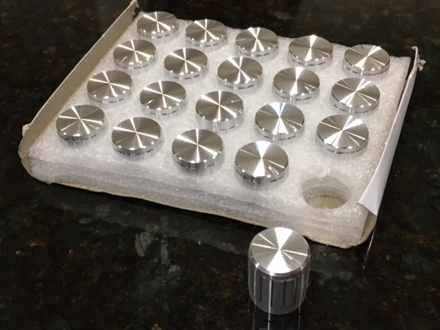

Btw, check out these fine looking nicely machined aluminum volume knobs that arrived from Aliexpress 🙂

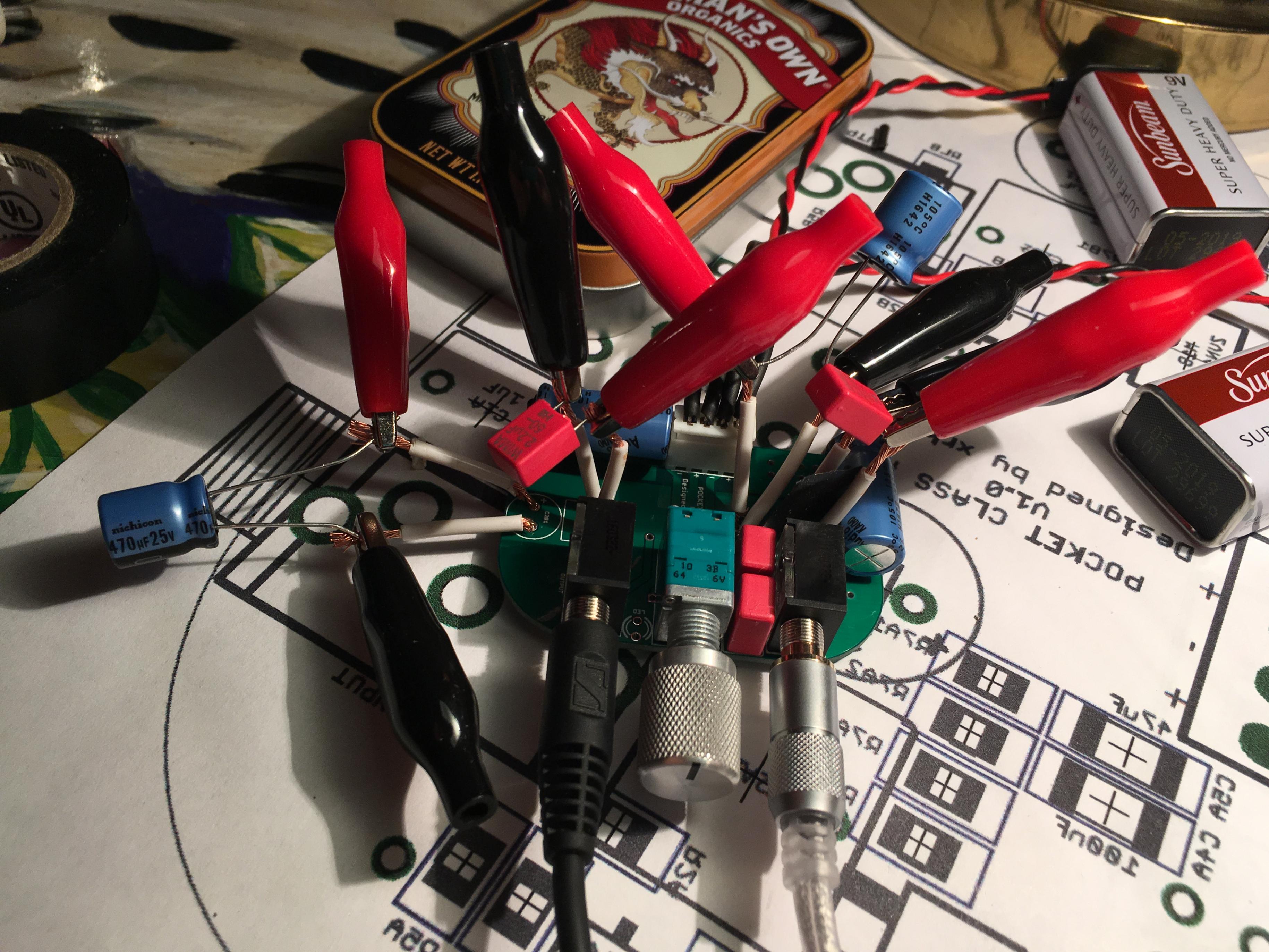

I think I'll use one of these for C3. I think they're the best compromise between higher
capacitance and cap quality. To mount these, I will probably have to come in from the
top with the battery clip wires. I'm not using the quick-connector. Don't see the need.

OMG I realize this looks like Frankenstein's monster, but this amp is blowing me away with this cap combo. Listening to Stevie Wonder's Talking Book (24/196 HDTracks remaster). It's the best I've ever heard it. So warm and sweet. Vocals are like reaching out at me...bass is sumptuous. Nichicon AKs have much more detail and transparency than OSCONs. I think the WIMA bypass is subtle but does add a little smoothness and high end extension. Currently using 470uF Nichicons and the 2.2uF WIMAs, driving my 50 ohm Senn 598 cans. X, you're the man! 😀

Wow! Nice detective work. I will have to try those Nichicon AK's. Can you get me link to exact one you are using? Big question is can it fit where current 390uF OSCON goes? All this great sound and still on DollarStore "Sunbeam" carbon-zinc 9v cells 🙂

https://www.digikey.com/product-detail/en/nichicon/UKA1E471MPD/493-15331-ND/4992606
10x12.5mm. It fits sideways. I don't know yet if it'll fit upright, but it'll be a squeeze if so. I didn't see these before when I ordered but there is a 16V version. I don't know if it would sound exactly identical but it is still 470uF and 8x11.5 mm and that would fit upright.
http://www.mouser.com/ds/2/293/e-uka-884128.pdf
I might have to order some and see. I am also considering buying some slightly larger WIMAs and trying to squeeze those in there too to see what happens.
X, I think you are going to like the sound of the AK series in this amp. They are touted by Nichicon as the same "high quality audio" as their gold caps, but smaller size and higher temperature rating.
Ok, I will order some of the smaller ones that can drop right in. These cost less too. But cap sound really is a personal preference so we will see...
