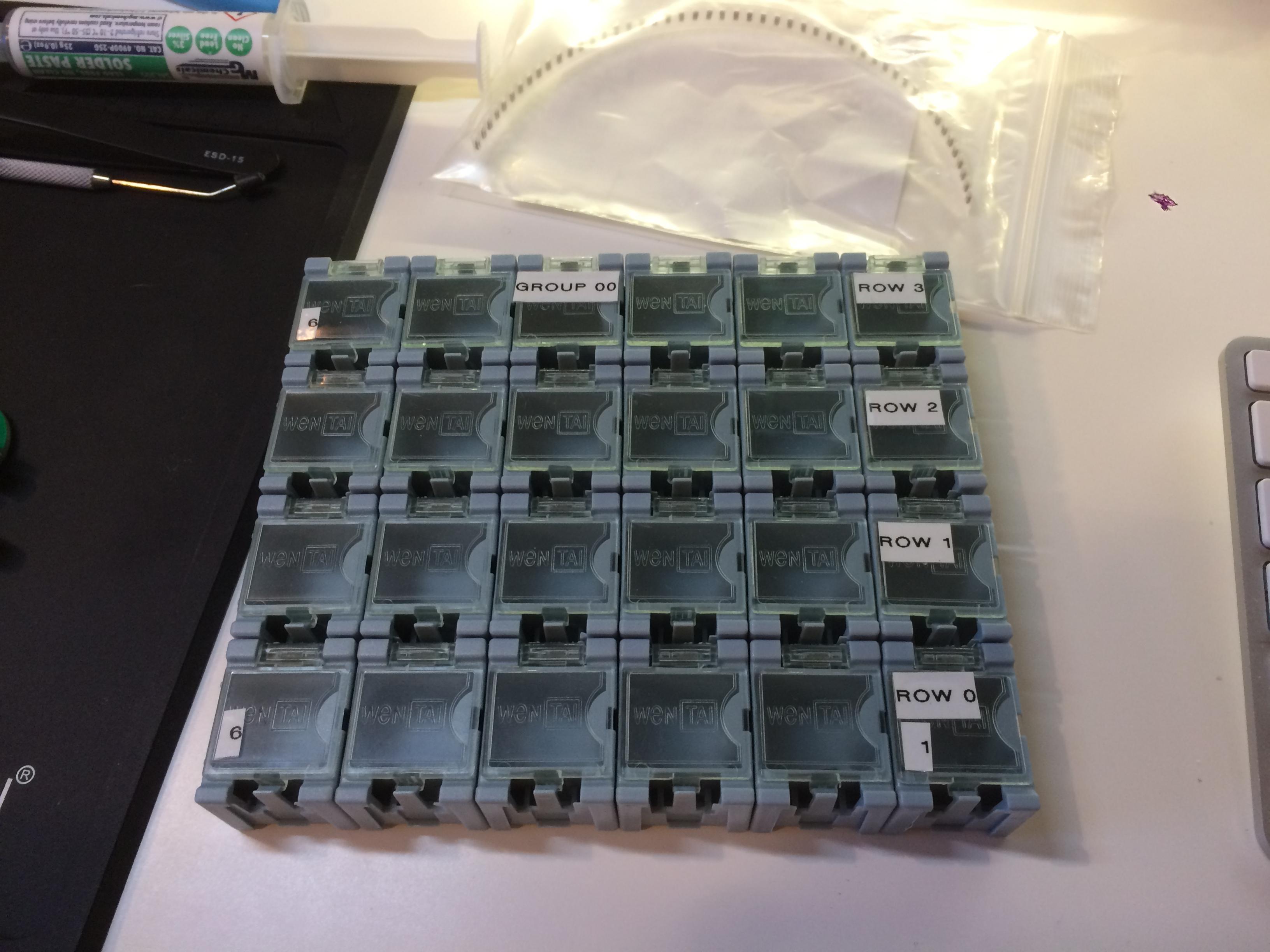

When I measured the first few batches of jfets I put them into these smd storage bins:
http://a.co/1wy30mZ
I bought 4 of those bins, labeled them, then as I measured (IDSS) I could record the measurement and toss each one into it's own bin. I'll consolidate groups of similar IDSS as a starting point to match them where needed.
I figure I can use the bins to stash smd components in my akro-mills bin drawer organizer things as well. Really handy how you can attach these little bins to eachother.

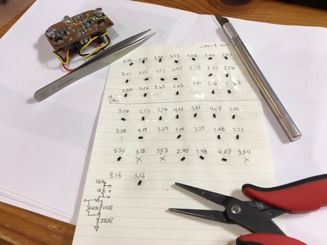

That does look very handy - I may have to get some. Here is my method, it's cheap and very easy to see what values I need to match. I tape down the parts once labeled. Then when I find two that I need, I use an xacto to cut a slit in the tape and pull it out with tweezers. I always wear ESD wriststrap.

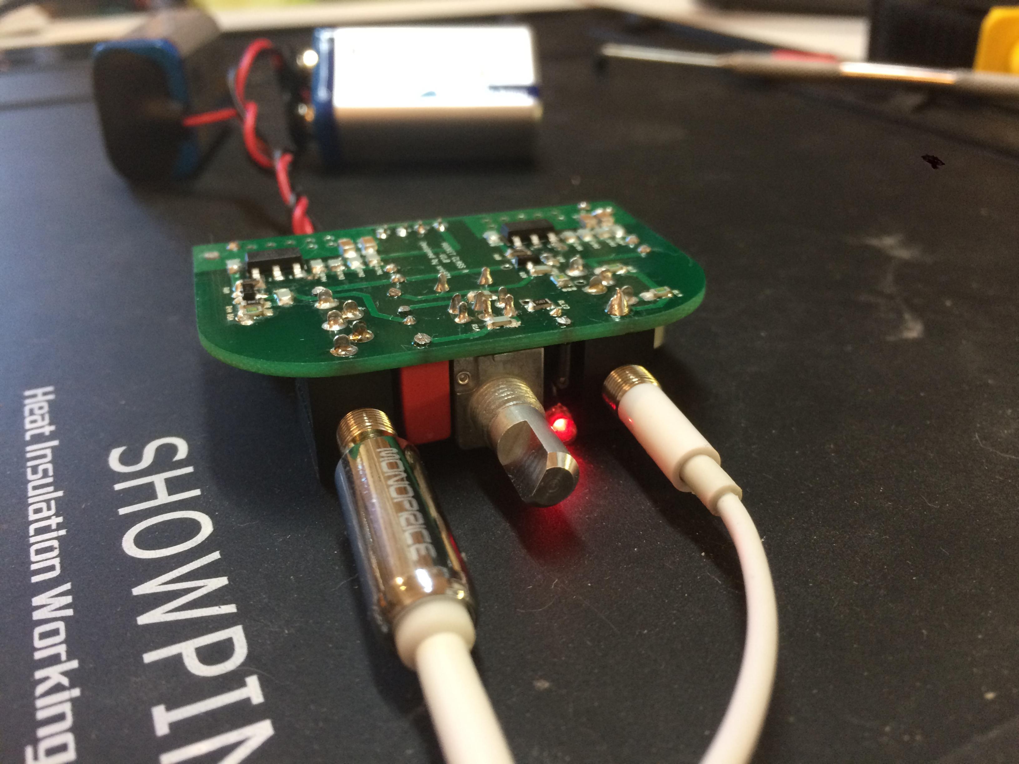

i just finished soldering my first board and i have a problem: the right channel volume is very very low (left side seems normal and sounds good). also, the transistors on the right side of the board ("B" side) get very hot. any hints on what to check first? thanks!
Sorry to hear about the problems. We should be able to fix this.
Can you take a DVM and measure voltages at gate of mosfet and source of mosfet (output DC level). That voltage divided by R7 equivalent of 117.5R is the bias current. Should be in 50mA range. Also what is current going through the R3 1k resistor feeding the JFET? Measure on good side and bad side and compare. But please show us what you get. Wear antistatic ground strap when doing measurements probing around.
Are you sure your resistor values around the JFET (R2/R3/R4/R5) are correct? Make sure R1 is 100k and not some really low value. Look for solder bridges and shorts. If transistors are hot that may be normal as this is class A (but left should be pretty hot too).
A high resolution closeup photo of both sides would be very helpful. Make sure I can read resistor values.

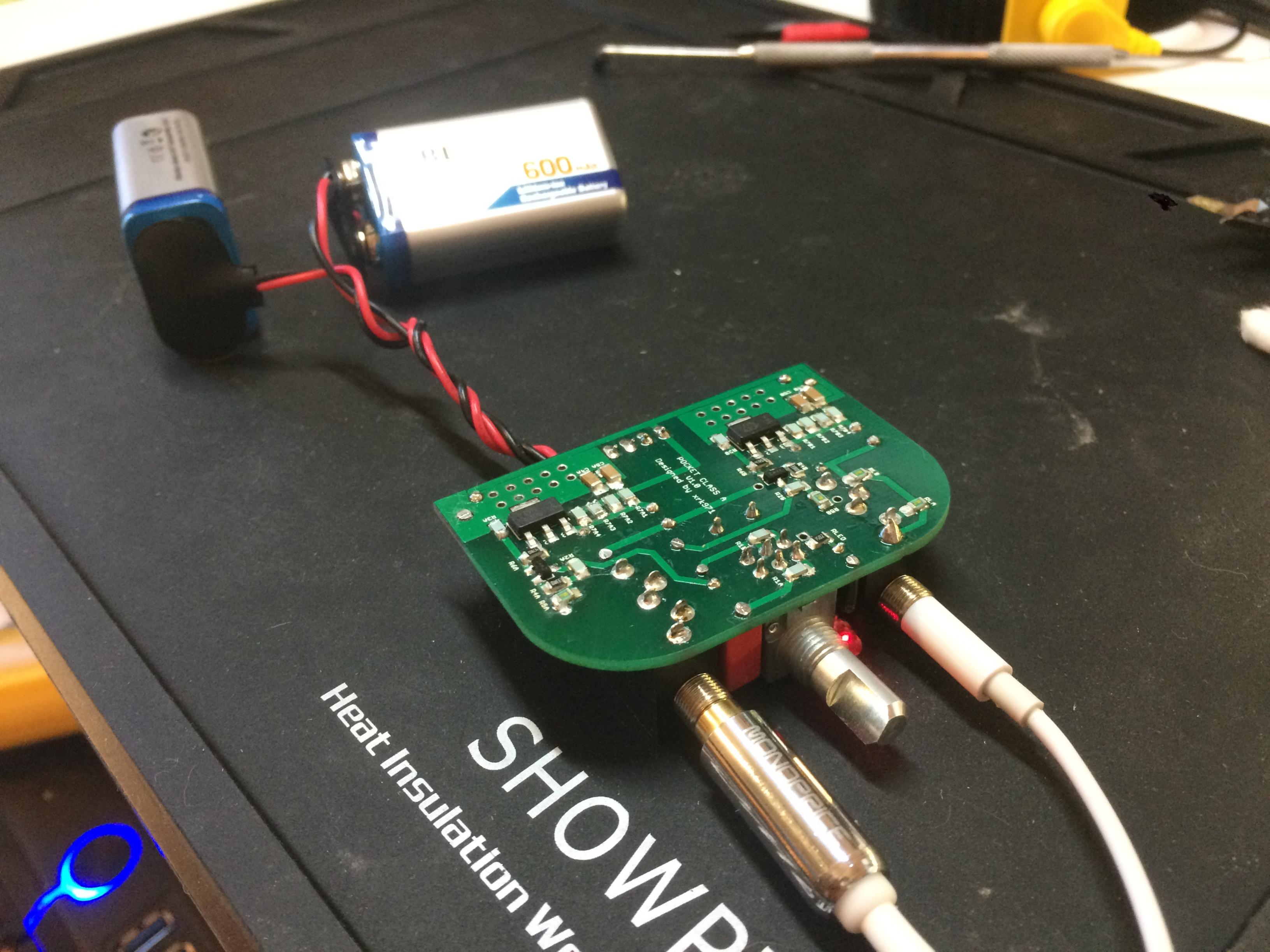

Finished mine this morning, listening to it on the bench now.
R7A - 7.05v / 117.5R = .06, so ~60mA
R7B - 7.09v / 117.5R = .063, so also ~60mA
I haven't plugged in my DT770 PRO 250's yet, but I'm planning to listen on them later this evening.
Setup is MacBook Pro Retina, Tidal -> optical out -> SMSL SD-793ii DAC -> X's HA

no need to be sorry, it's just my lack of soldering skills. to answer your questions, i'm pretty sure about the resistor values, because i compared the codes with the pictures you posted. i was concerned about R7 because your code is 471 and mine is 4700 but i checked and both codes mean 470Ω.
R1 is 100k (code 1003).
mosfet voltage left side = ~7.2V, right side = ~0.27V, so i guess thats the issue. i did do a lousy job with the right mosfet, i'm going to remove it and try again.
voltage across R3: left side = ~6.76V, right side = ~8,3V
thanks for your help!
A couple pics.
It sounds fantastic, even through apple crap ear buds.
Damn fine job X!!
Nicely built !!
Perfectly matched FETs for channel balance.
