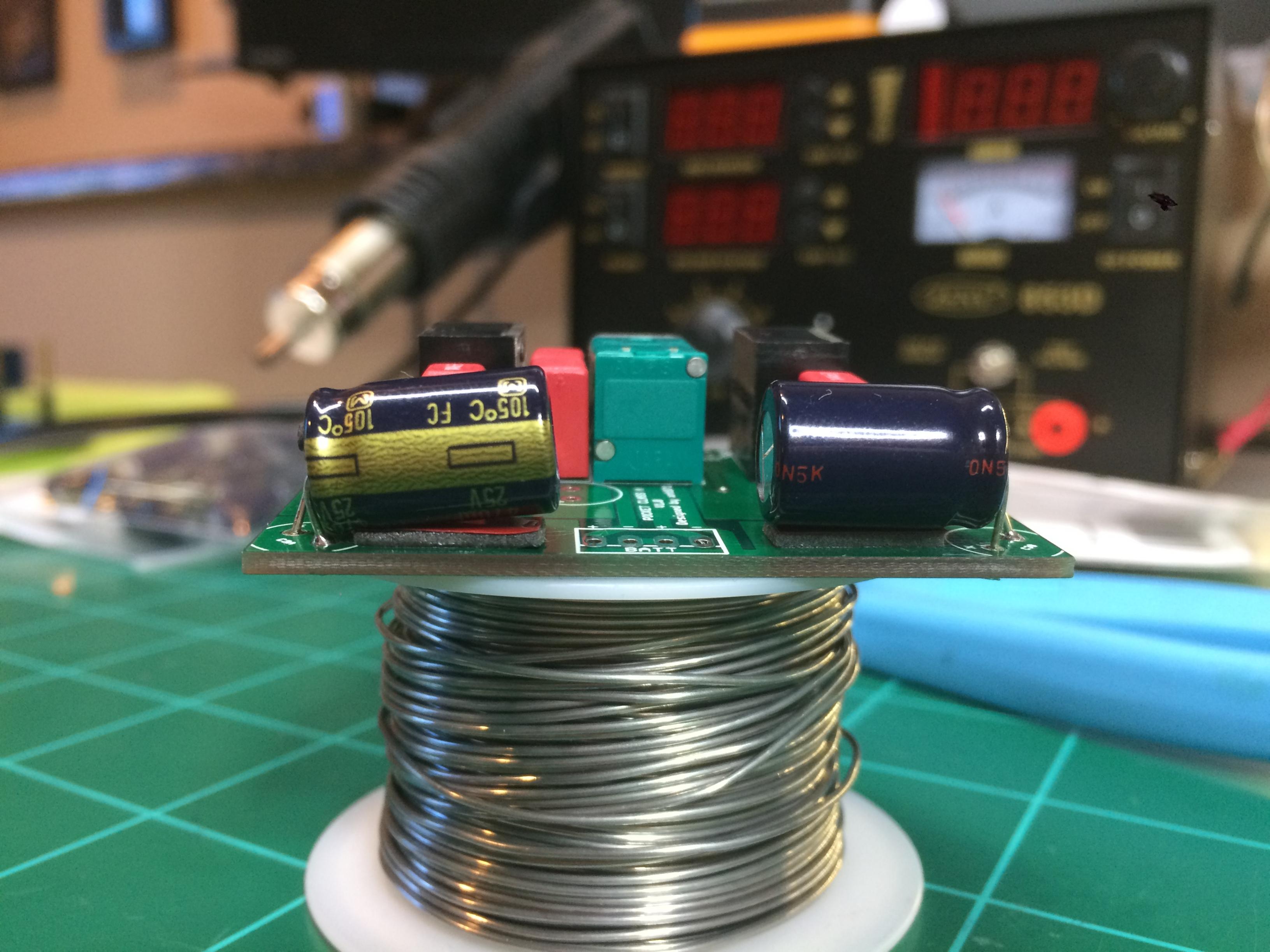

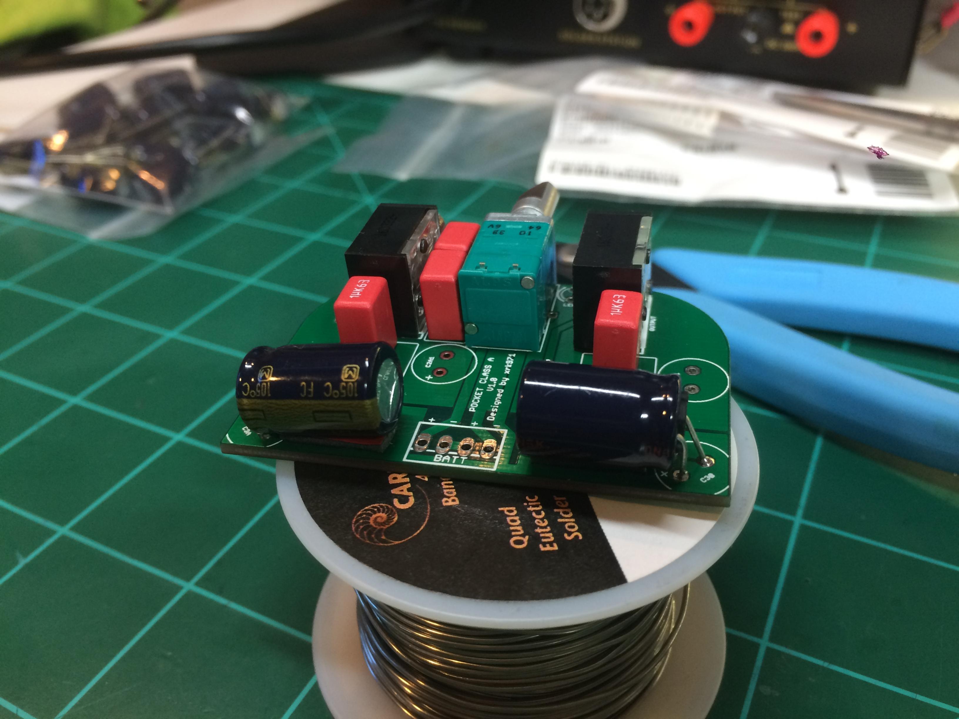

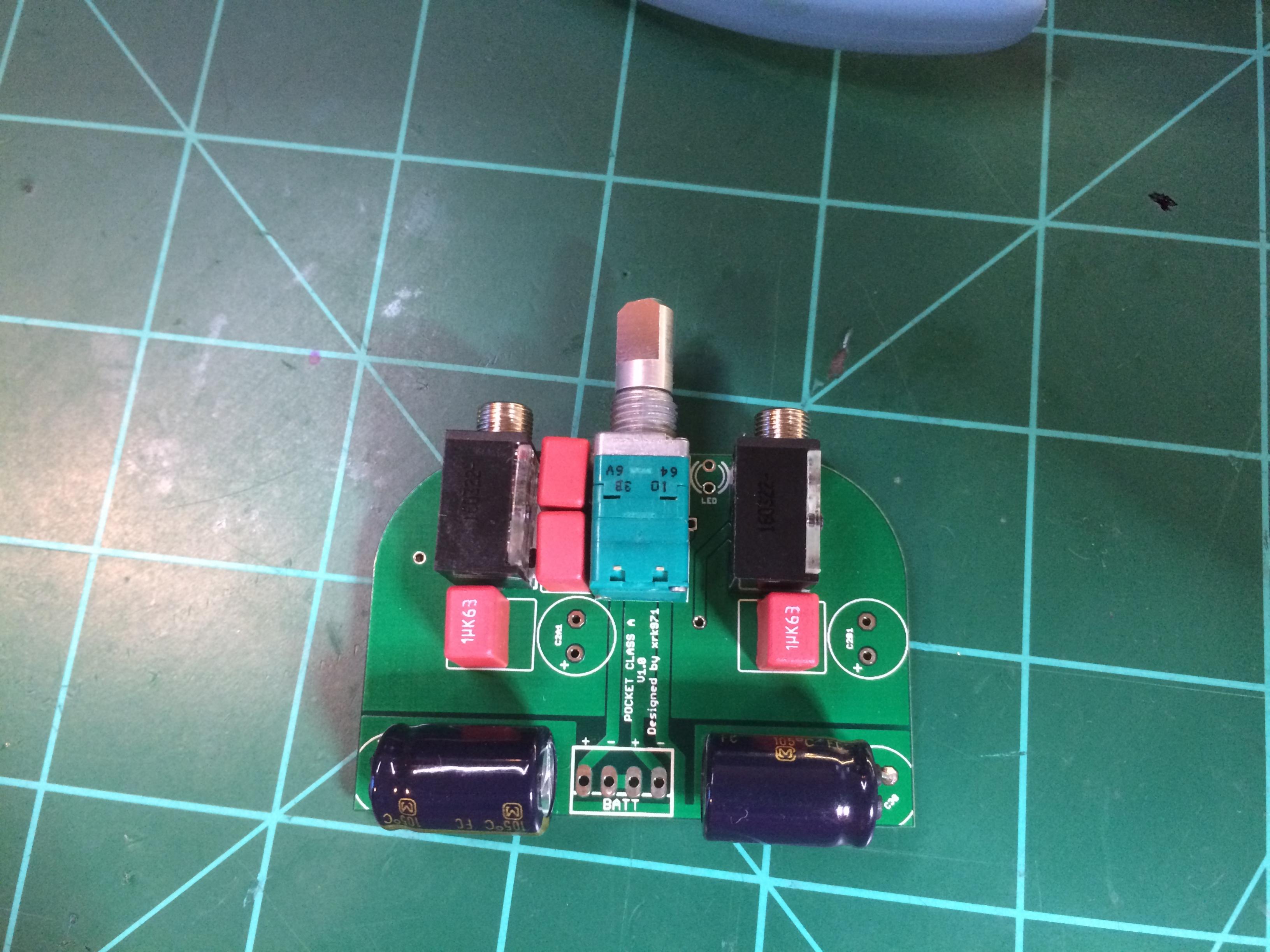

I found a stash of 25v/470uF Panasonic FCs and got them to fit, a small piece of 3m extreme mounting tape under them to lift them off the board a bit.
Nice work Pcgab! I had a good hunch about your progress. 🙂
The 470uF is nice but 2200uF really helps to increase stereo separation and reduce turn off thump to almost inaudible. Sadly you have to use 16v rated ones to do this. It's not a big risk with Li-ion batteries as they are 16.4v. Although it's on already so go with t and if you need to upgrade later.
Good luck matching MOSFETs. It's easy actually with the real deal jig. 🙂
Nice looking build btw, can we peek at the Class A business side?
I think the batteries I got are li-ion as well. Maybe I'll order some 16v 2200uF caps.
I have some bigger value 25v caps, but they're pretty darn big. I would have to notch the tin to make room for them, and that might not even work!
I found some 2200uF 25v Nichicon's in my stash, but I don't think I can make them fit.
Of course!
Missing a few components in this pic, and clearly I need to do some cleanup. I think there may be a resistor or two with a small bridge, I'll check those out again before power up.
I bought a hot air re-work station and am enjoying using it. There was no way I could solder these with just an iron.
