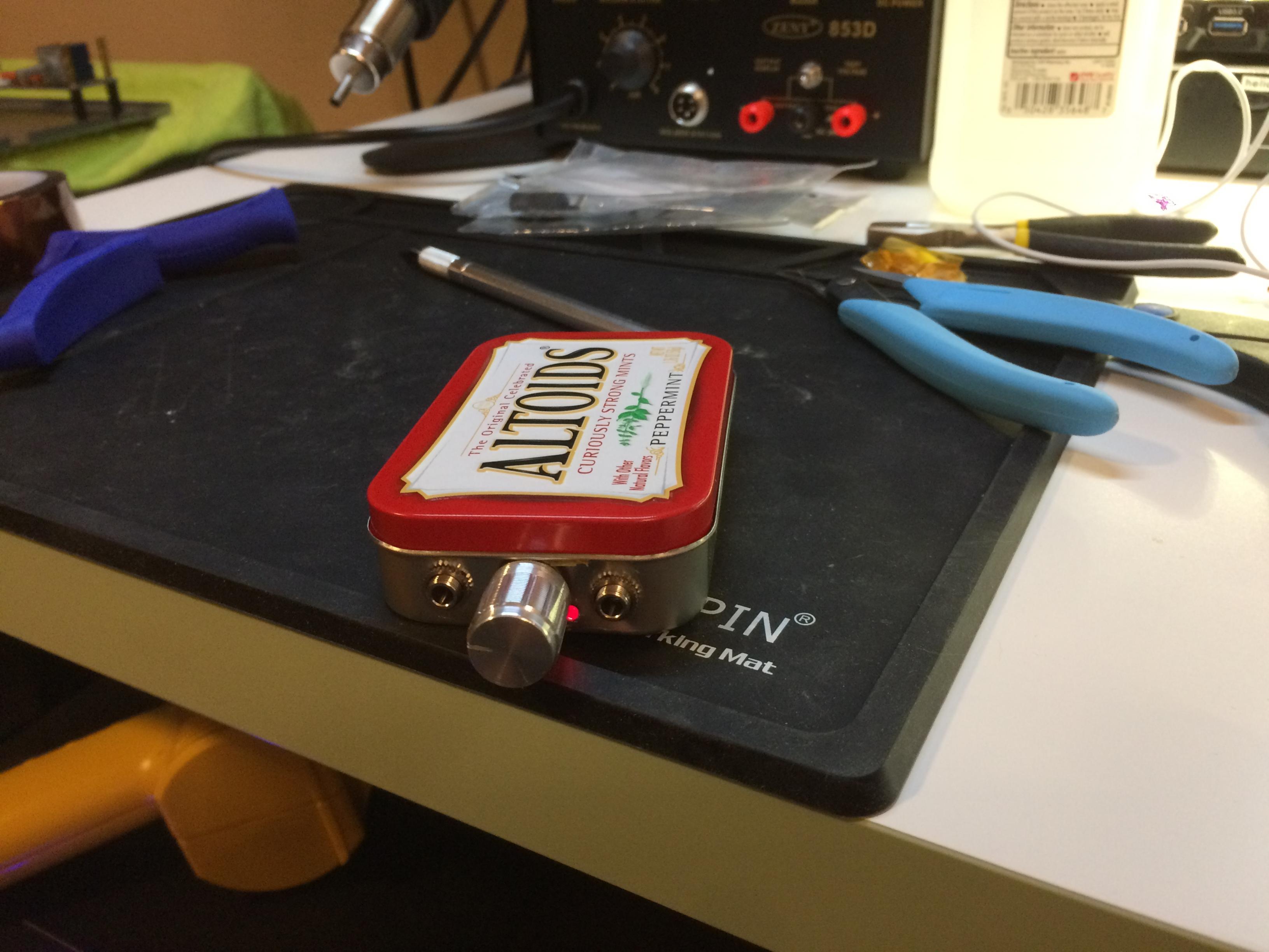

I have sound! My Sennheiser 598s are singing. First impression listening to "Send it On" from Voodoo by D'Angelo: the bass is awesome!
I can't wait to have a long listening session to get acquainted with the sound.

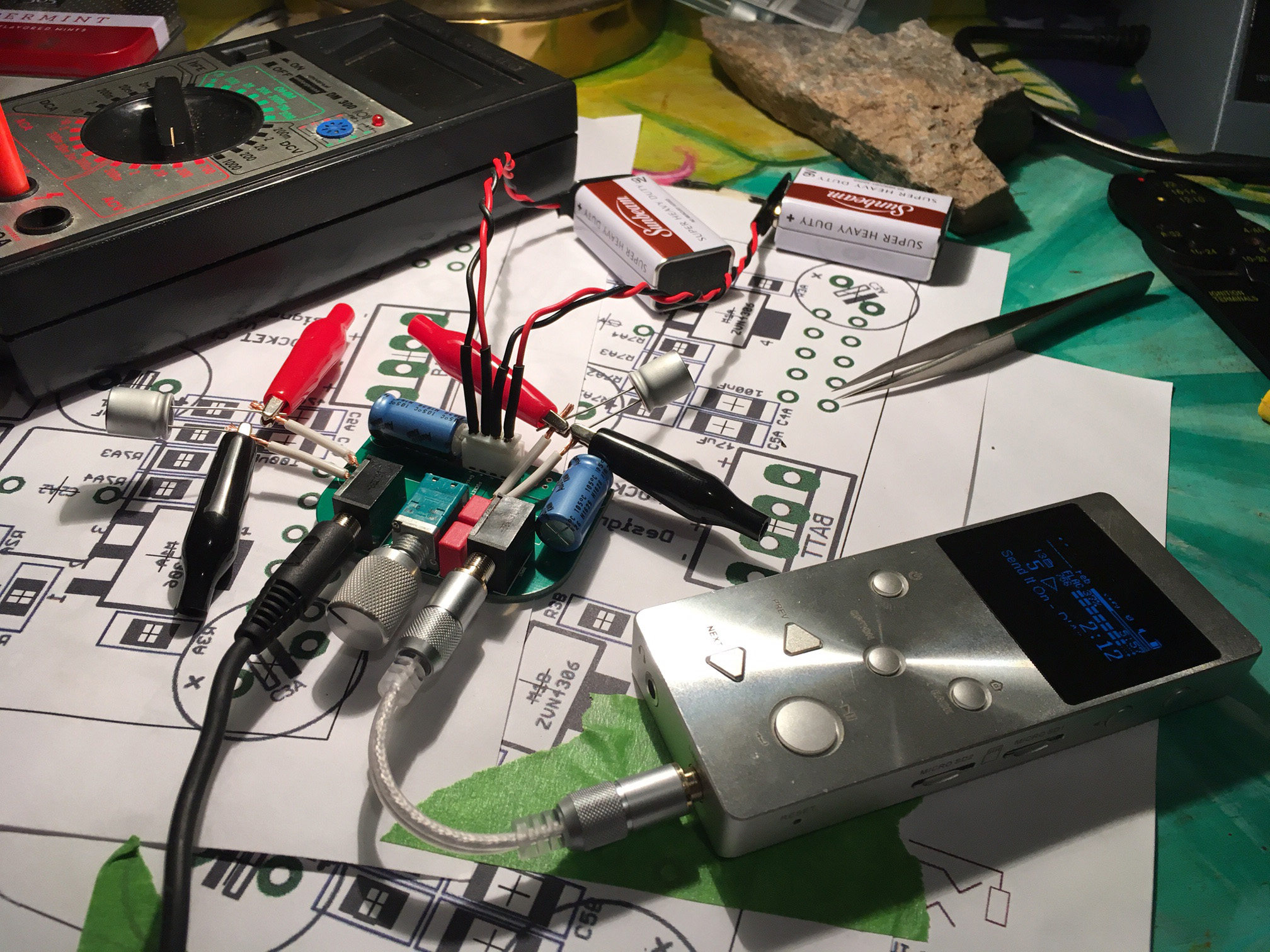

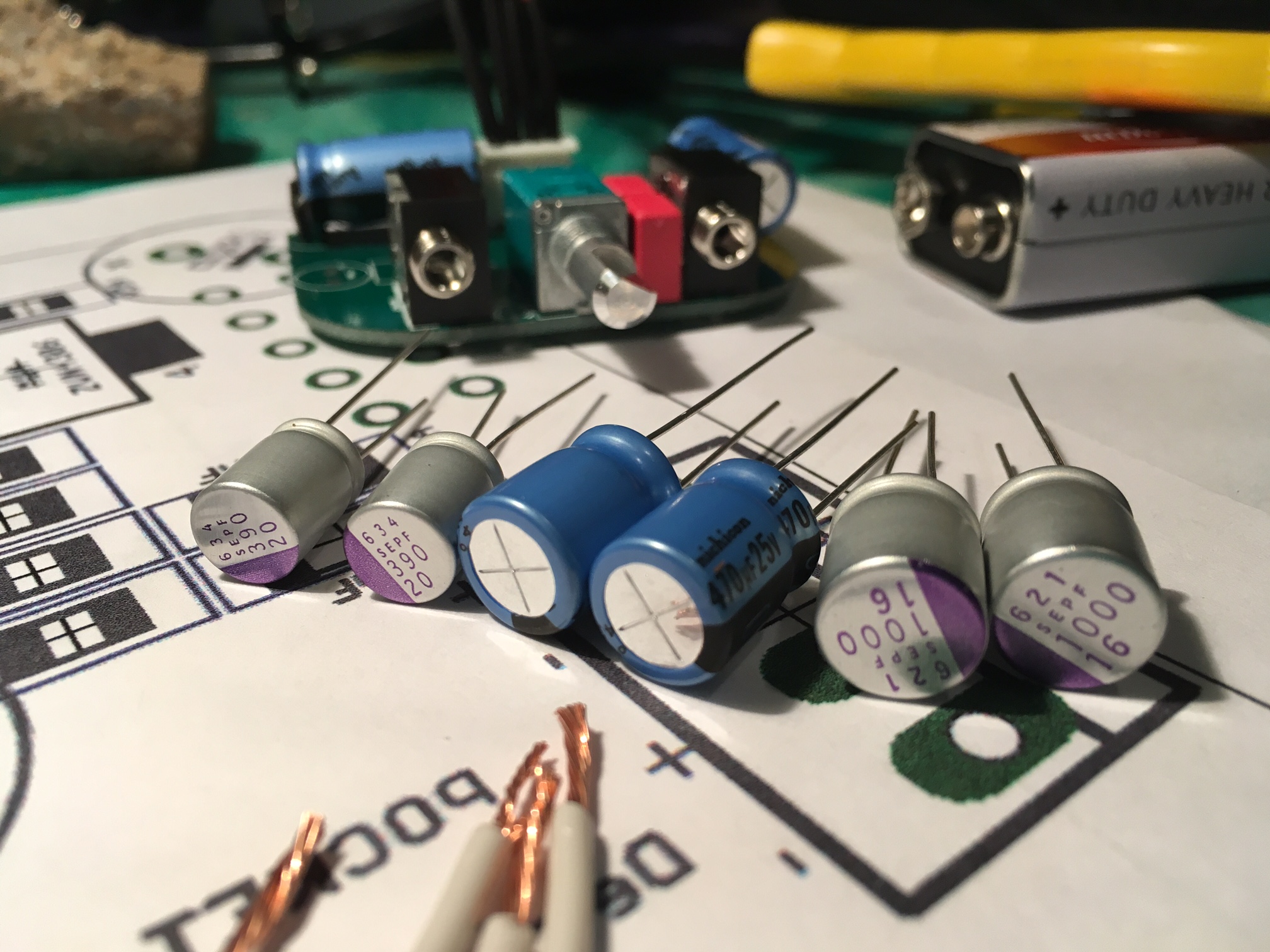

I've set up a quick and dirty way to compare the sound of different output caps using gator clips attached to wires temporarily soldered to the board...against X's cautions that it would sound crappy...😱 So far I am just listening with 1000uF OSCONs, with no bypass yet, and I'm already pleased!
I have the original 390uF OSCONs plus some 470uF Nichicon AKs I will be comparing with the caps I have clipped in there now.
This is my first amp build and my first SMT soldering job...I took my time and it works perfectly. Big thanks to X and BDHM! Now I'm going to go revel a bit. 😀

Congratulations man, you did a fine job. It's wonderful to have first sound the first time!
Your cap comparo looks interesting, you could probably make an entire thread about it🙂
I suspect you will not hear an audible difference with or without the Wima's. I do think that if you have lower impedance cans, the 1000uF OSCON will be audibly deeper bass.
Happy listening - another happy builder with great sound.

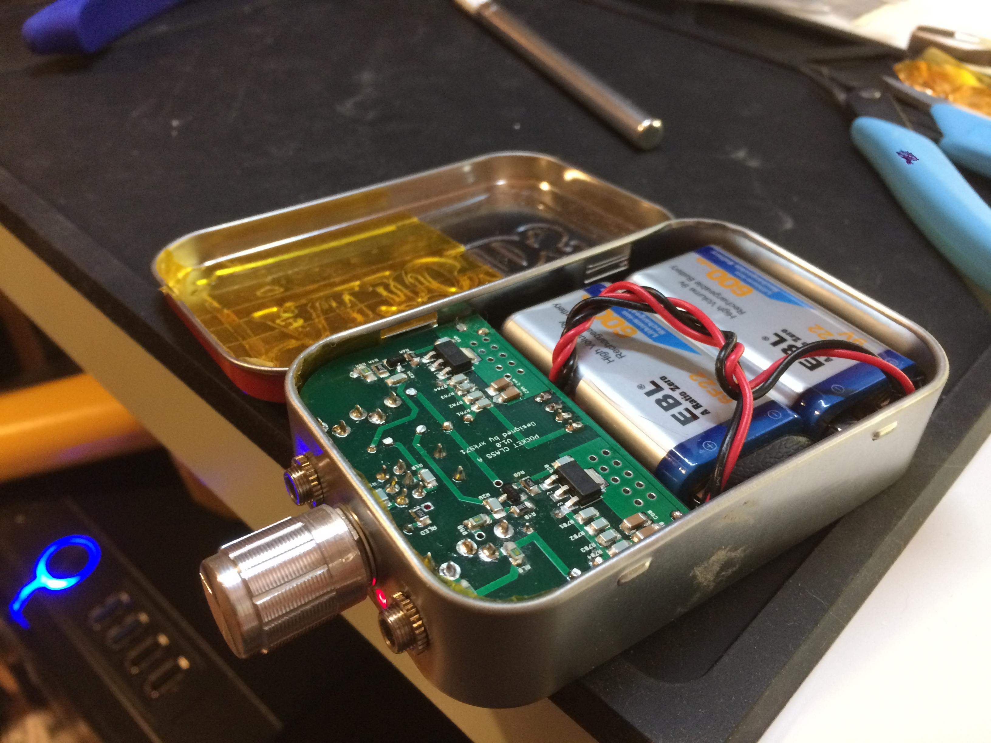

X - I'm @~3hrs so far today on freshly charged li-ions, still going strong so far. I'll report once it runs them down.
Listening to some of the 'master' albums on Tidal from my MacBookPro today, really enjoying this little amp.
The funny thing with these rechargeable Li-ion 9v batteries from EBL is they have a smart integrated power management circuit inside. It just cuts off when too low - so no warning. Just goes kaput like the amp died. 🙂
