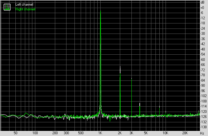

I went back and added 2200uF rail caps to my original hand made PCB prototype. Also added cheap RVT 330uF SMT caps to the audio output (has 47uF OSCONS and 0.47uF film cap) and the amp now is now one of my best measuring coming in with 94.3dB dynamic range, 0.045% THD, 0.042% IMD, -70.8dB stereo crosstalk, -126dB noise floor. Listening to it now - very very nice. Hand drawn with a Sharpie marker PCB' can work very well too.
FFT for 1kHz 700mV into 270R load:
Freq response and THD vs frequency:
