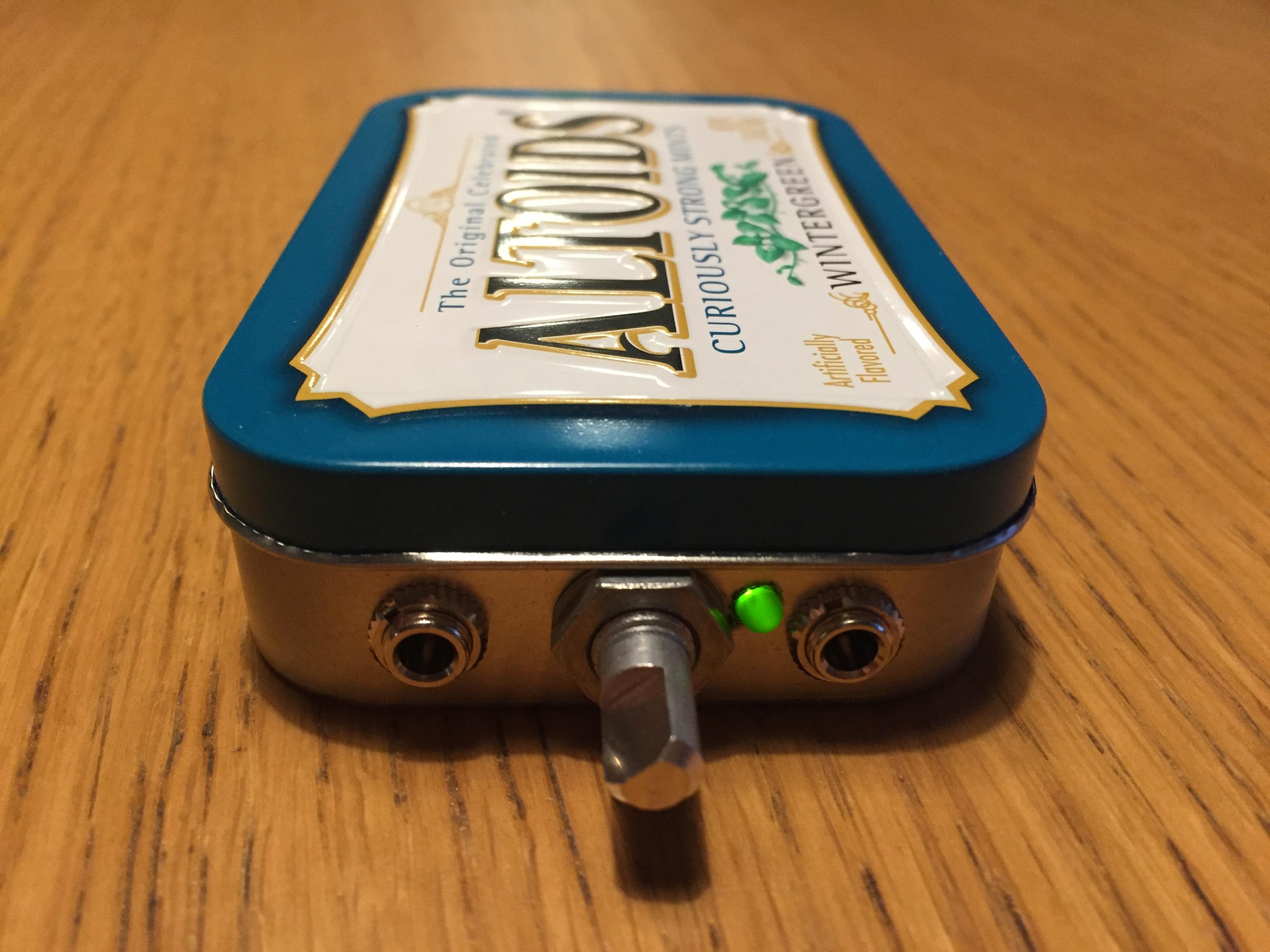

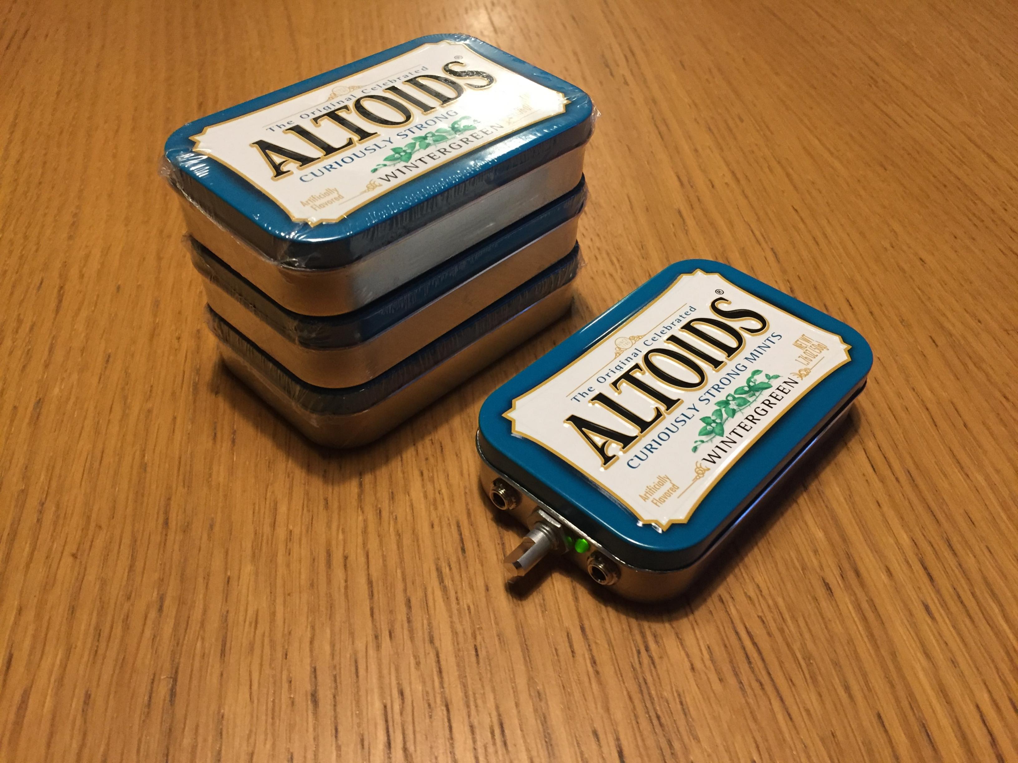

Finally got my Pocket Class A amp in the official Altoids case! It took three weeks for the mints to ship from UK to Finland. 🙄 Too bad they don't sell them in this corner of the globe, so I got me some extra too.
Nice case work there Morde! Perfect hole alignment and no scratches! 🙂 You are a pro it seems.
You just need a knob to finish it off. How do you like the portability (pocket fit and feel & hand-warmth - a bonus in Finland) and battery lifetime?
Congratulations!
Congratulations!
Yeah, I managed to get it to look better in the pics than it really is. Input hole is a little higher than the output side, also the led is not aligned straight and the the led hole ripped while drilling.
I did small pilot holes at first by using the hole guide PDF file provided in the first post and then grinded the holes larger with my cheap dremel copy.
I haven't had the time yet to test its' hand warming capabilities, but yes it could be handy here in Finland (-10 degrees Celcius this morning). I'll get to test the battery life when I get the charger delivered that was missing from the battery shipment. The mint case really fits well in my hands and no doubt the portability will be good.
