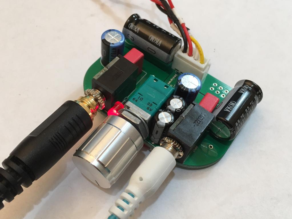

This setup looks sweet!

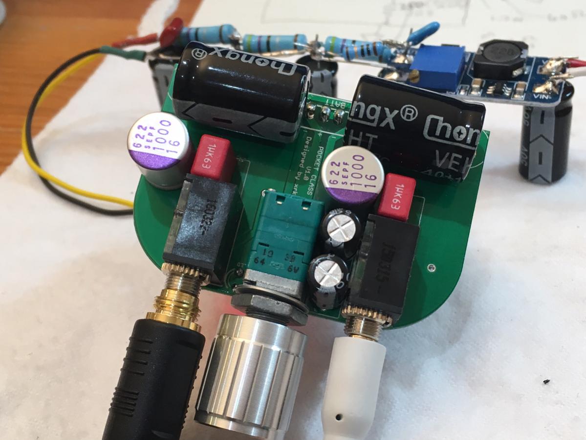

I thought the bass sounded deep, full, and effortless when I tried those 1000uF OSCONs on my board. Even my Apple earpods had awesome bass with them, like far beyond what a I thought they were even capable of. I still favor the Nichicons AKs for the extra detail they let come through. The OSCONs have the advantage of compactness though.
What benefit are you aiming to get from larger value electrolytic input caps with the tiny value bypass? Trying to learn.
I was really surprised that I was able to hear differences between caps and it has really piqued my interest in exploring the different options that could fit inside the Altoids tin. I've been trying to learn from other threads and web articles more about the different types of caps used for audio, whether to add a bypass cap and how to size those, effects on FR and impedance anomalies etc. As a newcomer it seems pretty dense, plus there are a lot of different opinions. 😱

I see. Are you using that same equation fC=1/(2πRC)? For your desktop amp, if R is 22k, and C is 4.7uF (minimum), that puts corner frequency right below 2Hz, which is perfect according to these guys. https://www.v-cap.com/coupling-capacitor-calculator.php.
Which is the local feedback resistor in the pocket version? Trying to figure out how deep the 2.2uF input cap digs.
I like the way you paralleled two caps through one hole (one on each side of the board). Did you have to drill the hole bigger in the board to squeeze another set of leads through there? Or are the bypass cap leads just tacked onto the surface with solder?
I found a PPS cap that be easily substituted in for the 1uF polyester bypass in its original spot at 7.2x7.2x13mm. They have awesome specs. Has anybody heard them before?
Final question: I know two caps in parallel sum in capacitance. Is corner frequency for the circuit then calculated from that sum, or is it just calculated off of the larger of the two caps used?
Yes, that's the equation and the 22k is the local feedback cap. The 2Hz bottom is what I was aiming for as you want to be a two octaves below where you really want the response to get to. It's parallel so the total value is used. I only used 0.1uF so that doesn't affect the overall value of 10.1uF very much. And I just soldered the smaller one into the protruding legs of the bigger one.

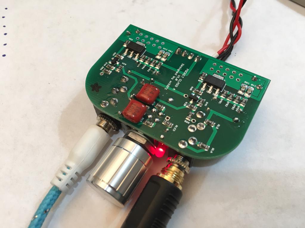

X's personal NHB version
I had some time to build my own personal no holds barred (NHB) amp. I am trying out the Nichicon AK 470uF output caps per StellarElelphant's recommendation, paired with 2.2uF Wima's and on input, 10uF 100v electrolytics paired with 100nF 100v MKT's. I am also using super-matched FETs (matched to 4 significant figures with JFETs selected for 7mA bias and MOSFET running 50mA bias).
So here it is, doesn't look too different but theoretically, should have deeper bass extension and better highs. Will listen for a few days and report back. Also will put it against a standard on with my AB box.

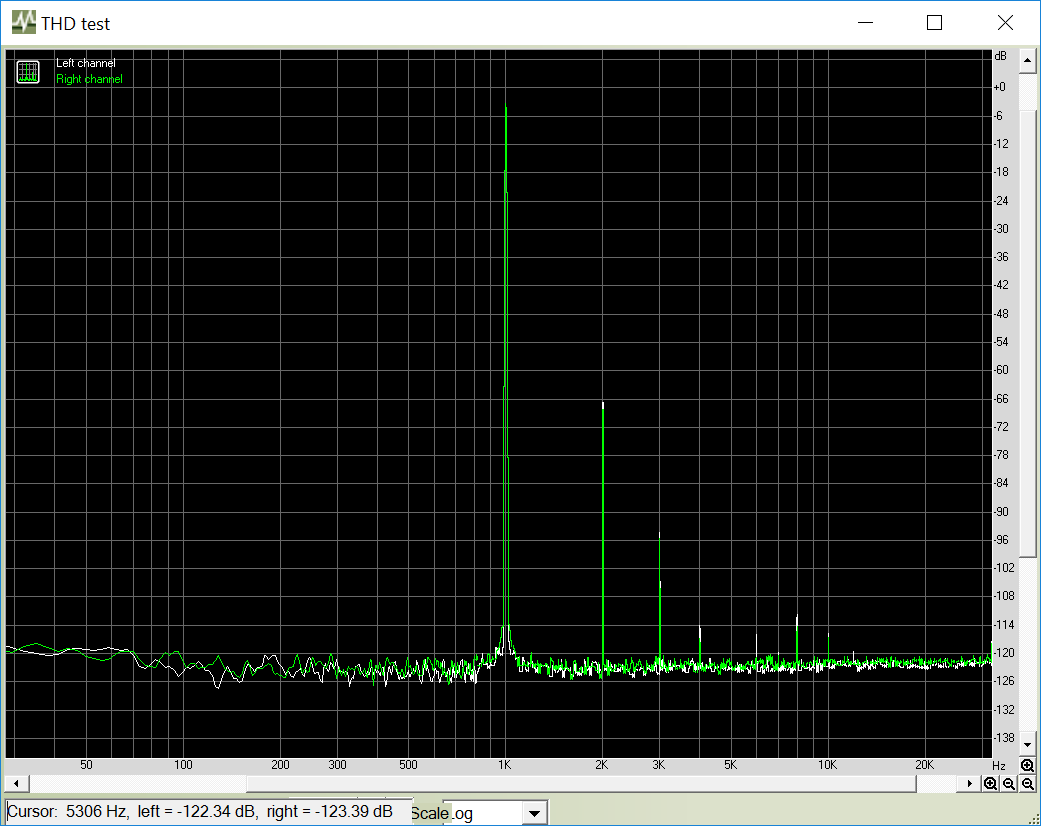

Here is the FFT - mostly H2 with H3 about -30dB less.

Here is the predicted HD profile:

Here is the measured HD using Focusrite Solo 2nd gen at 96kHz and 24bit:
The HD measured using a UCA202 at 16bits and 48kHz looks like this:
Edit Feb. 18, 2017 - Here is the latest measured frequency response and THD from the GB PCB:
Edit Feb. 18, 2017 - Here is the latest measured FFT from the GB PCB measured for 1kHz excitation at 700mV into a 270ohm load:
