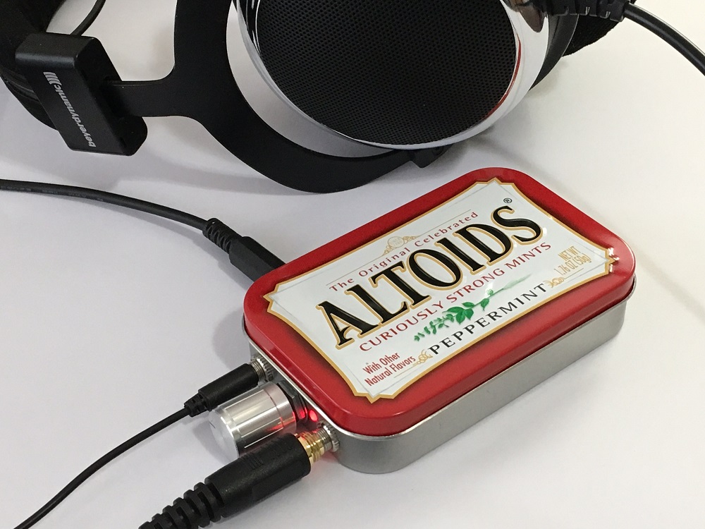

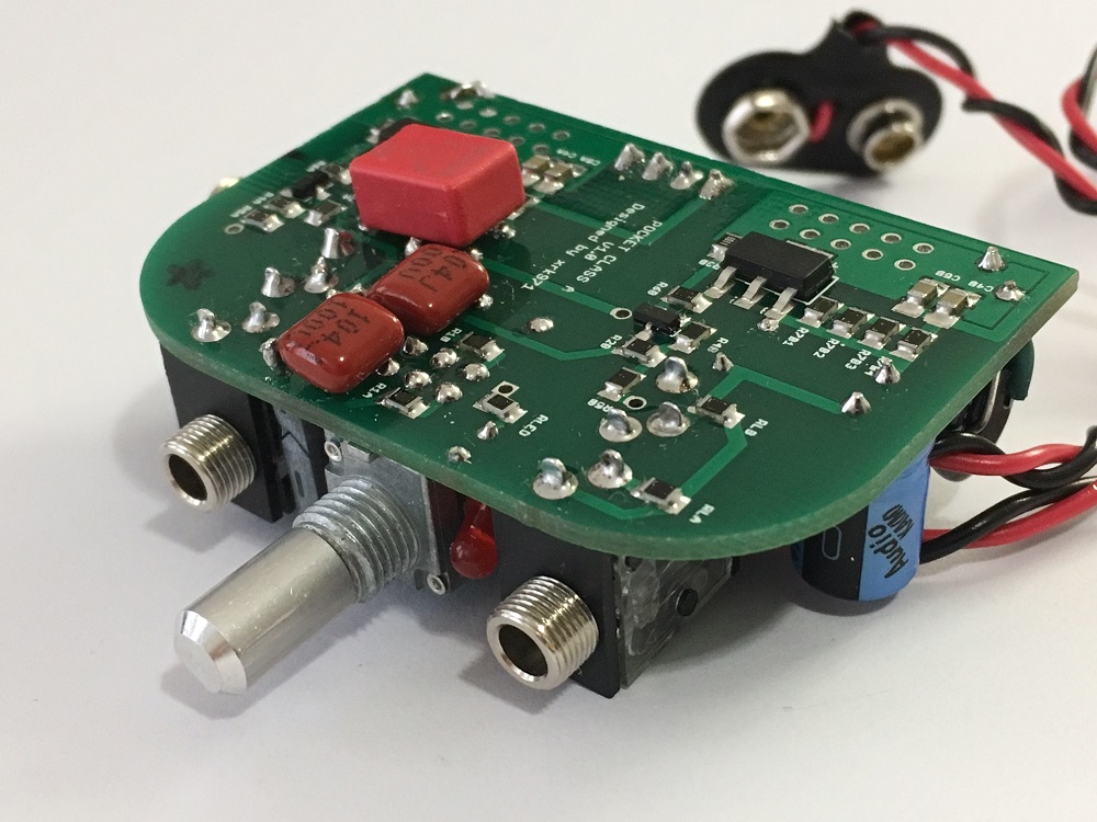

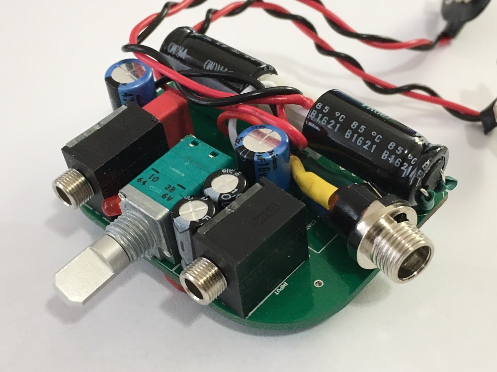

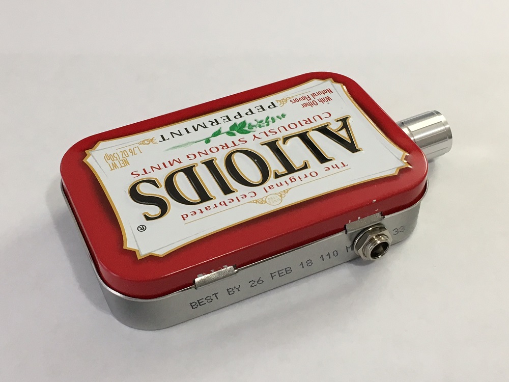

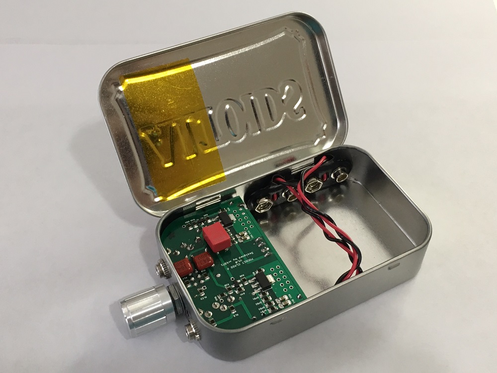

I couldn't believe the interest the NHB version of the amp got on Head-Fi.org. A member there bought one fully built and he asked for a special version that could be used as a desktop amp as well. After some tiinkering and surgery on the amp, I was able to successfully add a standard 5.5mm coaxial power jack while keeping the pocket size mint tin format exactly the same! Plugging in an external low noise PSU (like the 60uV rms level noise ones they sell for high end DACs with single 15v or 18v and 1amp rating) automatically disconnects the batteries, so preserves them for use when you are on the road. When at home or in the office, plug it in - can also be a nice preamp.
I had to move one of the output bypass Wima's to the SMT side to make room for the power jack. Everything fits together perfectly and the unit works seamlessly between the two modes. I think this is now also the world's first Pocket Class A headphone amp that is also a convertible Desktop headphone amp/preamp.
In case anyone doesn't want to make their own NHB Convertible amp from a GB board, I can sell them prebuilt for a price. Just PM me.
Look how well that coax power jack fits there:
Closeup of the minor surgery:

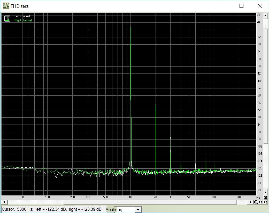

FFT - hand-tuned harmonic profile to achieve super musicality and and engaging presentation:

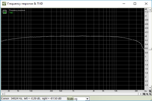

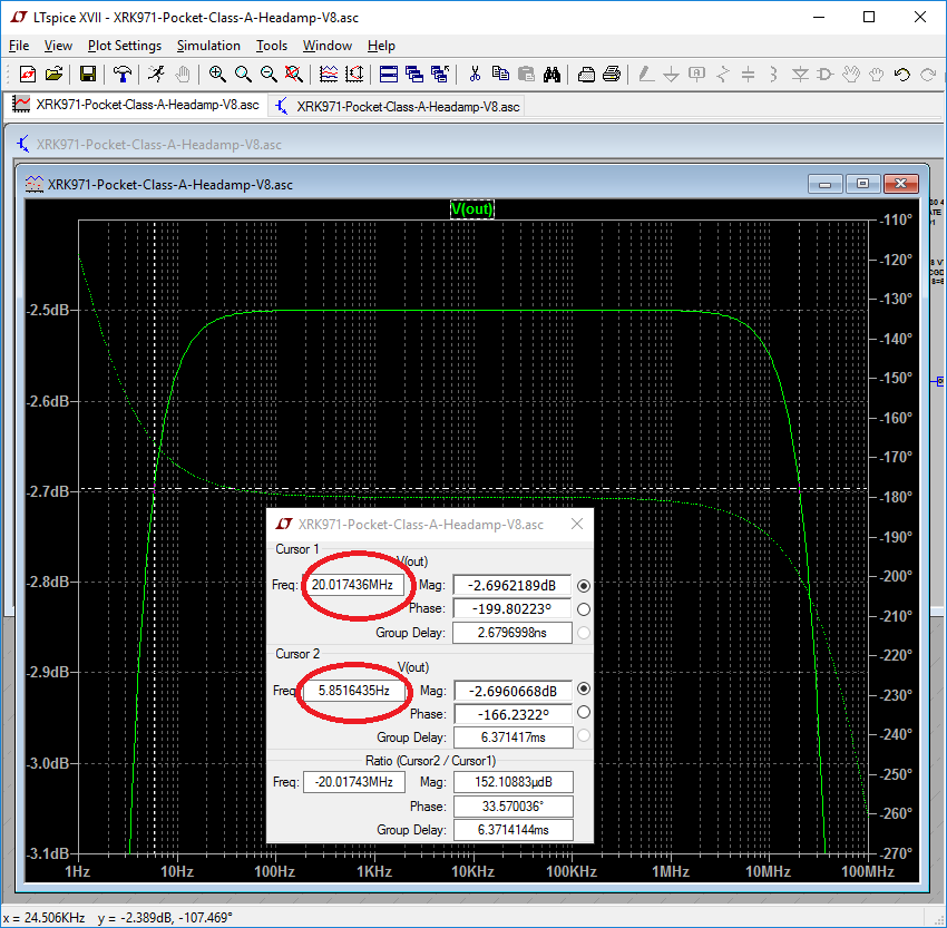

Deep deep bass extension, now -0.5dB at 10Hz, top end probably well beyond the measured sampling limit of 96kHz (close to 1 Mhz based on sims):
How does it sound? Perhaps one of my best amps *ever* 😀
