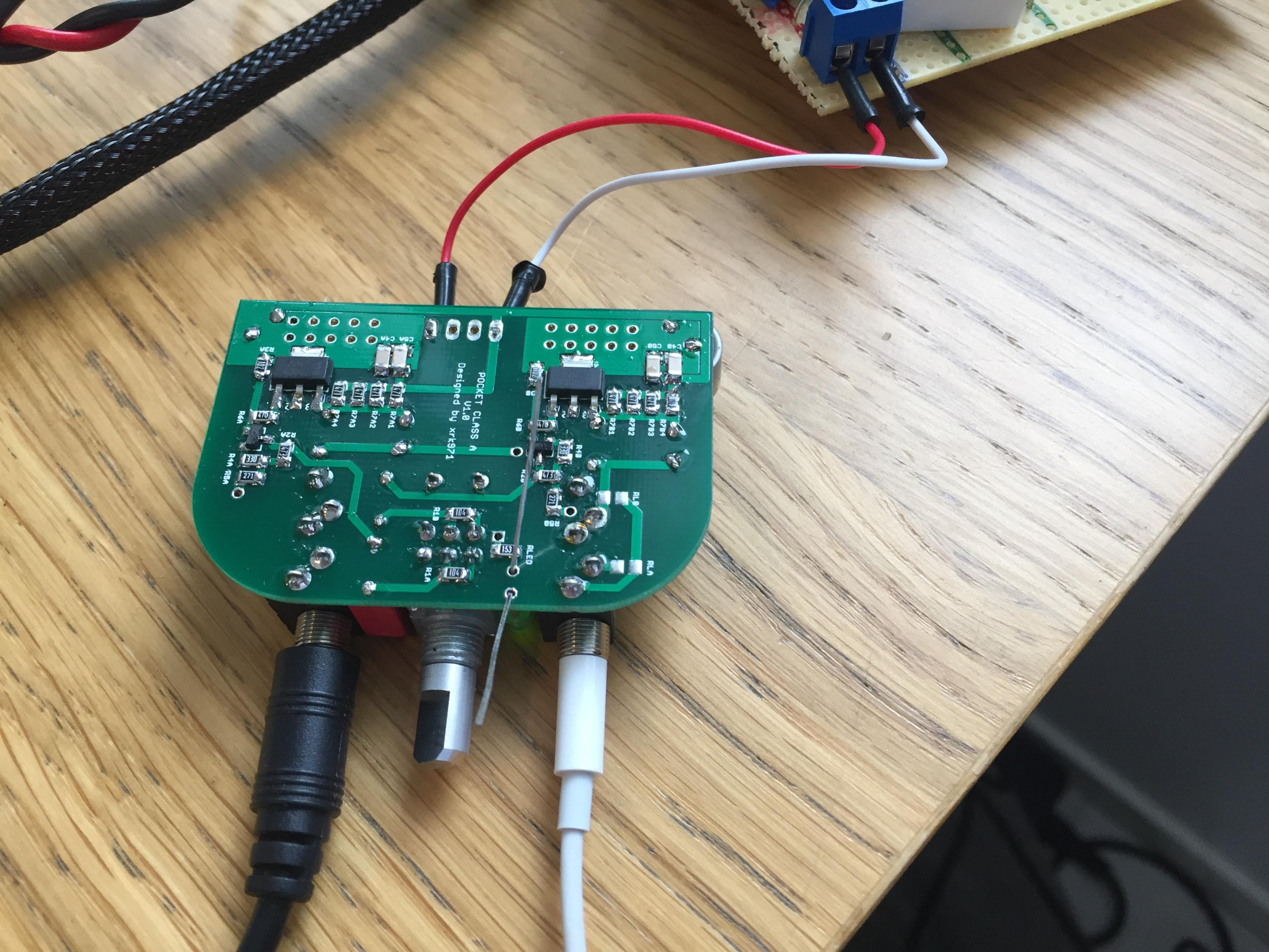

Ok, it's up and running now. Is it normal that the rail caps and the ouput caps are feeling warm to touch? I'm feeding the pocket amp with 17,9 VDC and I have some iPad earphones (16ohm?) now while testing.
Congratulations! You are fast!
It's normal for the parts to be warm. It's the radiation and conduction. What is your bias current through the four 470R resistors? 17.9v is a bit higher than 16.4v nominal of two rechargeable batteries so will be running hot. If bias is more than 55mA you can adjust R4 to a slightly lower value. But test with batteries to set bias as this is what you will be using it at.
Do you have any higher impedance phones to listen with - how is the sound?

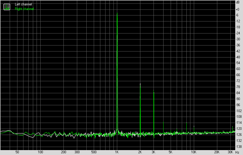

I just remeasured this amp with the rig moved to a (electrically) quieter room. The THD (for 1kHz and 700mV into 270ohms) is 0.028% and the noise floor is -126dB, dynamic range is coming in at 94.5dB and IMD is 0.026%. Frequency response is utterly flat.
FFT:
Freq response and THD:
FFT:
