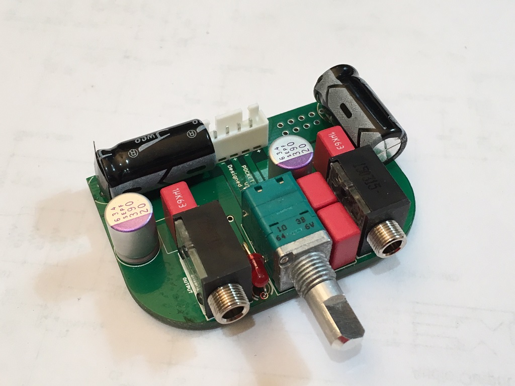

Since the output voltage is only 11V max, I've decided to use this as the output coupling cap in my amp:
Panasonic OS-CON 16SEPF1000M
16V, 1000uF, 10x13mm.
Going to lay it on its side the way I drew it up in Post #148.

Say, X, have you tried listening to the Pocket Class A using just OS-CON output caps without the WIMA film bypass? I came across this post on Gearslutz wherein one guy sings the praises of OS-CONs and says they give the best treble transparency with no bypass at all.
I can't say that I have tried without. However, it's easy enough to try on the next one I build to leave it off first. My hunch is that it's tough to beat a good Wima film cap on treble with an electrolytic. The OSCON is there for the bass - low ESR needed. When using plain elco's for full range and treble, many people like Nichicon Gold, or Elna Silmic. I have nver tried those.
It's interesting how on Gearslutz post the guy says it's 2-3% more noise! I somehow doubt that to be possible because my noise floor measures -123dB.
Snazzy. The way you turned one 90 degrees gives a bit more breathing room than the way I had imagined.

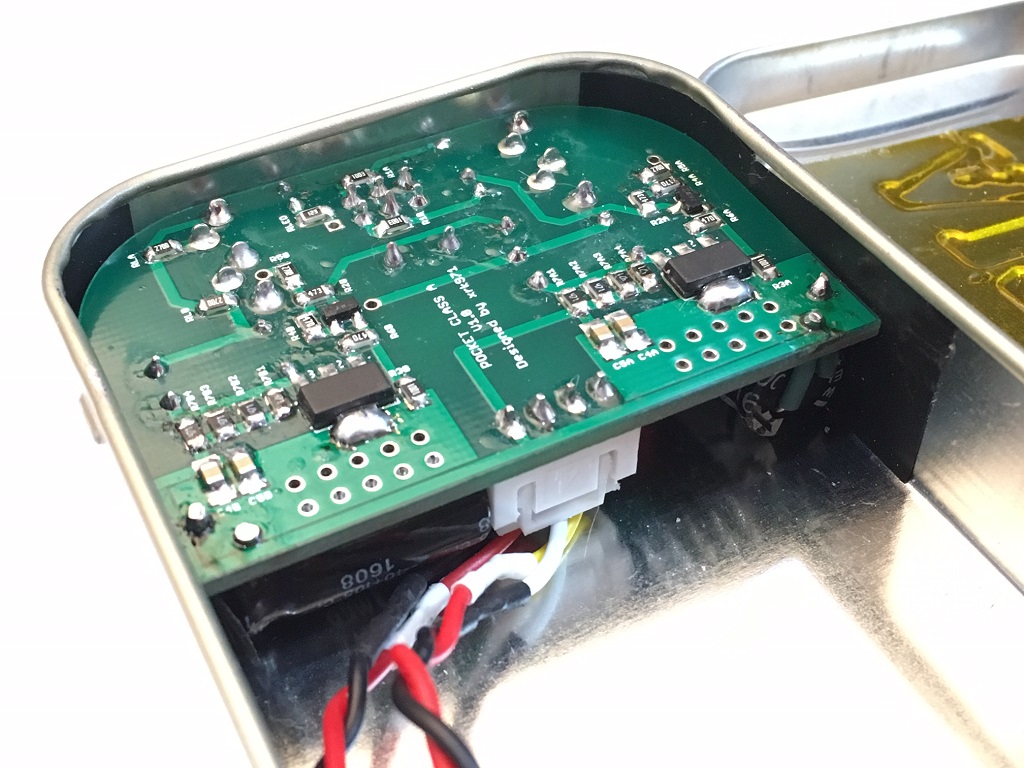

w.r.t post 184, the cap on the right looks as though it may not fit in an Altoids tin. Does it?
It fits just fine.
