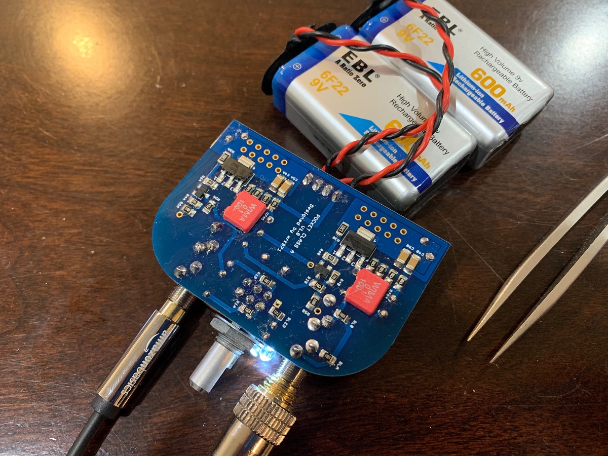

Fresh solder paste that flows easily is important. Should not make you hurt your hand from having to squeeze to hard. I had that happen and it was 2yrs old way past expiry. Keep in refrigerator in a ziplock when not in use.
Thanks for the kind words fellas 🙂
I took my time and had to wipe off a few pads because too much paste was applied. One of the steps that really helped was sticking the SMD components (while still in their packaged row) on a piece of blue tape to hold them in the order listed on the parts list. It kept me from misplacing components. When the board was completed, I was amazed with how fast the actual “soldering” went. With enough practice this method is much faster than soldering THT components.

The pink tip I used came with a different tube of solder paste. The two nozzles that came with the MGChemicals paste that I used would never have worked, they were much too big. The pink nozzle hole is about 30% as big as the included syringe type nozzle.

I need to get some of those smaller nozzle tips. The one I have is a bit too large for smaller pads and can be a real pain to apply cleanly.
re: ItsAllInMyHead,
The tips you point out are the correct ones. If it matters, I found them on Amazon at a better price.

Thanks everyone. I ordered up a variety of the tapered tips. Brilliant. Maybe I can take up a side gig and learn to do henna tattoos. Can't imagine what they'd have to do with henna and hydroponics, but those seem to be tagged keywords. 😀
I never thought to store it in the fridge after use. Noted with thanks. I don't use a ton of paste, so that's a great tip.

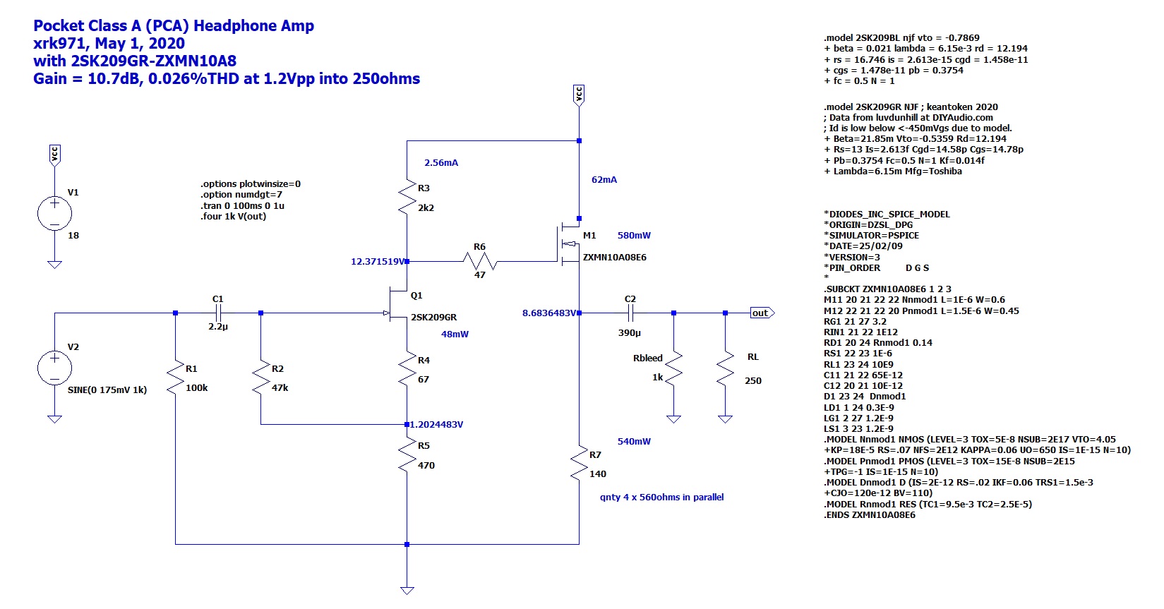

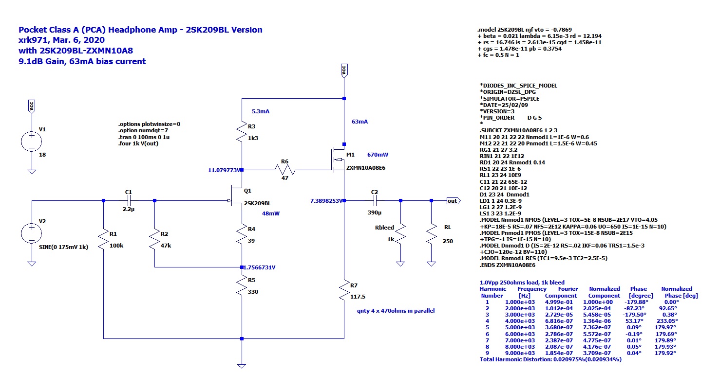

Updated Design for 2SK209BL and ZXMN10A8 MOSFET
Hi Folks,
Due to the end of life of my favorite JFET, the BF862 and now, the end of the old MOSFET we used, it is time to update the design to some available options. The Toshiba 2SK209BL actually is working out really well. I am getting some nice performance with about 0.02%THD for 1.0Vpp into a 250ohm load.
Hi Folks,
I just built a verification unit using the above resistor settings and 2SK209BL and ZXMN10A08GTA. For R3, I did not have a 1k3 on hand so used a 1k2 1210 resistor in its place. It resulted in a slightly higher bias current iof 72mA, but that's ok as I will be using them with lower impedance phones. I am using the 2200uF 16v Nichicon rail cap as the output cap, now bypassed with a 0.1uF 100v Wima MKS. The sound is excellent!
YOB:

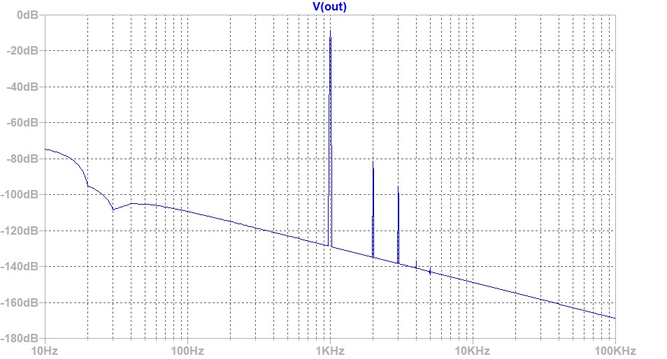

I just got a new LTspice model of the 2SK209GR from Keantoken. Here is what the latest simulation shows for a good circuit with the 2SK209GR and ZXMN10GTA. This will drive 250ohm cans to 1.2Vpp with 10.7dB gain and 0.026%THD.
This is for 1.2Vpp into 250ohms:

I have sort of neglected to update the BOM since the BF862 and ZVN4396 have been discontinued.
Please use this schematic:
Here is what I think is the BOM that goes with the 2SK209GR and ZXMN10:

With a bit more free time than usual due to you-know-what I've started building another one of these with the 2SK209GR + ZXMN10.
How'd you manage to fit 2x 1000u OSCON on the output? It doesn't seem to want to fit for me - not enough clearance to have them side by side.
Also, not sure if this thread is still getting much interest, but an update for the BOM - for the rail cap, if lying it on its side, you can easily fit either a 2200u 25V EEU-HD (Panasonic), or if happy to use 16V, a 3300u EEU-HD will fit as well (12.5x20mm).
I've also fit a 3300u 25V before, laying it pointing "forward" (toward the pot and sockets) but that required creative wiring for the output caps.
R7 on the BOM should be revised to 560R, assuming the diagram is the correct one.
Hi YOB,
You have to put a dogleg bend on the pins of one of the 1000uF SEPFs. It fits fine:
https://www.diyaudio.com/forums/group-buys/302859-xrk971-pocket-class-headamp-gb-58.html#post5058562
Regarding R5, for 2SK209GR I used 470R not 540R, per the schematic above.
Glad to see you are getting back into this amp. It still is one of my favorite headphone amps, despite having much bigger and fancier ones, this one always puts a smile on my face when I listen.
Built it up and took some measurements - I built at per the spice schematic with 560R x4, used 68R on R4 but it was running way too hot - 10.8V across R7 / 77mA.
I had to take R4 down to 24R to get anything resembling the spice sim. Voltage across R7 settles somewhere between 9.25-9.35V with about 0.05V difference between the channels. Voltage at R4-R5 junction was 1.20/1.21V and R3-R4 was 12.37/12.38V
Not sure if I just got hot running fets or if it's something to do with the models used in the sim, just thought I'd let you know.
It may have to do with your particular 2SK270. It almost sounds like you have a BL rated one, in which case the setpoints are different. If you are needing to adjust bias current / DC at the output cap try changing R3. Larger value is higher voltage at Source of the mosfet. Problem with making R4 too low is the H2 will increase food much.
