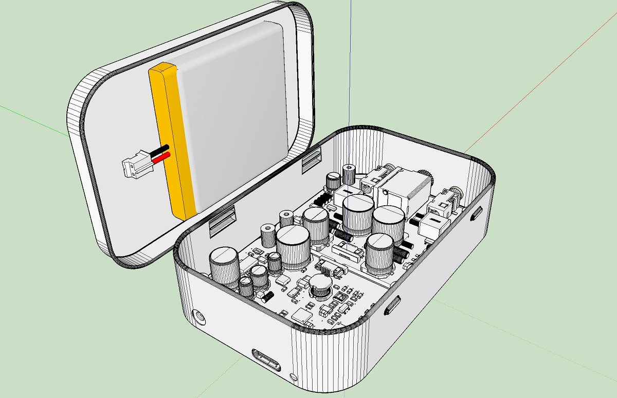

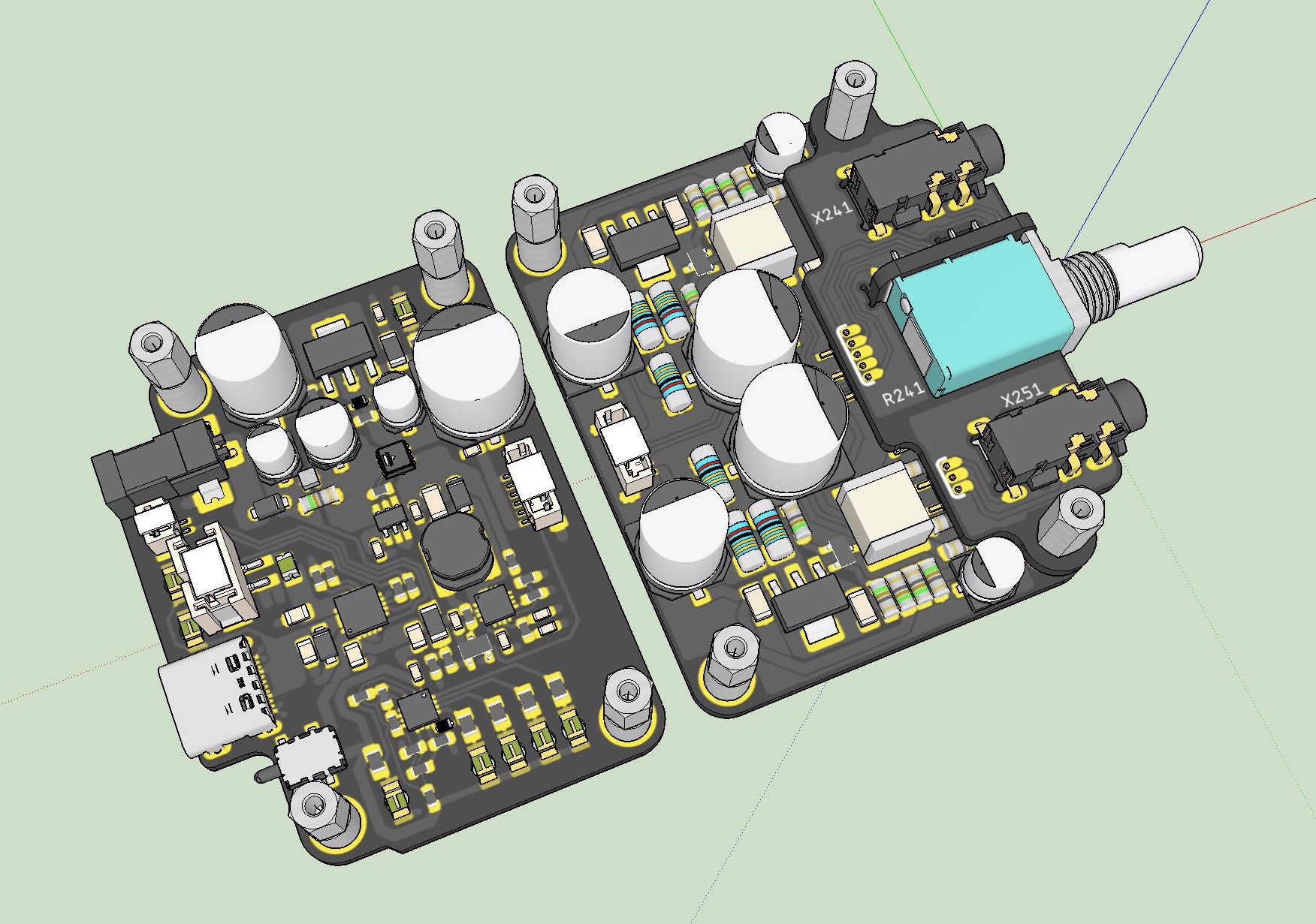

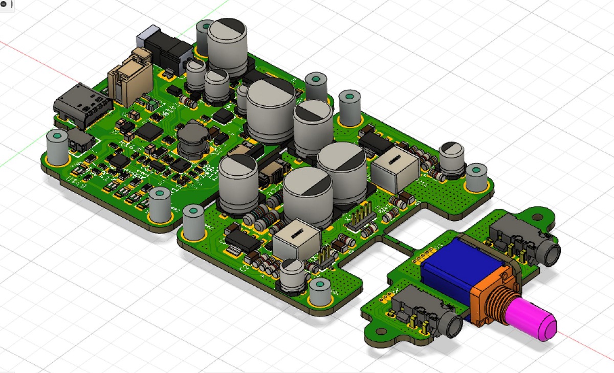

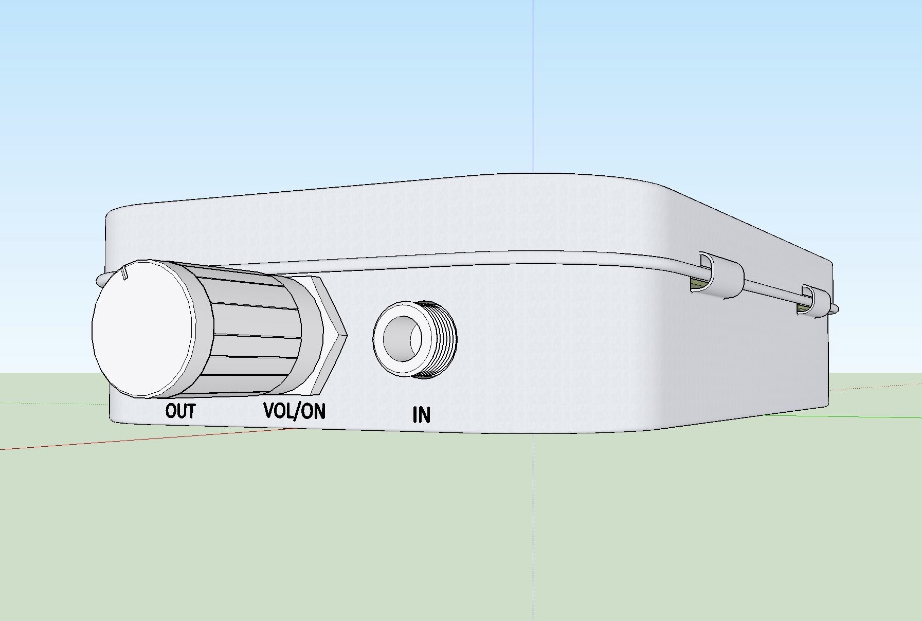

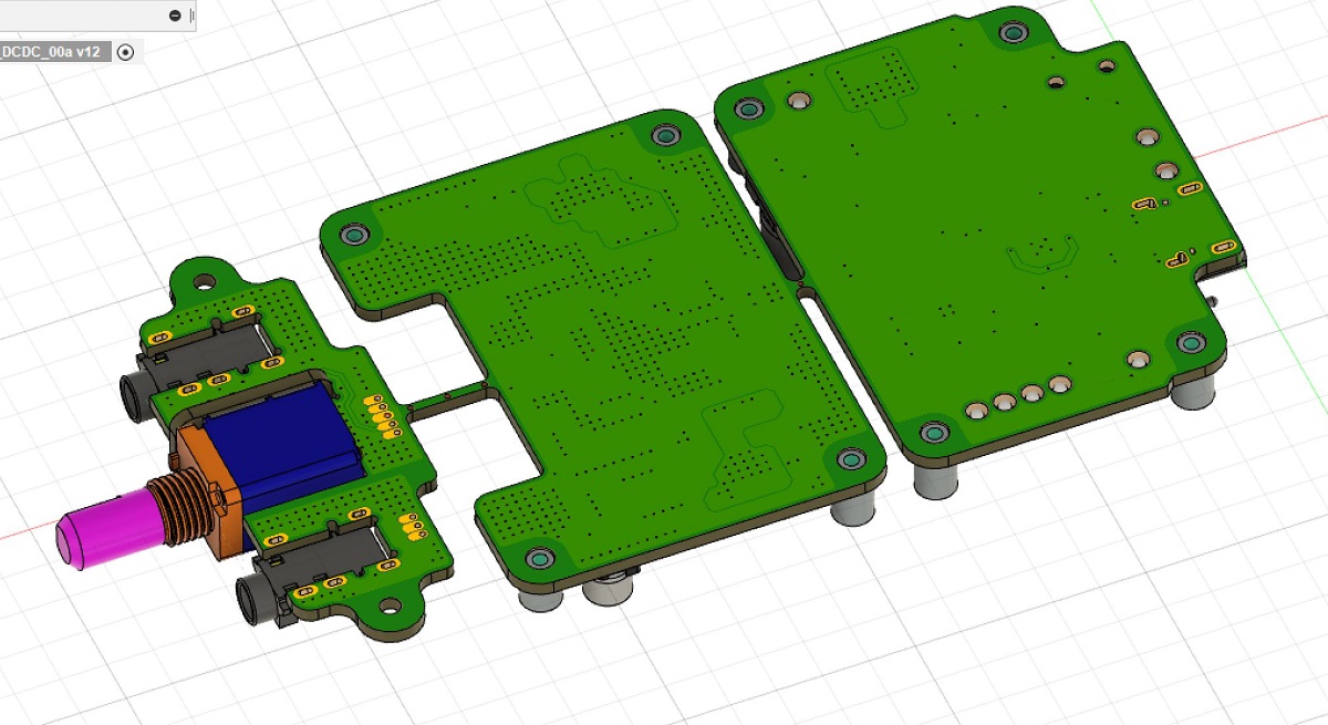

More progress from JPS64. The Altoids mint tin user interface is evolving. We are back to the through hole Switchcraft Jacks. There may be an all SMT I/O and volume pot mezzanine PCB.
I do find that it's easier to access the volume knob on my small portable amps, when the knob isn't between the input and output jacks.

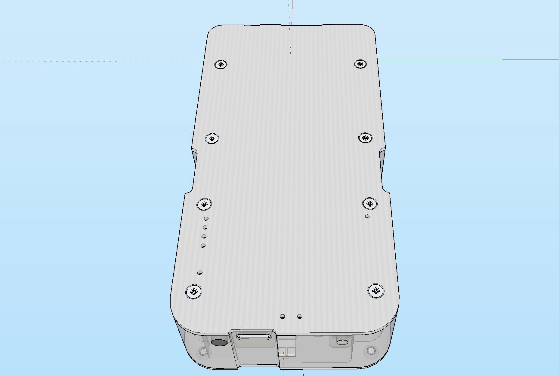

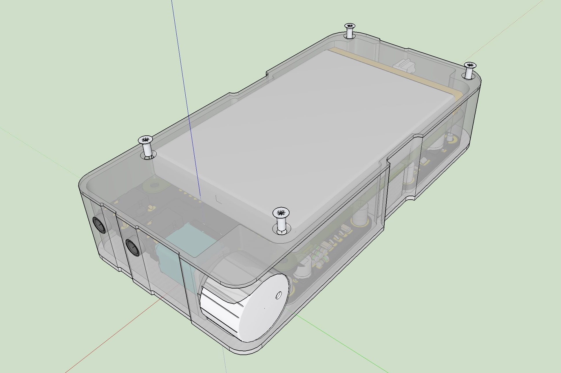

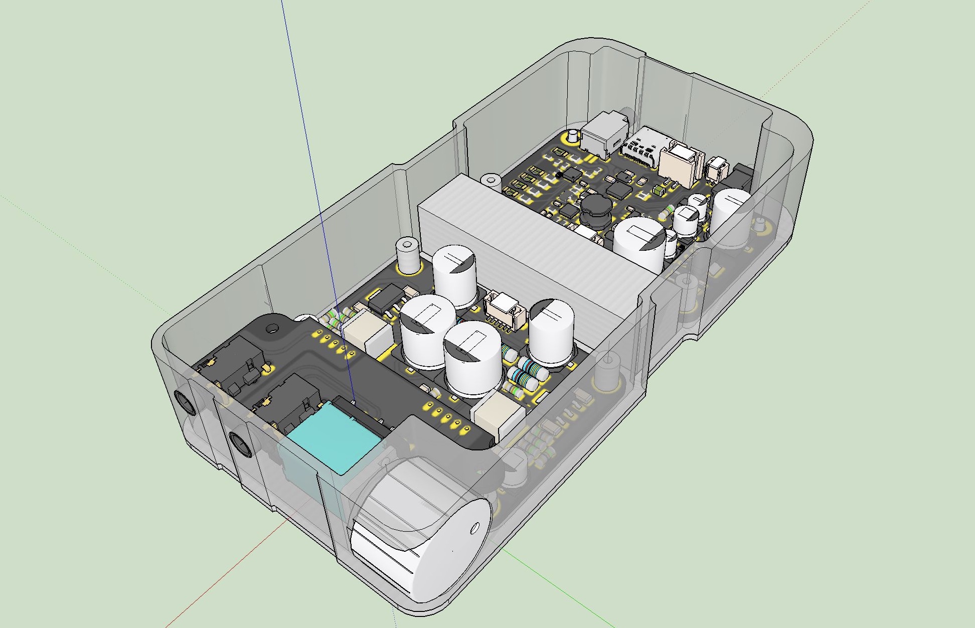

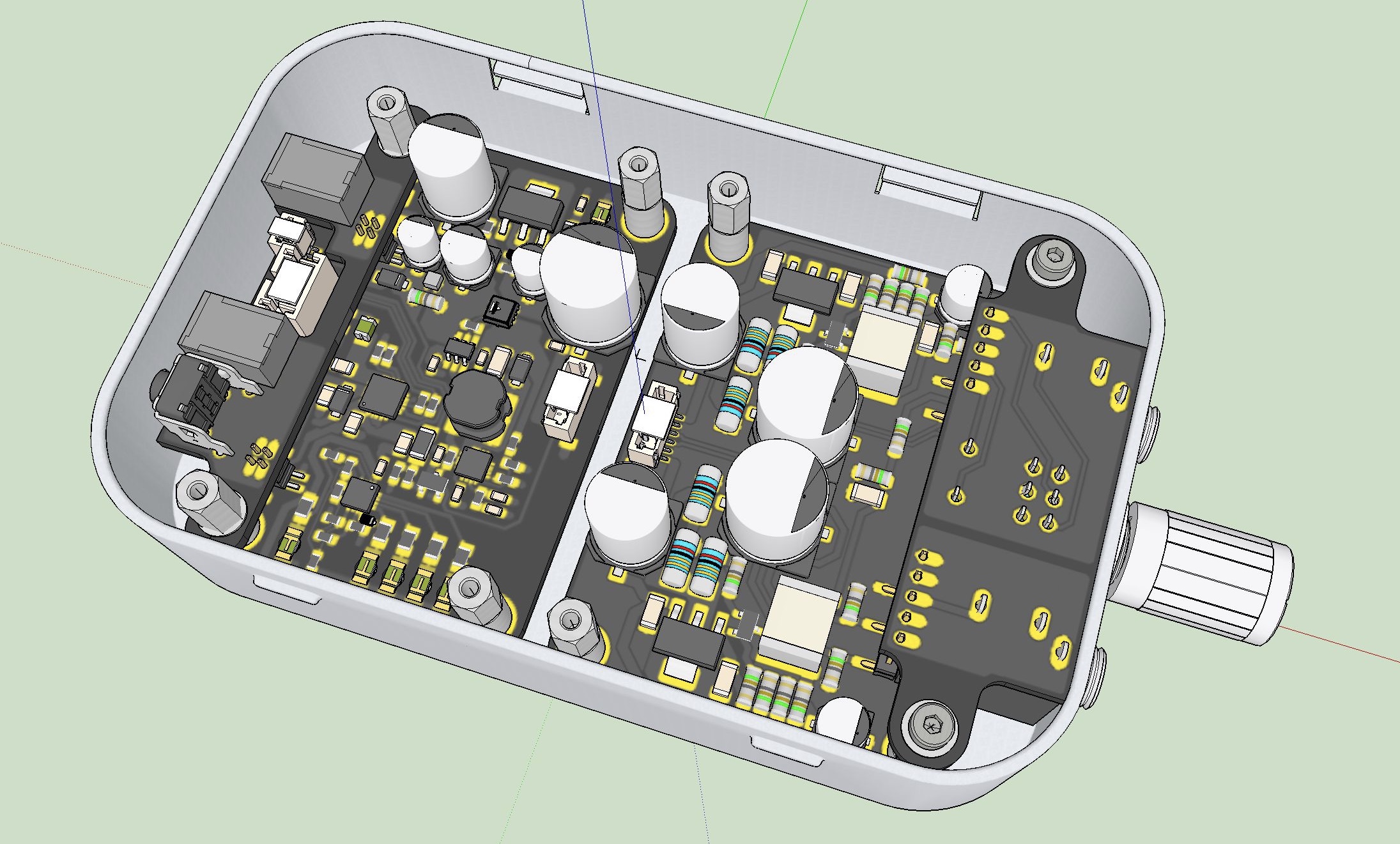

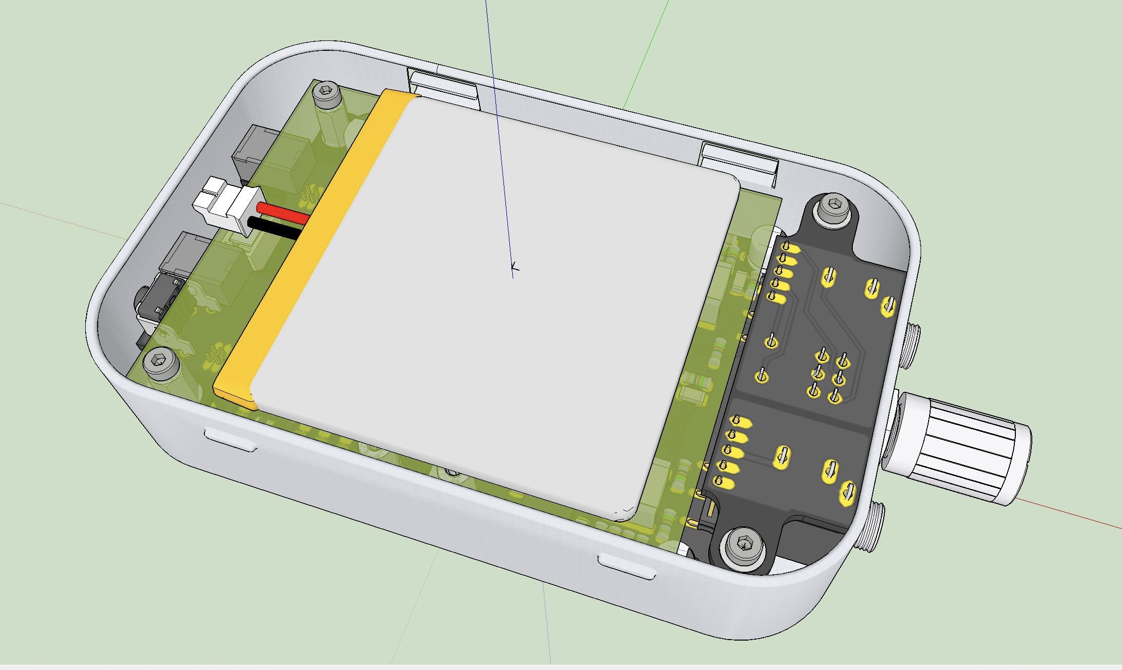

3D Printed Case Version

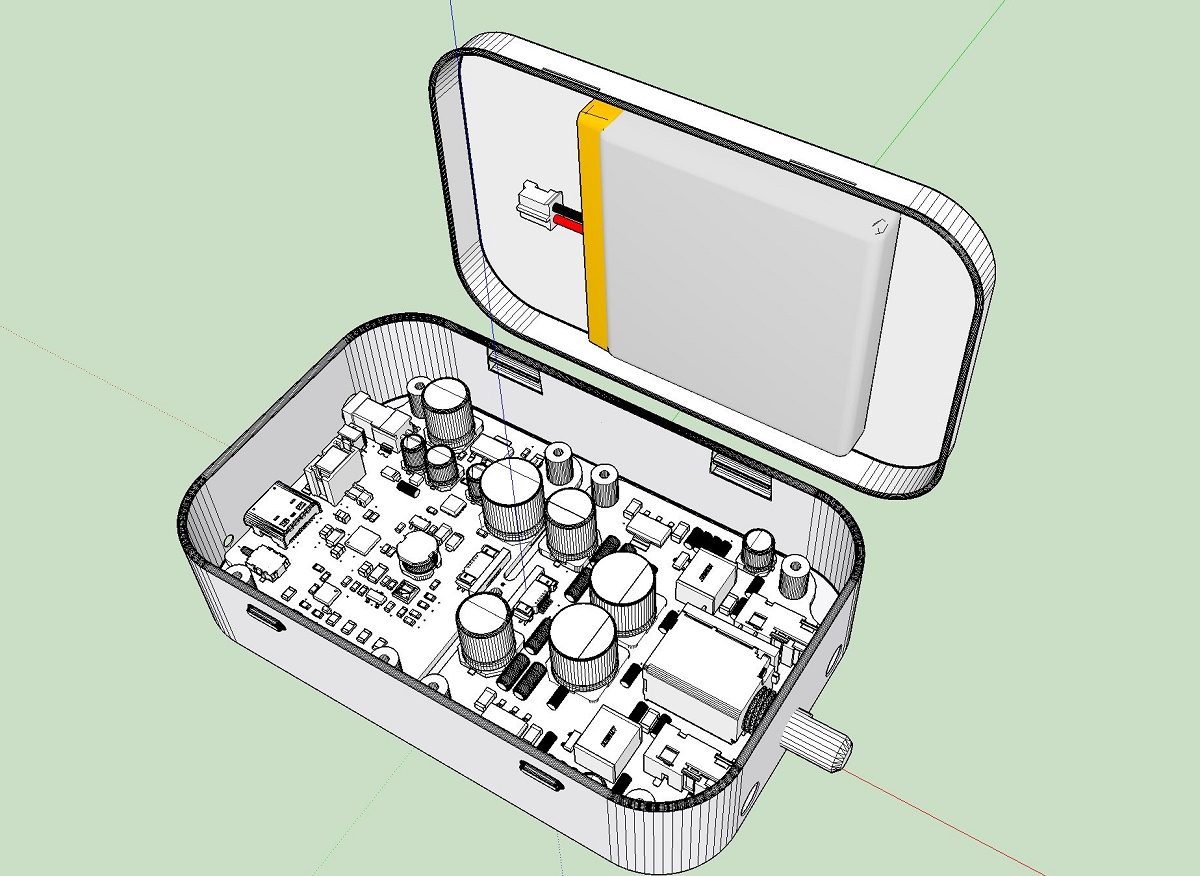

Now with 5000 mAhr battery and sleek interface. Continuous filament carbon fiber printed with MarkForged Onyx would be very cool.
Another one for the 3D case

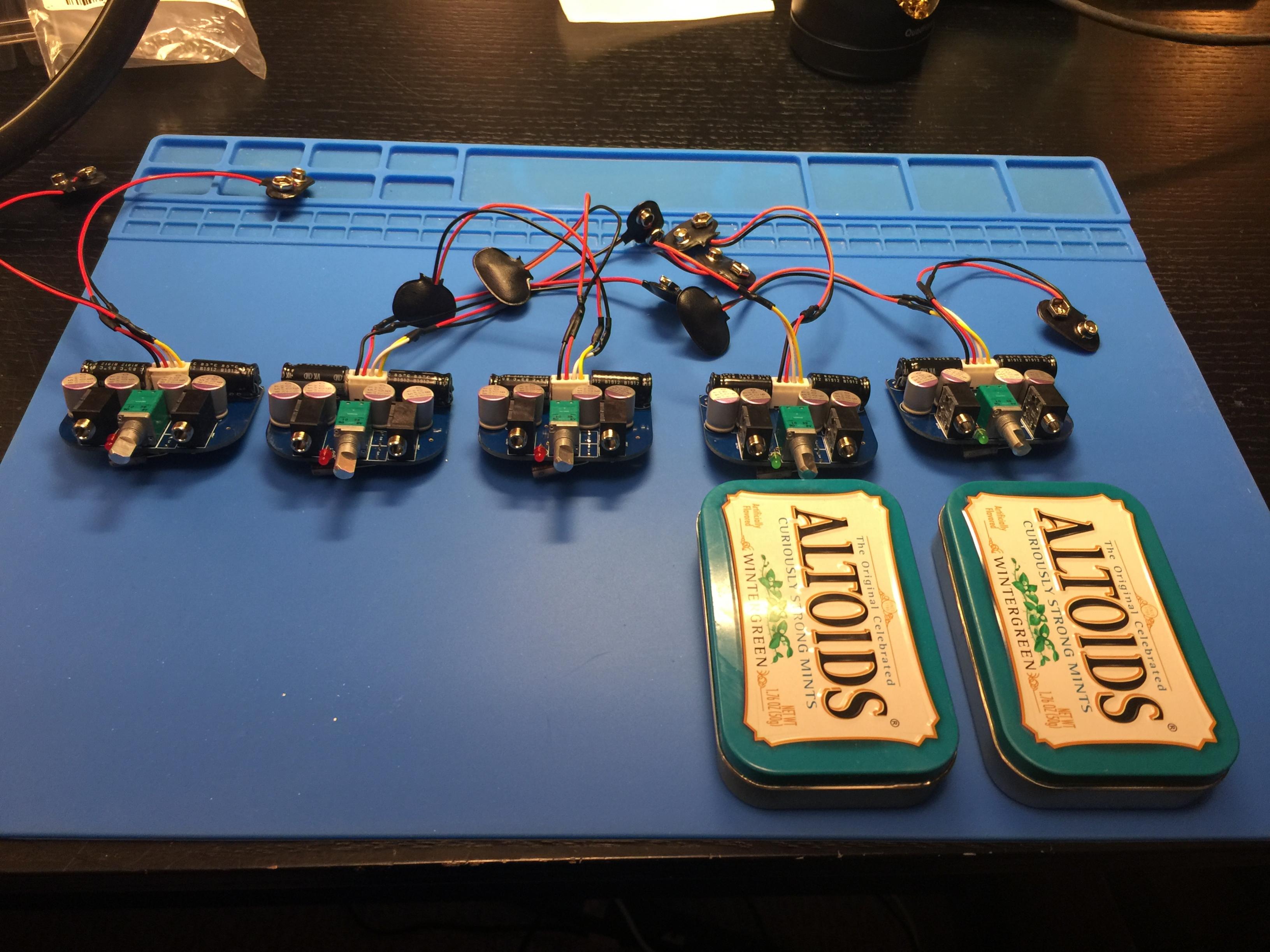

Alas, the build party just wasn't going to happen. No one wanted to try their hand at SMD work. So, I put these together yesterday for some people on my "Nice" list. Come to think of it, maybe the naughty people should get them...
Now, I need to munch down three tins of the Peppermint and do some casework 😀
For a pocket-sized HP amp - It is darn near impossible for me to beat these. I take one with me almost everywhere. It's amazing the interest it generates. People in airports / on planes are the most curious. My friends can't believe the sound even for use with a phone. I've already given away my first two. I was in withdrawal for a few weeks without one. I'm keeping one of these and not letting it go. No more builds. Seven is enough.

Nice work! That’s a lot of pocket amps, can’t see what people would pass up an SMD soldering party! 🙂
