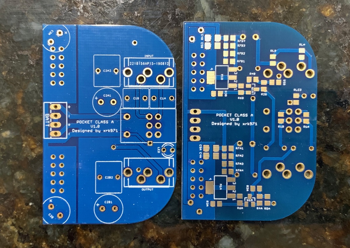

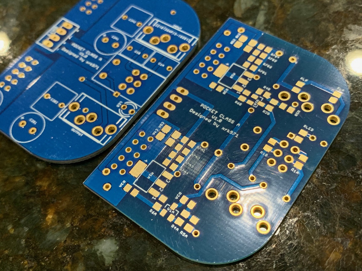

The boards are available for order now in my shop. Should be here in 3 days - nice blue ones with gold ENIG finish. Same price.

The new blue ENIG boards arrived today. Unfortunately I am on treacle and wot. Be able to send them out until Friday. There’s been a lot more renewed interest in this amp lately.
Great looking boards! Can't wait to build a few more with friends.

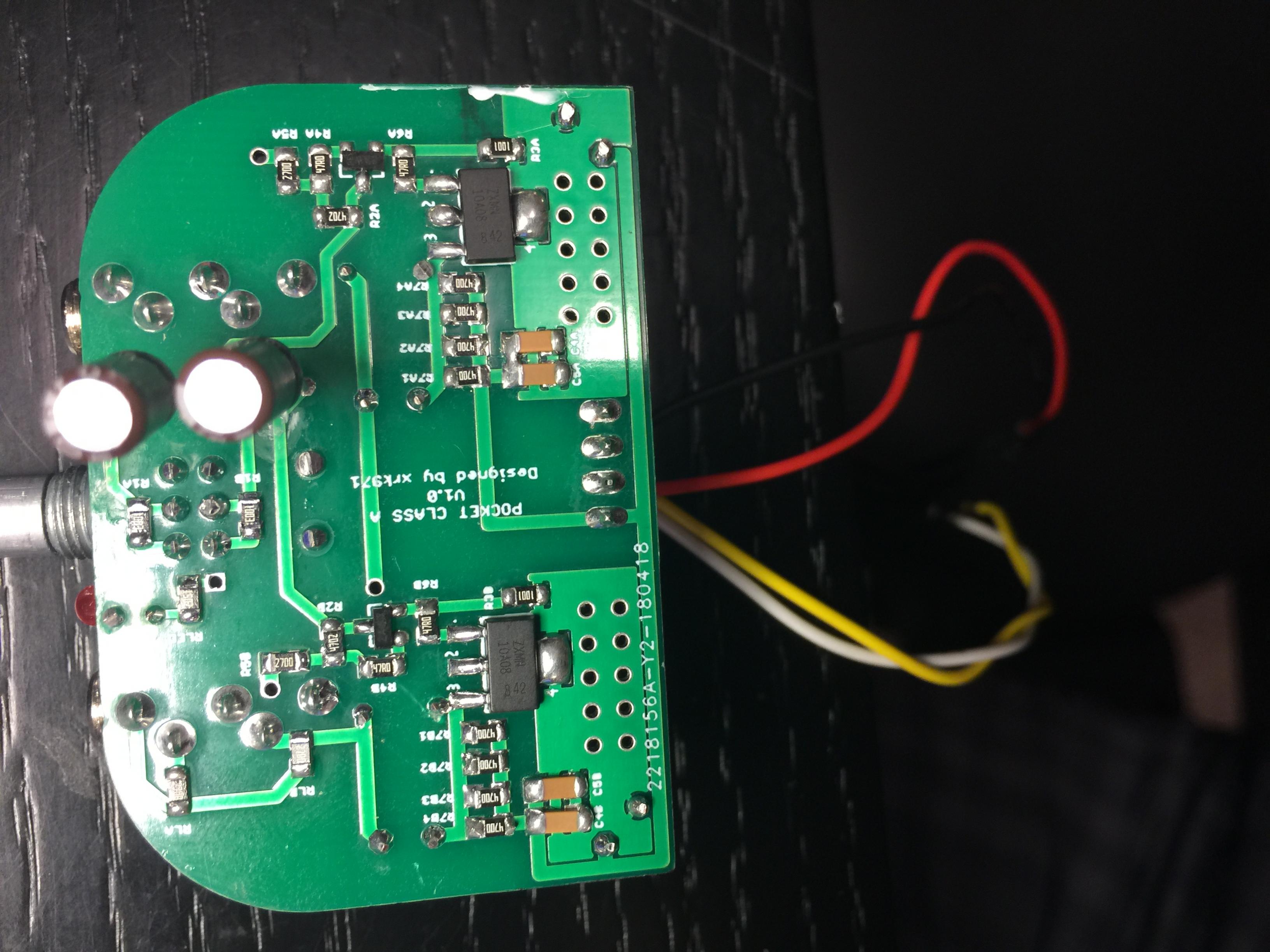

So, as a noob, I was bound to do something foolish at some point... and I did.
I could really use a bit of help troubleshooting. I had two perfectly functioning amps until I went to install them in the Altoids tins. I was in a bit of a rush, so you guessed it, I didn't properly cover the leads for the C3 caps. One or both sides grounded / shorted with the case. Pretty light show...
Amp Alpha - one working channel (Right)
Amp Beta - neither channel working
I am new to circuits, so after studying the schematic again, I went back through this thread and found a few issues where X and others have helped.
Physical observations - under 2.5x and 10x magnification - nothing on either amp board looks burnt. No bulges in caps, no discolored parts. For troubleshooting I used two freshly charged EBL 600mAH batteries measuring 8.14V each.

Hi X -
Thank you very much for the response (particularly on a weekend).
I measured the resistance between the drain and source for all for MOSFETs. They all started at ~200ish ohms then climbed to over limit.
I double checked all resistor values, but additional eyes are always appreciated. I attached photos below. Getting all the resistors in focus is tricky, but I got shots where they should all be legible. If not, I can try again (there are some blurs).
Next step (unless guided otherwise,) is to replace the C3s. I need to wait until I get my parts order for the next builds. That should be Tues. I'm out, and did not order extras.
I checked the behavior of the drains (I measured between pin 2 and the vias) and still got 0 Volts. I swapped to a new set of EBLs just in case and also tried alkaline. The EBLs sometimes do take two "clicks" of the on switch to get them to go, but I read that was normal behavior. I still get over 10V at the source pins. I can check that again after replacing the C3s.
I've got a hot air gun on the way (I needed one anyway). So, if by chance I do need to replace the MOSFETs, I stand a better chance of not destroying the board in the process. The good news is that both amps were working flawlessly before I put them in the cases.

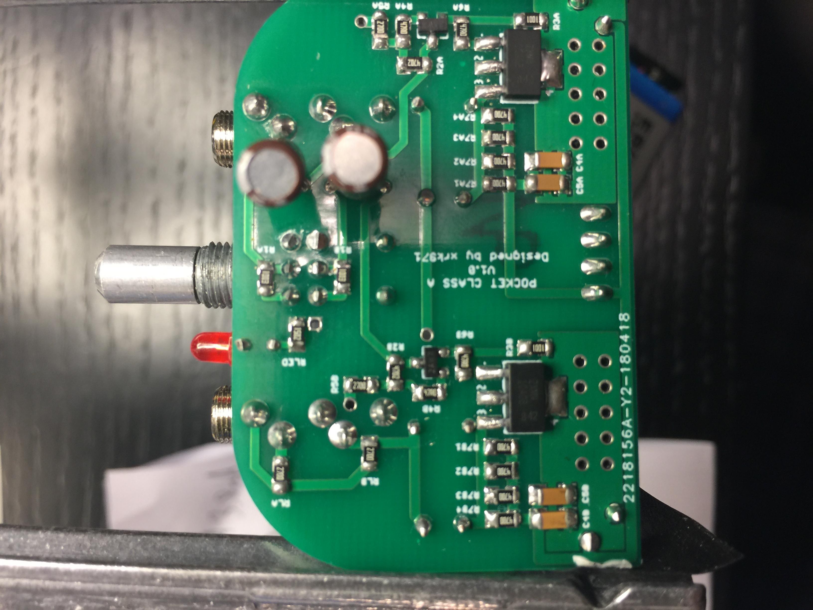

Pics below - Note I bent C1a and C1b back up and removed the Kapton tape for visibility along with double checking values.
Alpha -
Beta -
Alpha -
Beta -
Your resistors look good. You may have blown your on/off switch portion of your pot. Try soldering a jumper across the power pins on pot to bypass the switch. That might be why you have 0v at the Drain.
Thank you for double-checking the resistors. If the on/off switch is blown, then why would the LED turn on and off? Serious question. I reviewed the schematic, but being a noob...
Based on your thoughts, I tried measuring the resistance between each of the pot's pins in a potentially meaningful way to see if the on/off was functioning, but I came up with nothing I could make sense with.
Again, apologies for naive questions. If I run a jumper between the two points in yellow (leaving the middle pins alone) does that accomplish what you're recommending? Are those the "power pins"? By looking at the schematic and the PCB layout, I think that would set it to "always on" and bypass the pot, but I'm not 100% sure.

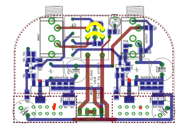

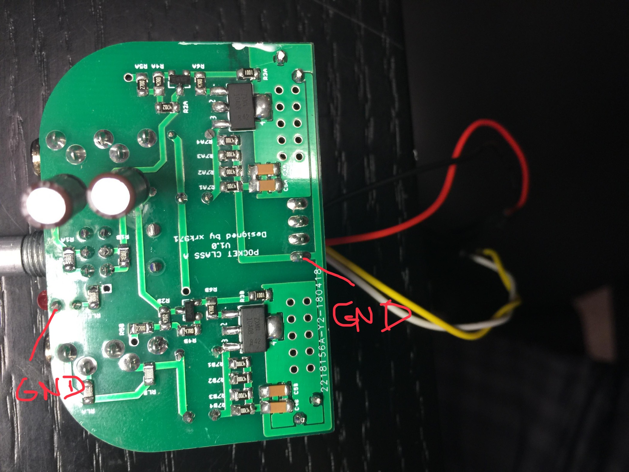

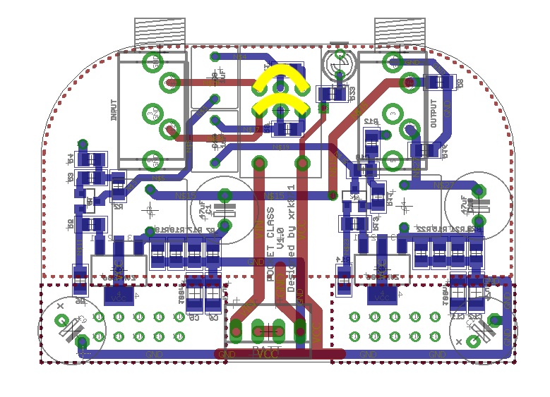

X - I also realized that I may not understand the layout of the board as well as I should. Just so I'm not running you around in circles and wasting your time...
The points in RED are where I was measuring the voltage between pin 2 and ground. When I look at the board itself vs. the trace diagram, Pin 2, Pin 4 (the large back pin) and the vias all seem to share the same copper pad.
Have I measured pin 2 completely incorrectly? I can't understand how I'd get a voltage the way I measured it if my observation re: the board construction is accurate.
I measured pins 1 and 3 similarly, with one probe on the "leg" and one in the via.
I'd hate for you to waste effort if my measurements were not taken properly.
As always, with thanks!

Voltage should always be measured relative to ground. Ground is the pin on battery connector on opposite end of positive or the pin closest to edge on LED.

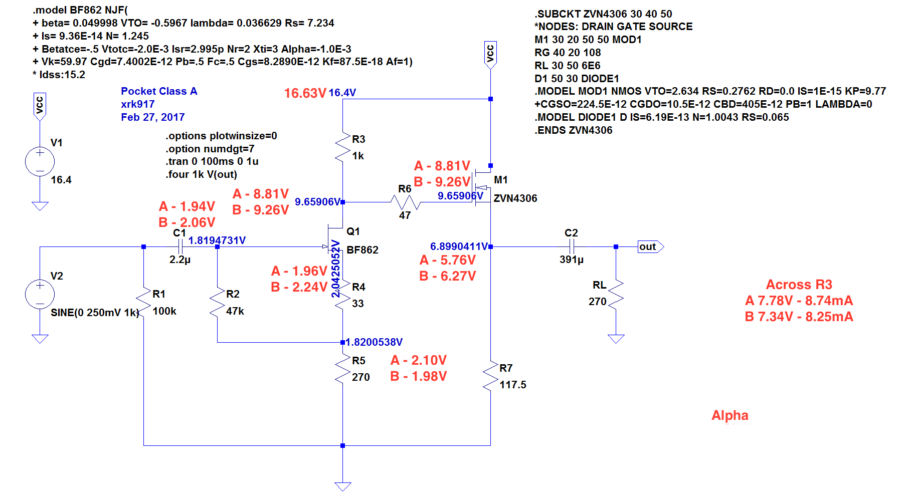

Well, don't I feel silly. 😕 I won't make that error again. My apologies. Once again, thank you for your patience.
Here are the correct measurements.
Alpha - Right channel working
Legs to Ground
1A Gate - 8.15V - OK
2A Drain - 15.80V - OK
3A Source - 5.08V - Below goal of 6-8V
1B Gate - 8.60V - OK
2B - Drain - 15.80V - OK
3B - Source - 5.61V - Below goal of 6-8V
Across R3
A - 7.69V & 8.49mA
B - 7.25V & 7.99mA

Your measurements show that the amp is working fine. Compare the voltages to the simulation at the various points. They are not far off - it should play music. Do you have the Input jack and output jacks reversed? Input is on left and output is on right side when SMT side is up. I have made that mistake. No sound.

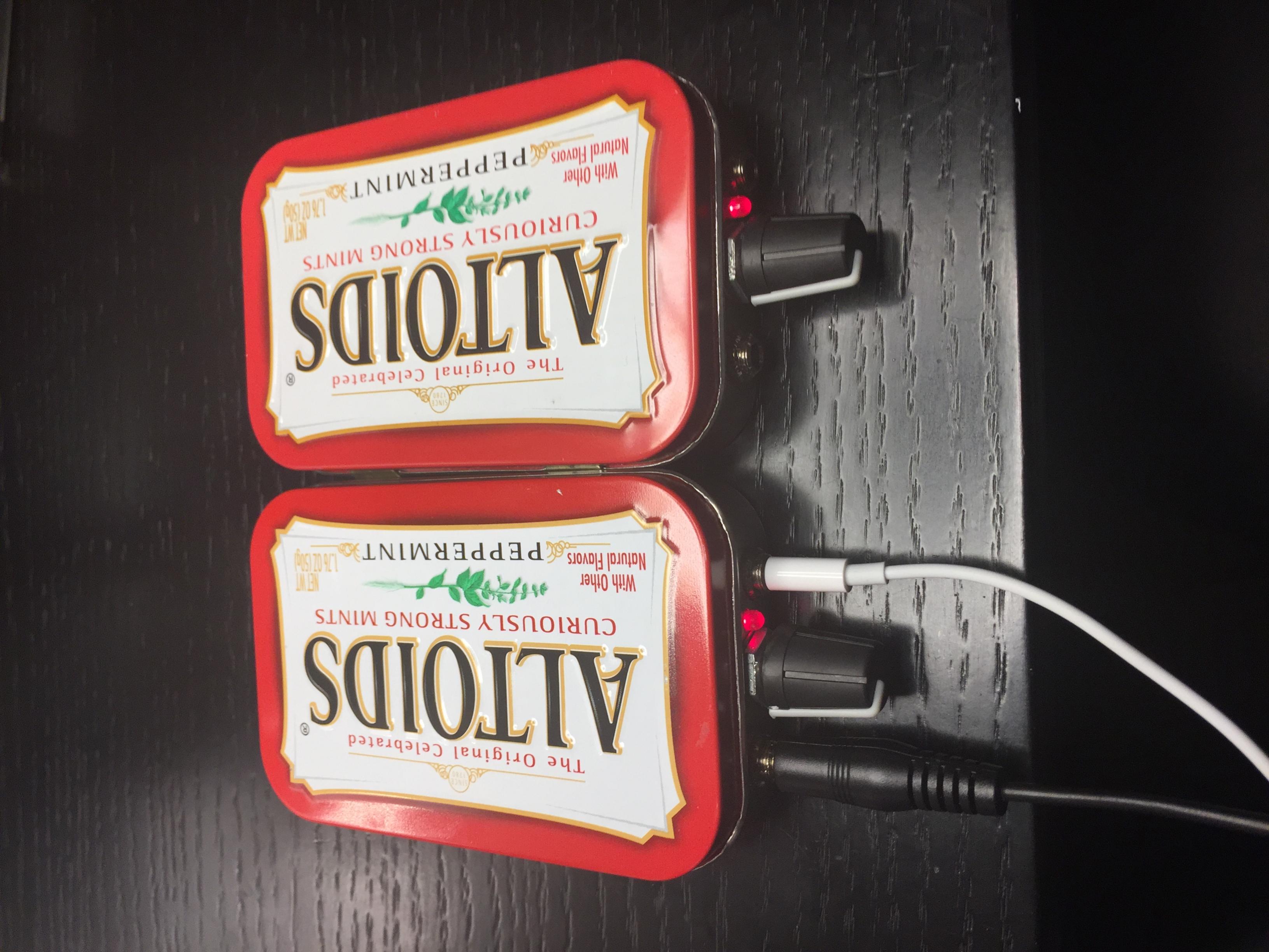

On to the good news. I now have two perfectly functioning amps. Two things (at least I think) contributed to the situation.
1) I don't know if it's related to the situation or not, but one channel on my test earbuds was out. Perhaps it got smoked during the light show. They were disposable buds you get on an airplane. If it's not related, then it's an odd coincidence. After the re-flow and visual check on Beta, it still had a channel out. On a fluke, I swapped to another set of buds - MUSIC!. Done.
2) On Alpha - I tried the new buds and got one channel. Progress. I did the same reflow, cleanup and visual check. There is a solder bridge between C4 and C5. On the side of the pads it was on, it should not affect the circuit. However, after the reflows and checks, and rechecks, it now functions perfectly again. I truly have no idea what caused the channel to go out. For anyone's interest - the measurements are attached below. Note - batteries were charged over night.
Again, I can't thank you enough.
The twins. I think it's time to do some other tins.
