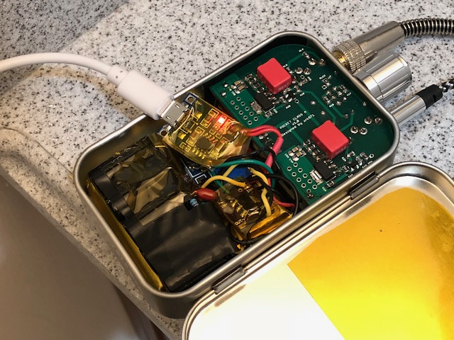

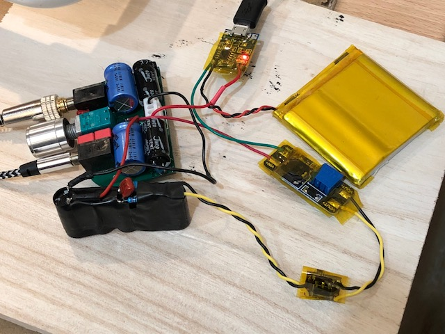

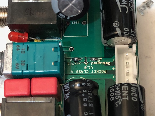

I just implemented the above diagram and it works well. I added a CRCRC after the cap Mx and before the amp. It can still play music even when charging via USB as shown in photo below. My charger module has just one connection for the battery and the output. The battery itself has the smart protection circuit built in. I am running at a full 18v Vcc to see how well this can play low impedance phones. I have also retrofitted the new resistor values for low impedance. It turns out adding a parallel 4k7 chip resistor to 1k makes it an 820R so you don't need to uninstall. I did swap out the 270R R5 for 220R though.

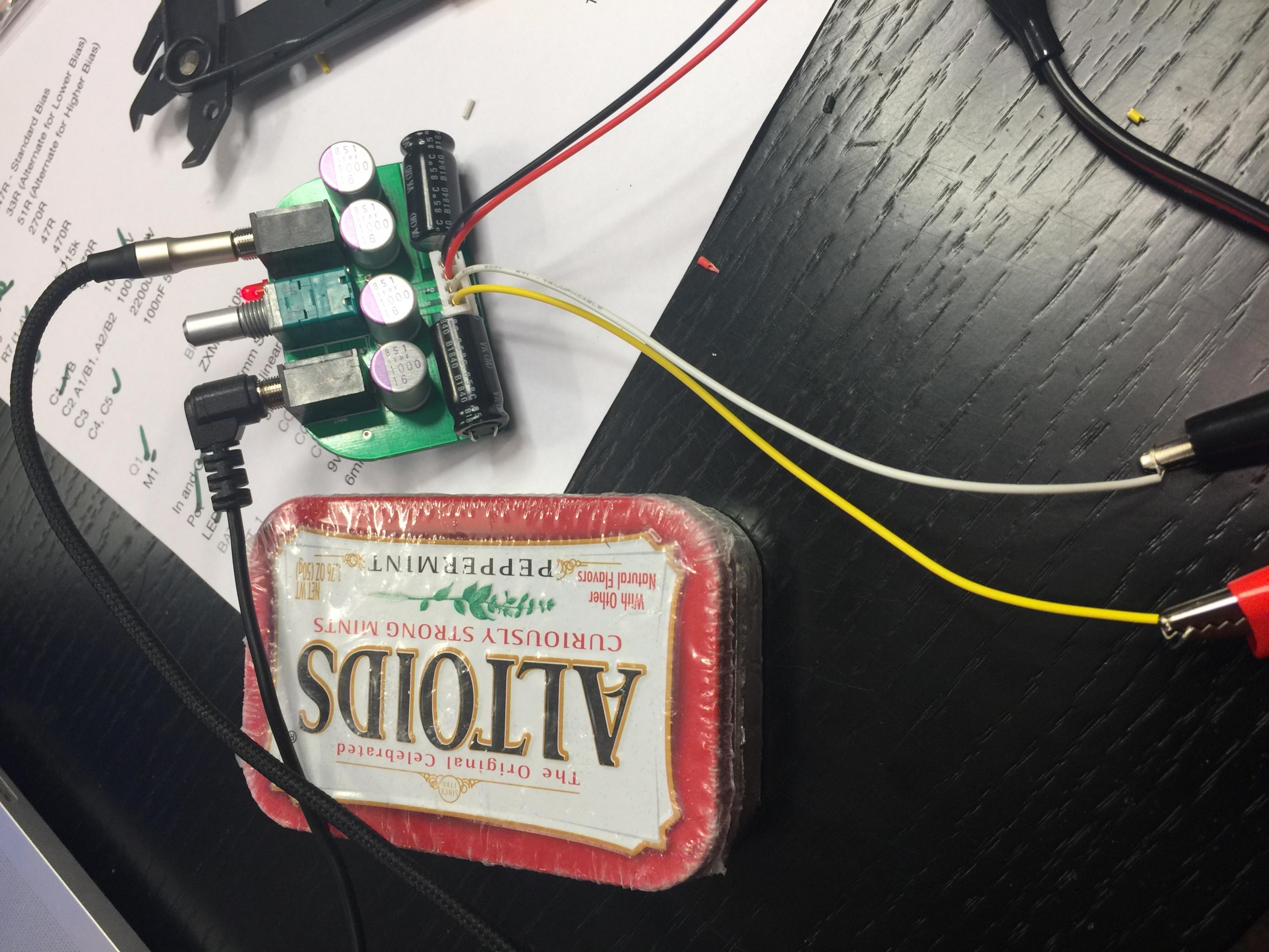

Here is closeup of the trace cut and the new solder pads added to go to battery and cap Mx input:
Here is testing the flat-pack for functionality before putting it in the case:
Here is the finished amp undergoing a charge and playing music at same time:
I don't mind opening the lid to charge. Having the power switch function to turn on/off the cap Mx is a nice touch.

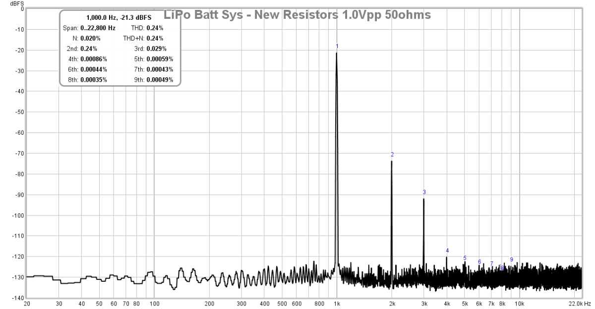

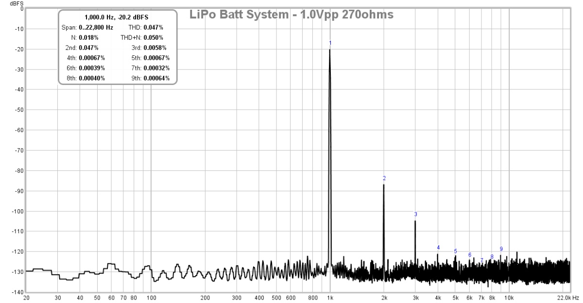

Here is FFT for 1Vpp itno 270ohms (0.05% THD all H2 and H3):
Here is FFT for driving 50ohm load (0.24% THD, and about same harmonic profile)
The DC step up and CRCRC combo is doing a great job with keeping noise to a minimum level, flat at -130dB.

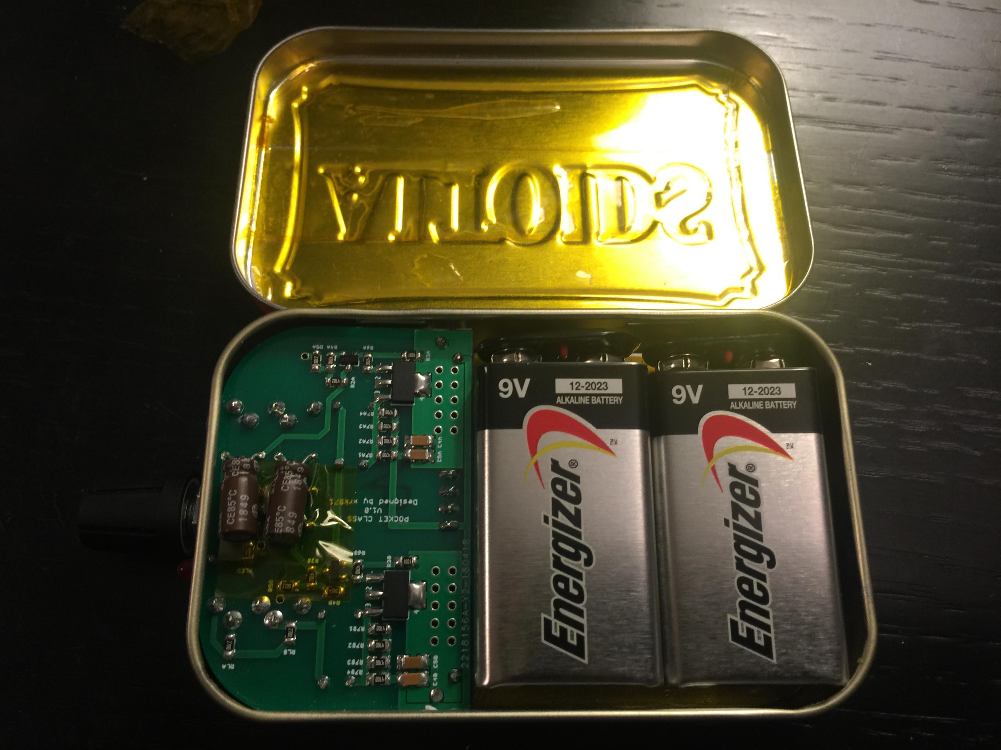

I finally built my PCA this morning. It took me a while to get BF862s, and then I went on vacation. X - I can't thank you enough for answering all my questions and posting the updated BOM to the forum.
I need to freshen my breath a bit to get rid of the mints, wire up the batteries (Running off two lab supplies for the moment), and punch the case.
I think it sounds great with a set of Meze Classics. I'm sure the lab supplies aren't ideal, but if it sounds this good in this situation, then I know I'll be thrilled with batteries.
As a relatively new builder, I found the most challenging aspect of the build to be the physical positioning and lead bending for the larger caps. Odd, I know. For the next build, I may try a hot plate, heat gun, or some other method for the SMD soldering, but for one-offs, I don't mind hand soldering. Fired up with great tunes in both channels on the first shot. Excellent thread to learn the aspects of the build! I read it end to end. Thanks to X and all those that contributed. It makes things much easier for noobs. A few glamor shots attached. I'll post again after I get the batts hooked up tomorrow and get the case punched etc.

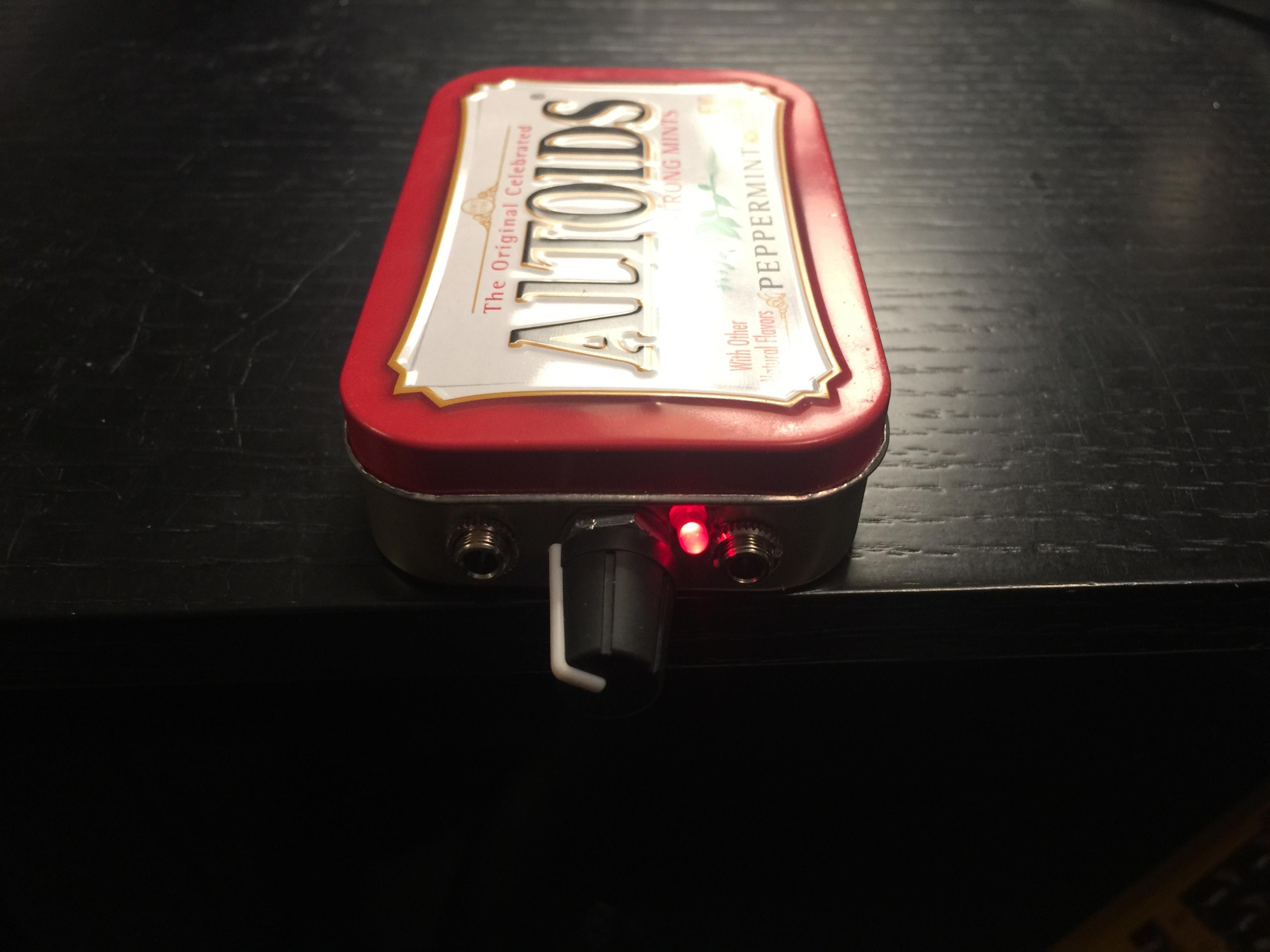

Listened a bit with the Meze Classics. Then, since this is for on the go, I tried a few sets of IEMs (16 ohm). They sound phenomenal. No issues at all with the lower impedance phones which is what I needed this for. Built using the same components in the BoM most recently posted.
Finished pics. Rechargeable batts coming later today, but I couldn't resist.
