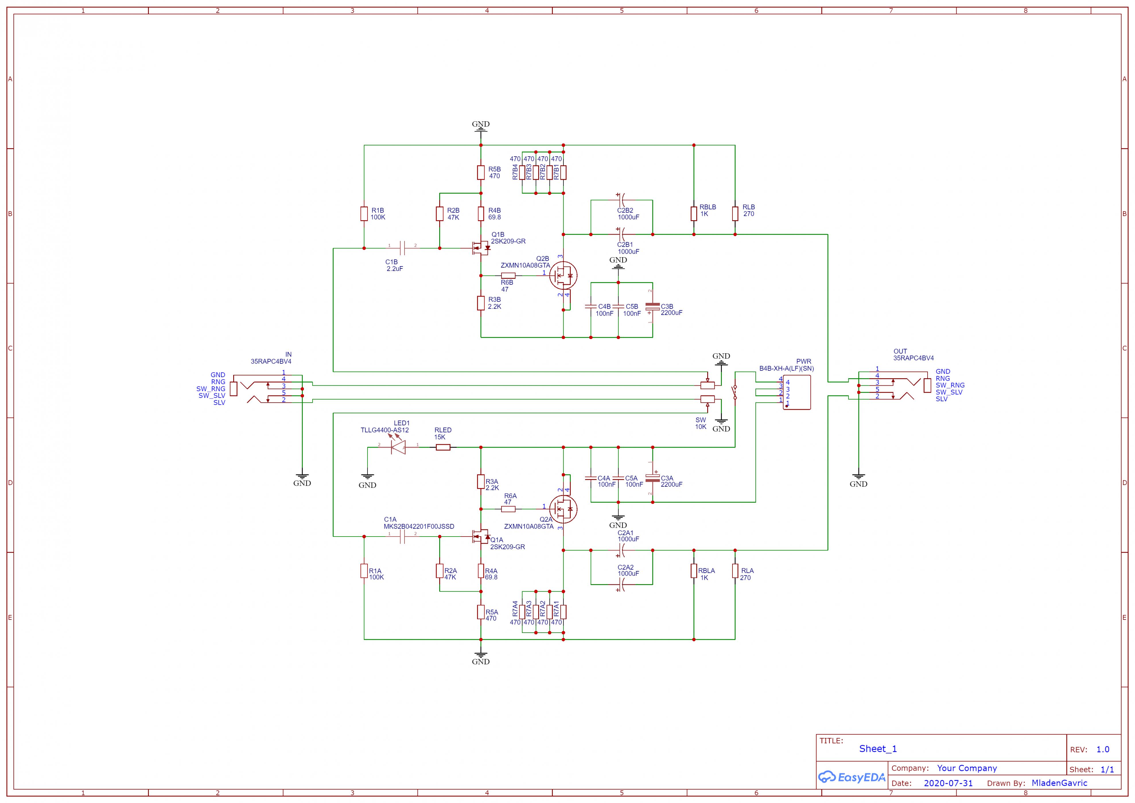

Hi X,
I TRIED to follow (noob) your schematic for PCA and the latest BOM but I don't know how much have I messed it up (I probably did something wrong).
Would you be kind to check it and correct it (or point me in right direction - I am more than willing to learn) when/if you have time.
Thanks in advance,
Mladen
Thanks in advance,
Mladen
Looks good to me. Your 2Sk209gr is an N-ch JFET. You have an N ch MOSFET symbol there by mistake. Not that it would matter. Regarding resistor values, if this is what you got from the latest BOM for use with 2SK209GR then it’s good. There are different values for 2SK209BL. You don’t need 270ohm RLA/B. That’s the dummy load of the headphone. The 1k is a sufficient output cap drain cap.

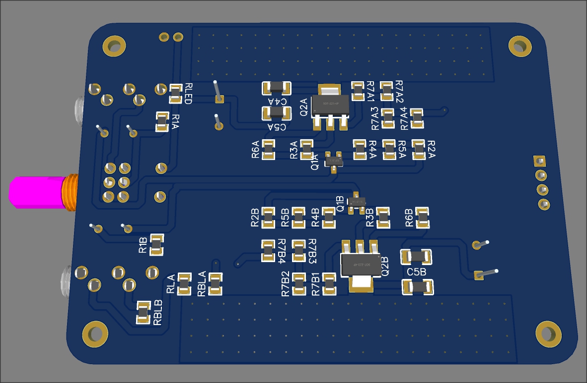

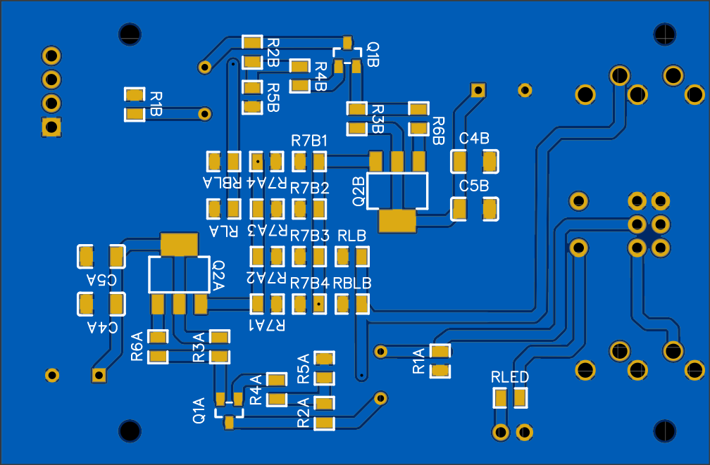

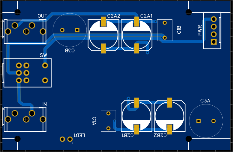

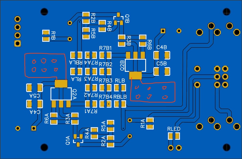

This is the layout I've done so far:
Thank you so much for a quick reply!
Note that the MOSFETs need extra copper surface area from pin 4 to dissipate the heat it generates. It makes about 500mW so needs a way to remove the heat. On my board, there is some extra copper to radiate heat away from pin 4 (the tab).
The four 470ohm resistors also make a lot of heat so need some space and room to breathe.
You can see the copper pad extended out from pin 4 of the MOSFETs that act as heatsinks:
Those copper pads connected to the tab of the MOSFET are at battery positive potential. Needs to be isolated from ground. Look at the rectangles with vias in them to thermally bond both sides of the PCB to increase thermal dissipation. Those rectangles with the holes are at +Vcc and act as heatsink.
Like this:

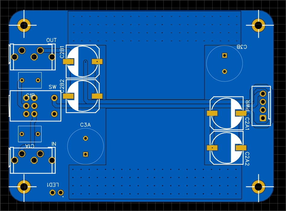

Your layout is concentrating the heat in the middle of the board with the 8 source resistors clustered need the middle. They will get hot. Better to spread them out, on opposite sides of board if possible.
Like this:

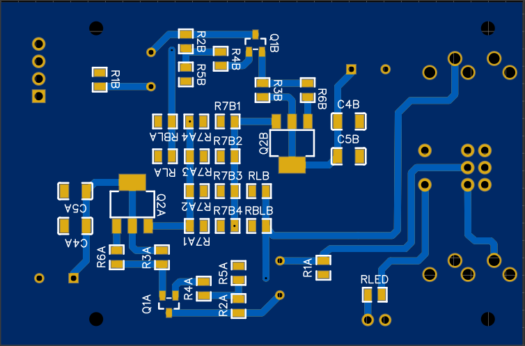

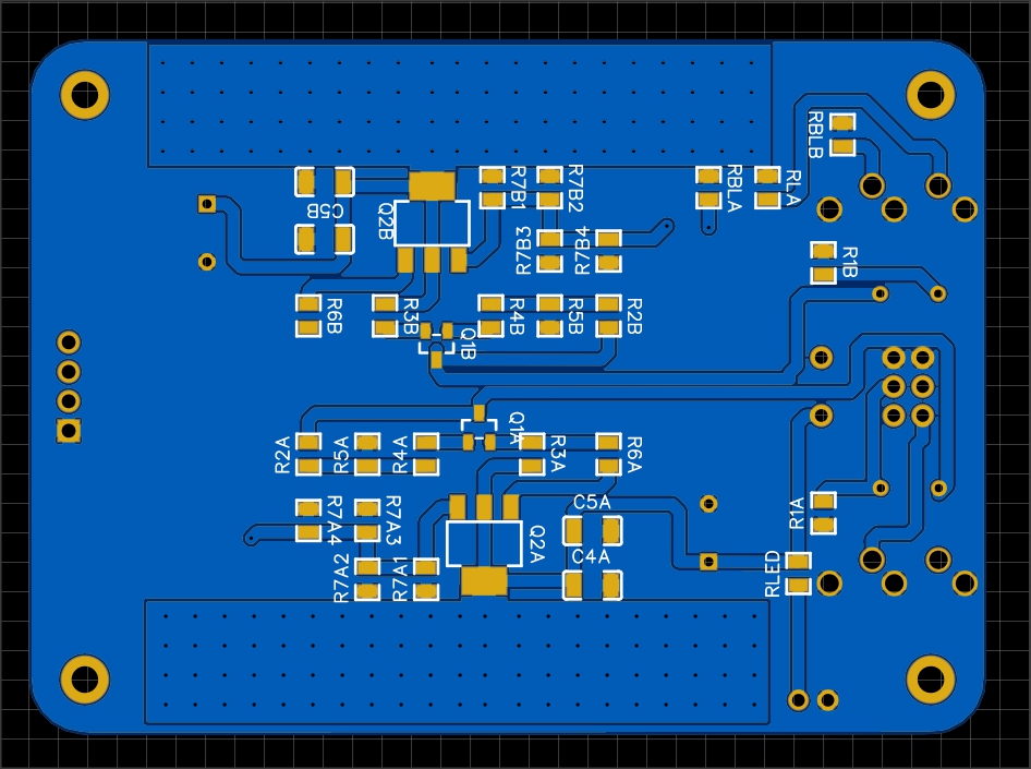

So, I rearranged components as you've suggested. MOSFETs and 470 resistors are on opposite sides of the board and I added copper pads (on both sides) for heat dissipation.
Is there anything else I've missed, or could've done differently?
Sincerely,
M
Sincerely,
M
The thermal pad look good for the mosfet. The spacing looks good for the heat. Probably doesn’t need to extend under central portion which could be via double plane ground to cool the 470R x4 resistors. Can you show schematic again? I don’t know why it appears R7A1/2 or R7B1/2 connects to positive rail on thermal radiator? Also, what is R2/4/5 doing?
R7A1/2 and R7B1/2 are close but don't connect to positive rail on thermal radiator (it's just a low screen capture resolution)
Here's the schematic:
