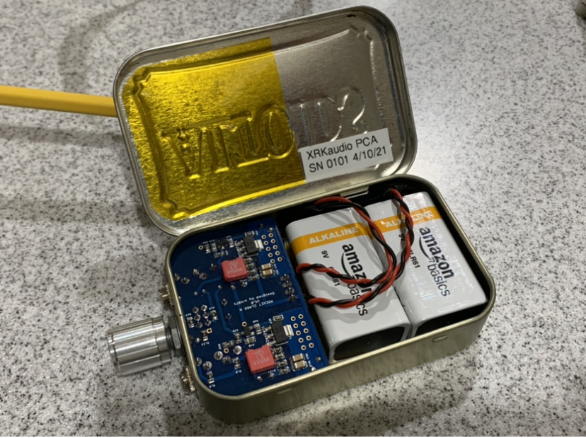

I'm trying to get some insight into how much inrush there is and how it limits it. It seems to work with your directives, but breaks down if I add 'skip initial operating point solution.' Actually it might be your sim that's the cause since that breaks down too.

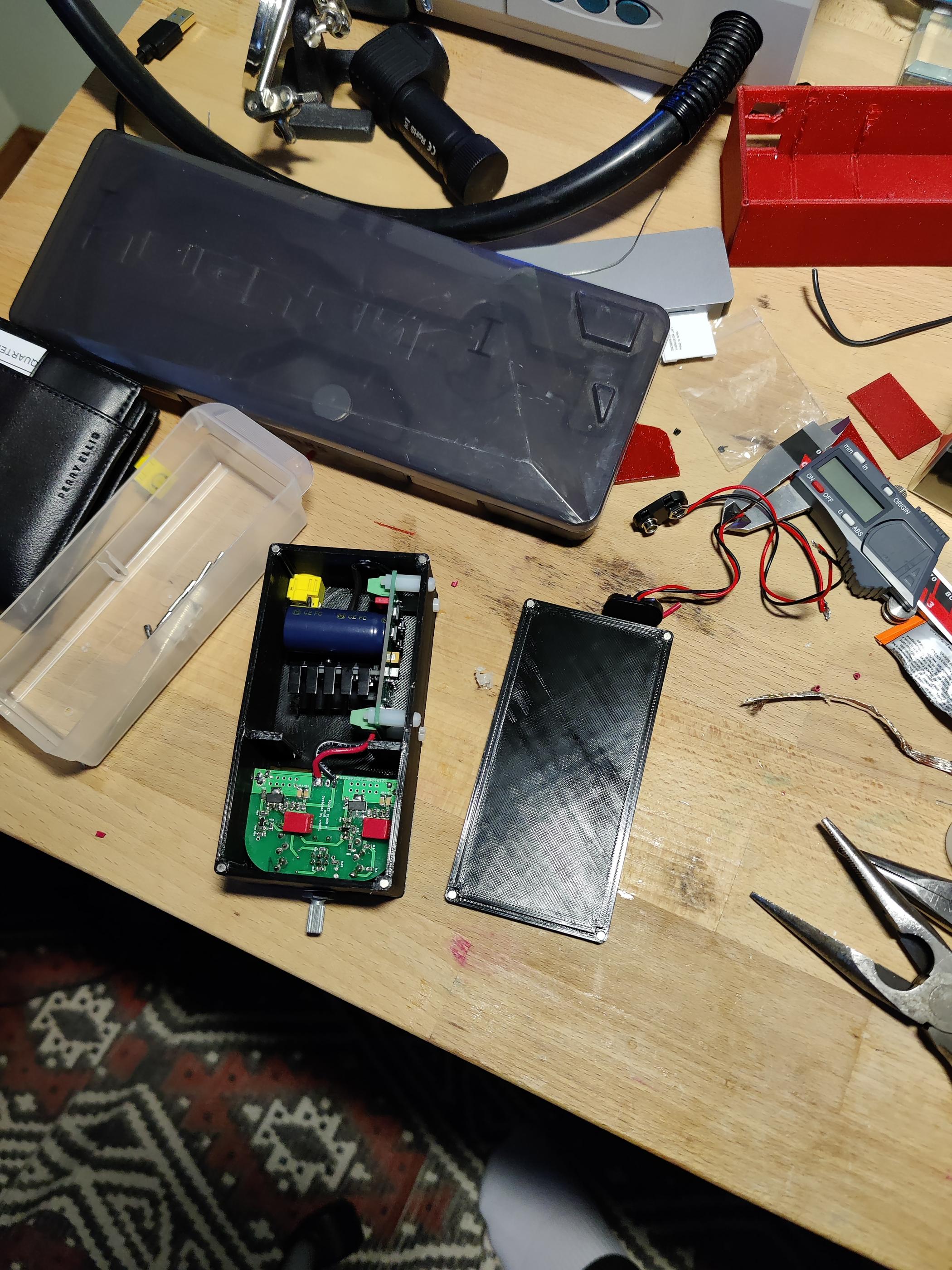

For those who want a box or just an enclosure case for the pocket amp to convert this to desktop use without much fiddling I have some STLs attached.
Basically I did this as I had a crap ton of Thinkpad power supplies laying around and I didn't use this amp portably as much as I thought I would.
Pocket Amp Desktop Conversion by hifiguy99 - Thingiverse
You just these three things:
- TPS7A4700 Ultralow-noise (4µVrms) Power Supply 1.4-20.5V,1A for Audio DAC (there is a ebay listing for this not sure if I am allowed to post it, specify you want a 17V output in the notes otherwise you can adjust it yourself)
- Thinkpad T510 Power Jack (used this one because it came with a screw out of the other thinkpad supplies)
- And obviously my enclosure
Optional:
3mm x 3mm round magnets for the lid. I found the friction fit is good enough but it doesn't hurt to glue in some magnets.
Some pics attached:

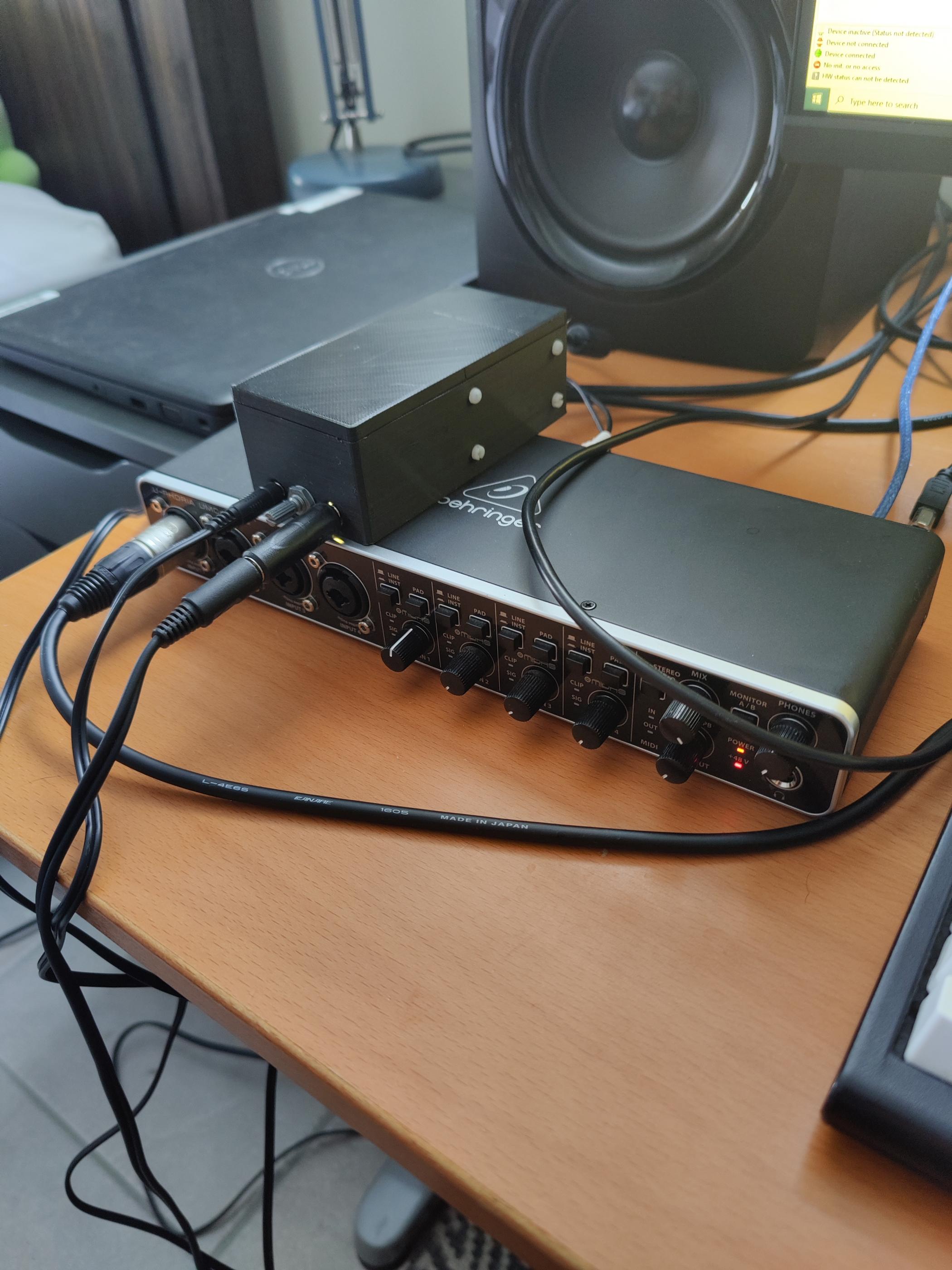

Neat idea HiFiGuy! The PCA makes a great preamp as you probably know. Makes any solid state class AB amp or Class D amp sound better.
Thanks for sharing your STL.
No Problem!
and to be honest I am using it directly to the HD 600s I have and it sounds good as is. Way better than the ****** headphone out on the Behringer interface I have. You did a good job on the PCA design 🙂
