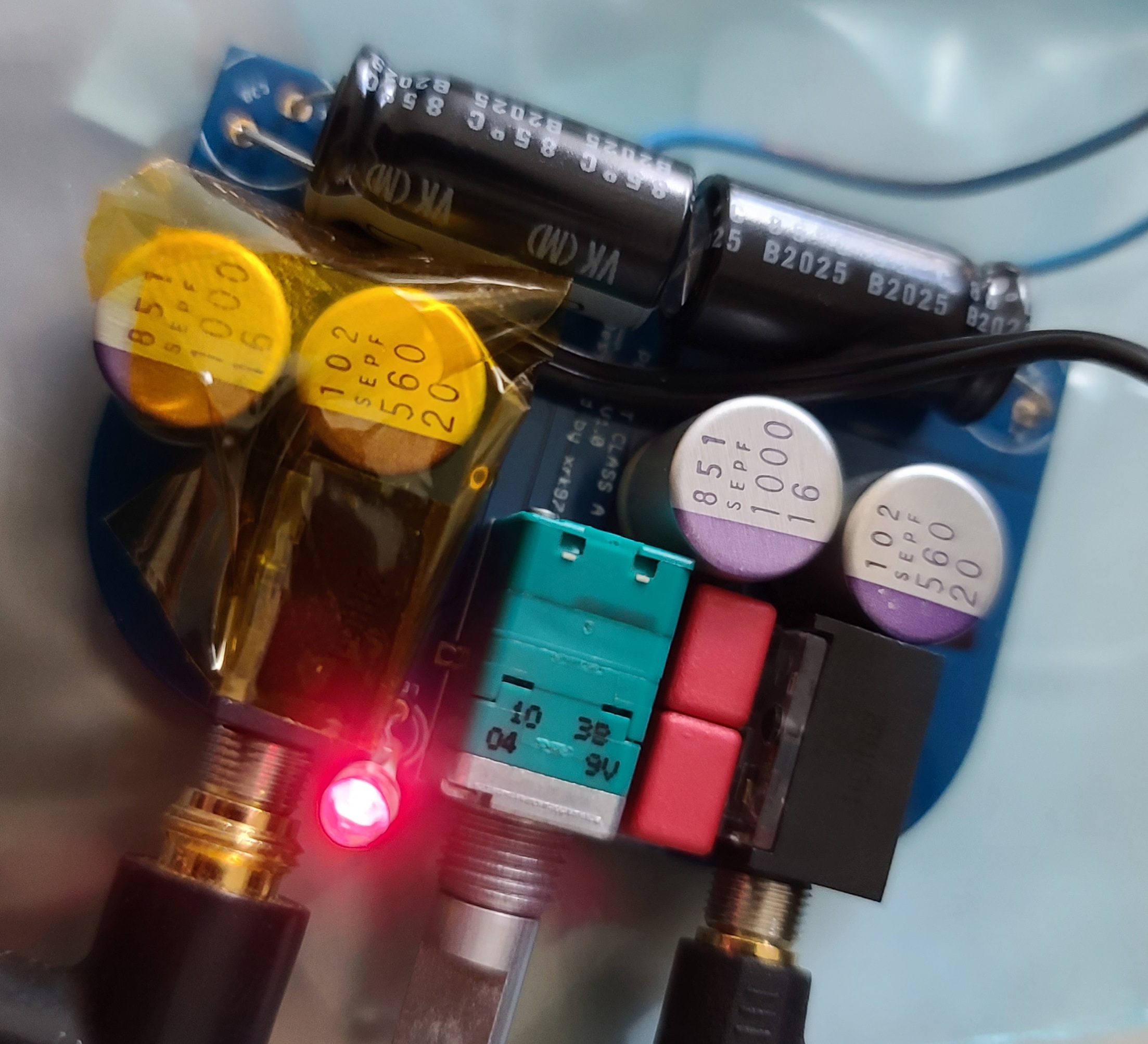

I made a Pocket Class Amp,
R4=51Ohms
C3A & C3B= 2200uf 16V Nichicon VK(M)
C2A1 & C2B1= 1000uF OSCON 16V
C2A2 & C2B2=560uF OSCON 20V
C2A2 &C2B2 bypassed with Wima 1uF 63V caps.
Input Power supply: Old linear Lab power supply set to 2A and 18V
the problem is that my whole board is hot along the edges (dissipating heat there), looking for the source of this heat, it seems it is the OSCON caps that are hot to touch. So much so that I can touch them for a maximum of 3 seconds. Is this normal operation? if not, where should I look?

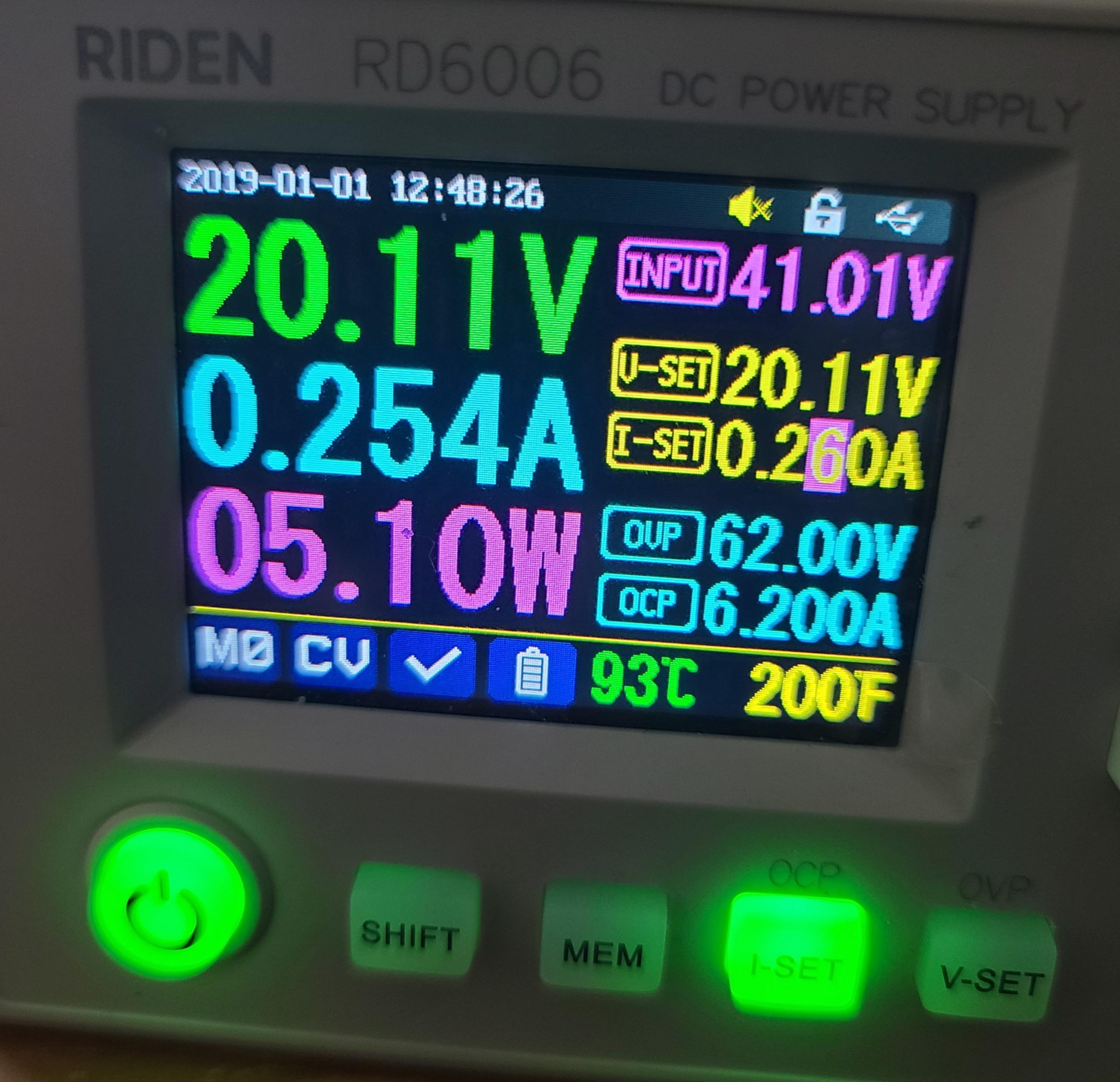

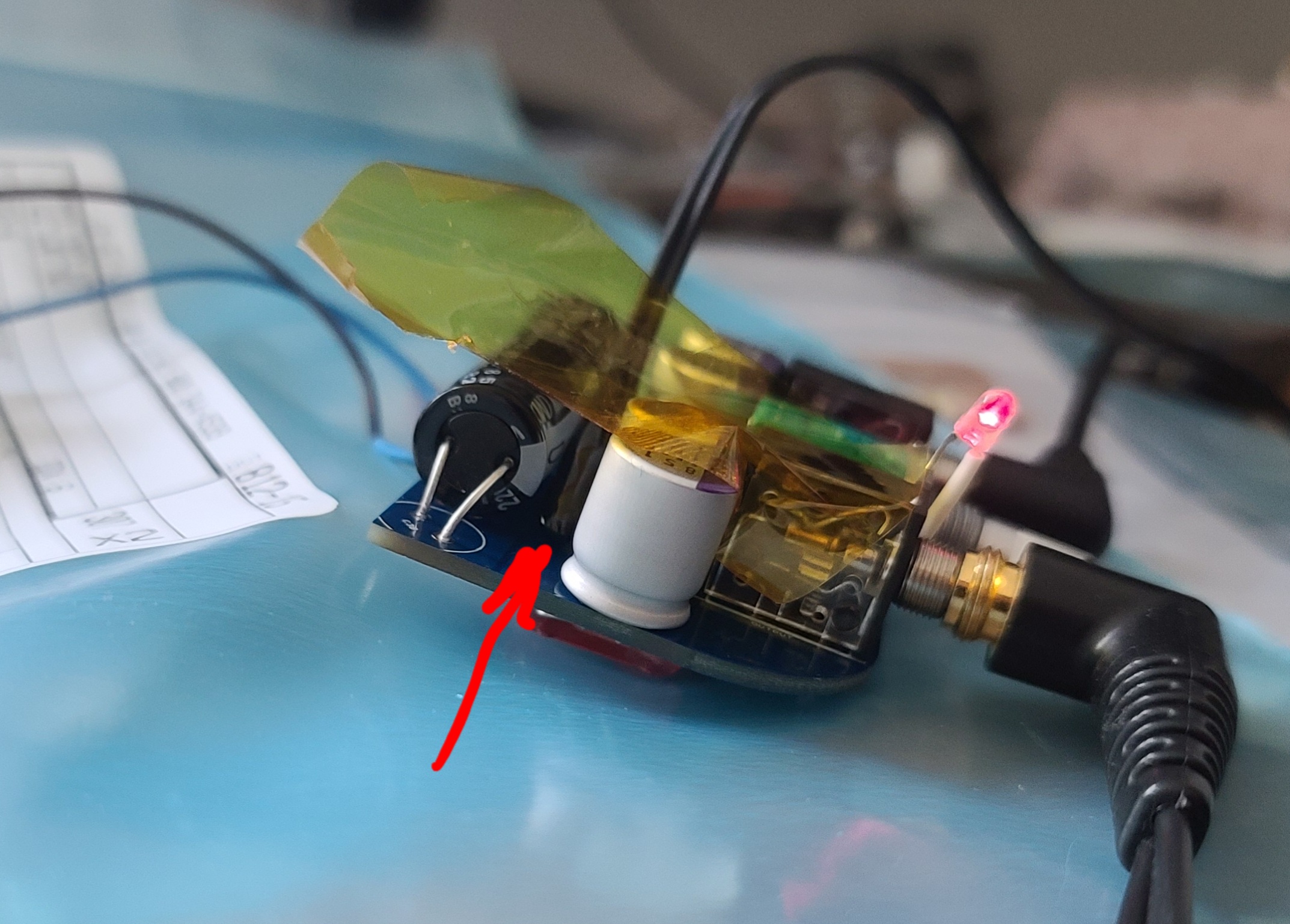

Sounds real good, this gem of an Amp. Thanks XRKAudio. I will try another configuration for better treble or I will just get used to the lovely sound this produces.
I did not know that I wont be able to edit my previous post in the future to add relevant info.
So here i am in the next post to my last one, with more info.
Here are some pictures of my setup having been running for about half an hour, crusing at 92-93 degrees celcius. Input voltage is 20 Volts. Current demans from amp is a 253-254mA
Is this a ventilation problem? I am netting 5 watts.
Am I doing something wrong? Driving Sennhieser HD 25 Limited edition (70ohm)
Can somebody show me how to do the maths? I am searching parallel to this thread and will post if i reach an answer.

Try dropping the lab supply to 16.5v. That’s about what it runs at with rechargeable 9v batteries. If you want to run it at 20v, you need the Desktop Class A (DCA) with TO-220 MOSFETs and big resistors.
This amp should not run more 75mA bias current at 18v. Or 1.35w dissipation per channel. The PCB was not designed to cool more than that passively.
What JFETs are you using and what resistor values are you using? This looks like 125mA bias current per channel used on DCA.
Adjust R3 and R11 (drop from 51R to 33R). That should help
