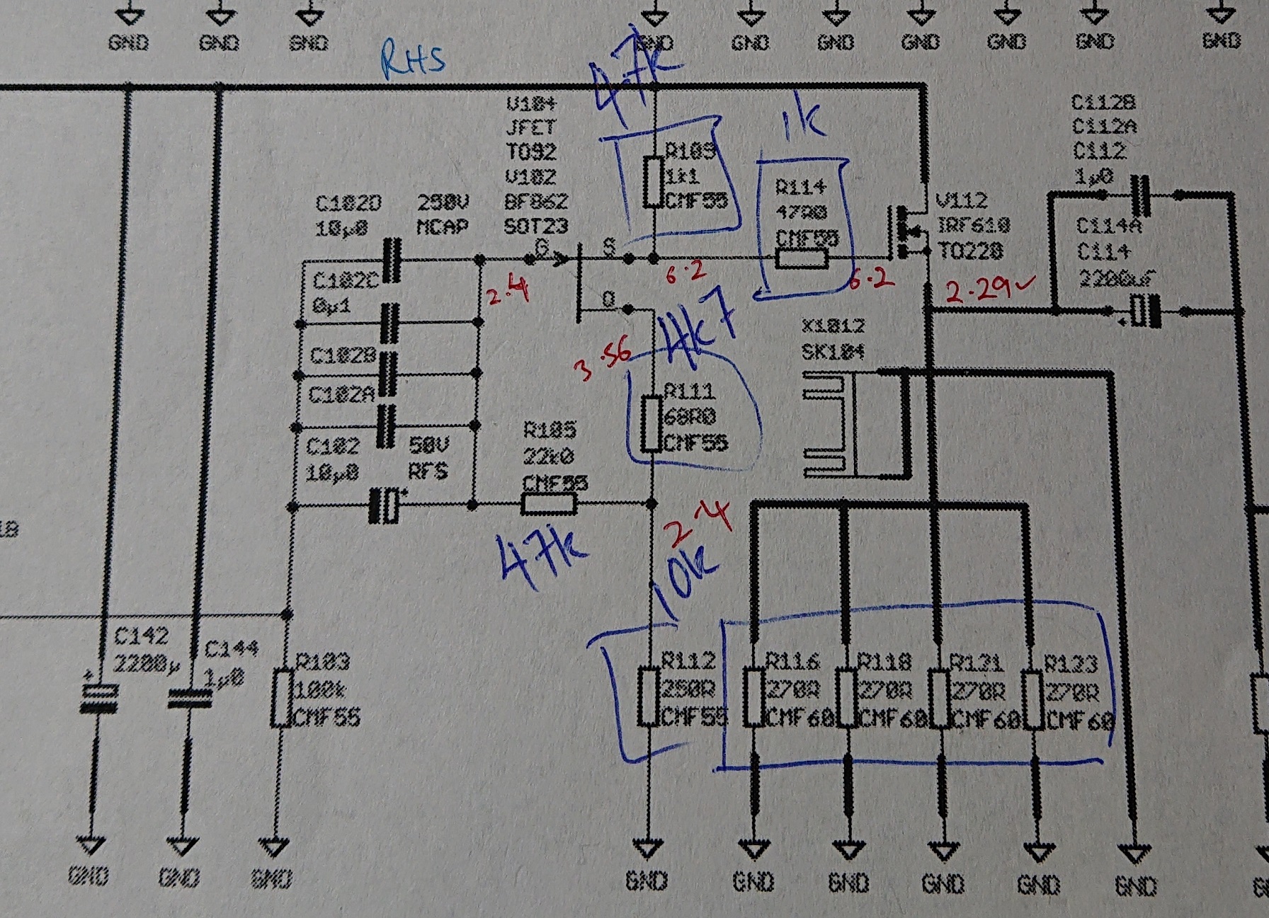

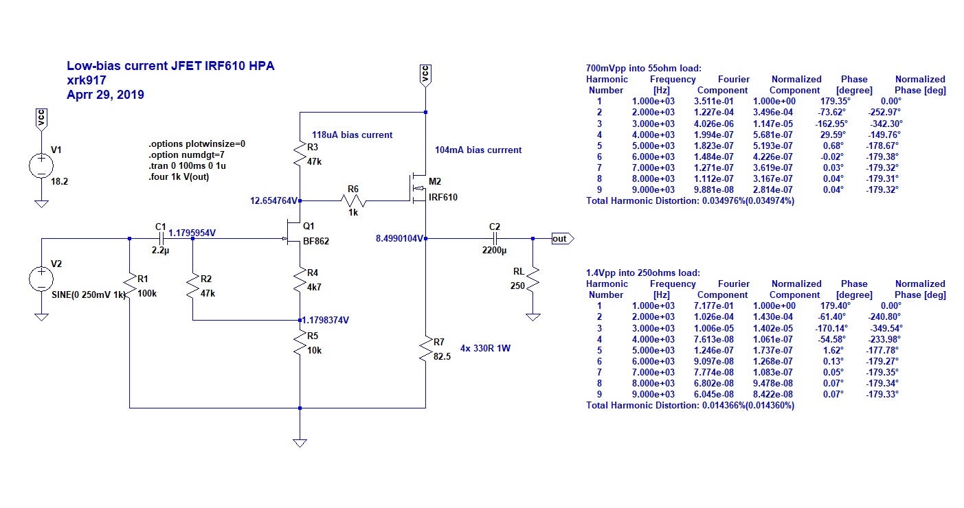

Built one with the low bias current values - the amp works (there's sound out), but when measuring voltages they seem all wrong compared the sim (https://www.diyaudio.com/forums/att...gb-bf862-low-bias-irf610-hpa-v1-schematic-jpg)
My Vcc is a hair above 18.2V (18.2x V) Not sure whats going on...?
Voltage measurements are in red, relative to gnd.
Looks like your particular BF862 has a lower Idss than one used in simulation. Let me think about it.
hmm those are from the same batch from RS which I've been using all along though. maybe I'll swap them out and see. I was a bit suspicious since it was running totally cold to the touch.

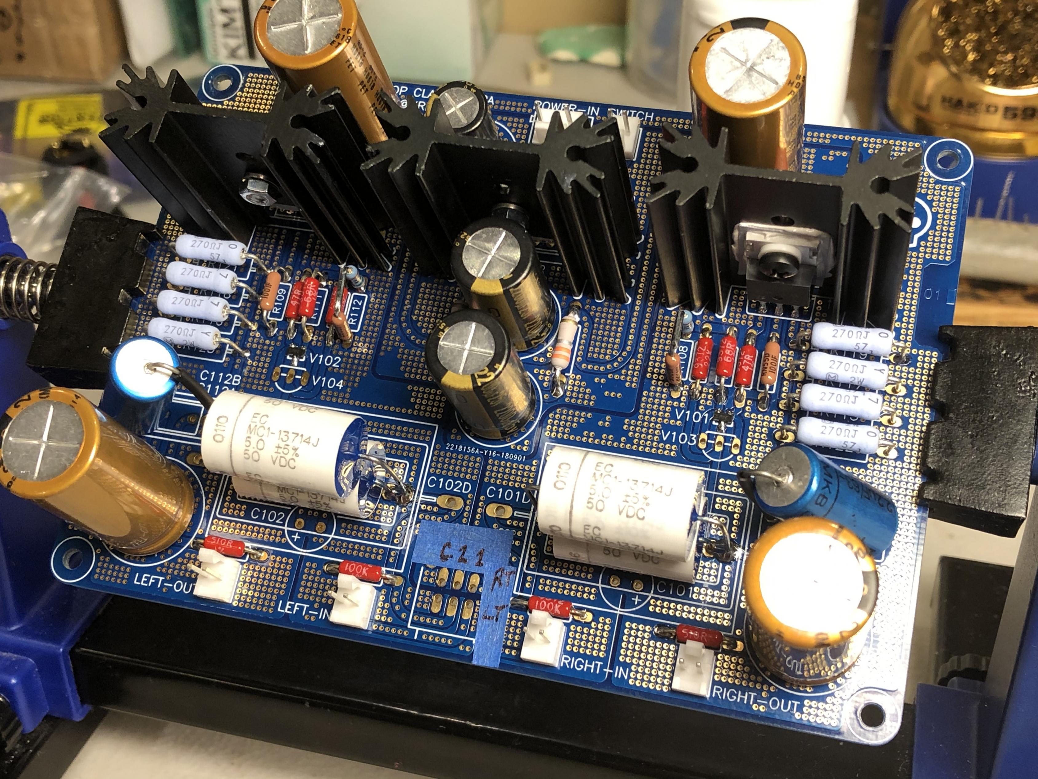

If you are a new to smd , it is better to take help from anyone who repairs SMD boards day in day out like those who repair smartphone , macbook etc for placing JFET on board .
I don't know where xrk971 has fabricated the pcb but they are absolutely top notch as i have used de soldering wig for many time for fixing my stupid mistakes but the board absolutely survived my awful torture . xrk971 always helps you if you have any doubt . Anyway never use Ruby con caps in output stage unless you want some harsh mid range . Vishay BC will give absolutely neutral sound but i will recommend Panasonic FC or Nichicon UFG for clean audio . Use at least 1% resistor from Vishay Dale to archive least distortion . As for film caps use any metallized film like mallory , wima or vishay Roederstein , my favourite .
I actually used every passive components from Vishay as they have excellent supply in india which i cannot say at all for panasonic and wima . I recommend to grab components from Digikey or mouser or farnell to ensure legit components. If you are using 10uf caps in input like Silmic II or Nichicon ues , please kindly give some burn in time before listening . Most importantly , never reverse the supply rail , it will blow your first mosfet in no time .
