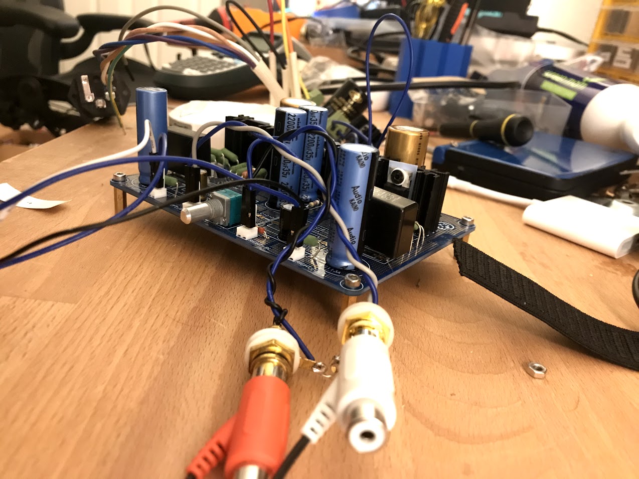

Hey XRK - just wanted to say thanks for the awesome project. I just finished the build and can't wait to start cap rolling. I put my last two matched 2sk170's in and it sounds glorious.
