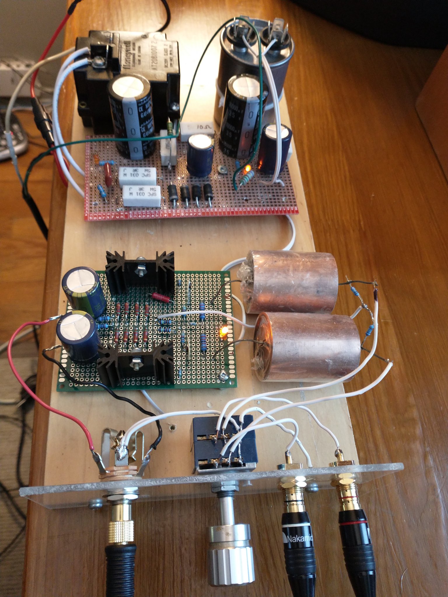

I built this up on veroboard with 2sk209gr as in the above schematic with a linear power supply. Sounds fantastic on my Grados! Very smooth and natural. Not quite as musical and nuanced as my much more expensive and complex 4p1l tube amp, but very good indeed. Thanks for sharing the design. Notice the gigantic 4.7uF Obbligato Copper input caps left over from a tube amp build.

Fantastic plank amp! That’s how most of my amps look. 😛
Glad that is sounds great. It works superbly as a preamp as well. Those caps are superb looking. Probably cost as much as BOM of one of these amps to build.

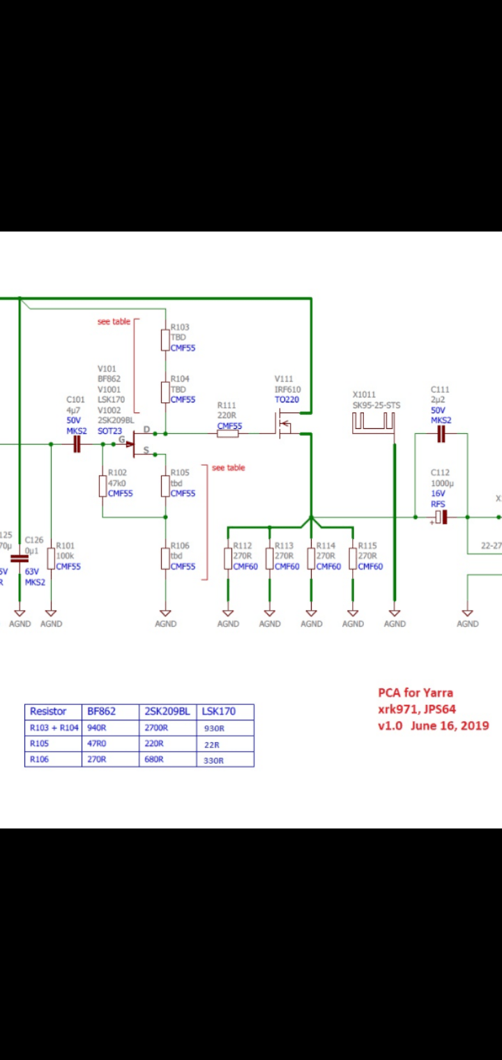

I want to build this amp as a standalone device. I decided to use 2sk170, based on this schematic and using resistor setting from this post
https://www.diyaudio.com/community/...or-melbourne-db-group-buy.334457/post-5898779
The question is:
1. Is the value correct for 32 ohm headphones?
2. What is the output impedance for this particular setup?
3. On the description it says that R102+R104 = 2K. That means 1K each, right?
BTW, am using cap multiplier on this thread.
Thank you

The schematics says R103+R104=930ohms for 2SK170BL. That means the sim equals 930ohms not each. So 900ohms plus 30ohms, etc… in series.Hi X. Thank you for the reply.

It will work for 32ohm headphones but that is the limit for 125mA bias current. Change output cap to 2200uF for 32ohm load.
Output impedance requires a simulation but from memory I seem to recall it’s in the 3-5 ohms range.
Can i increase the bias to 150mA to lower the output impedance?The schematics says R103+R104=930ohms for 2SK170BL. That means the sim equals 930ohms not each. So 900ohms plus 30ohms, etc… in series.
What is the effect 150mA bias to the harmonic distortion?
Am planning to use 2 transistor CCS, is that change the harmonic distortion?
Thank you
The increase bias current will decrease harmonic distortion of driving lower impedance loads. Adding a CCS will significantly reduce distortion.
Yes, input cap is as big as you want. But 2.2uF film cap is about perfect. I sometimes use 10uF Silmic II but that’s just convenience and they are tiny. Output should be at least 2200uF electrolytic and bypass with a 2.2uF film cap.

If you have the same resistor network the gain should be the same. Gain is (R103+R104)/(R105+R106). The JFETs may have different Idss and that may affect the relative volume between the two amps. But if you match Idss between both amps. They should have same gain.
