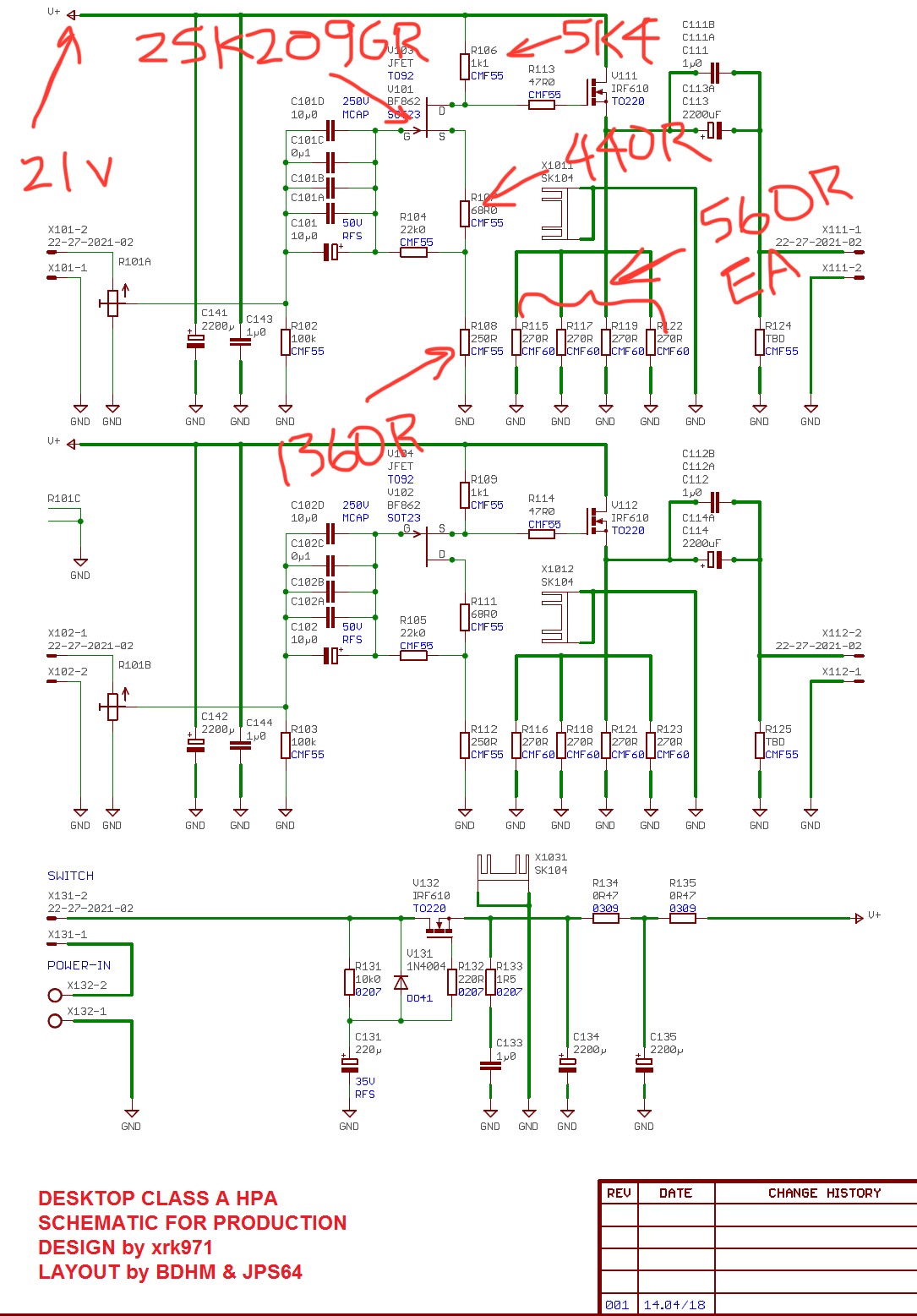

267 ohm resistors will work ok for R124 & R125, right? It's the only value I can find the Dale CMFs in at the correct size & wattage. I'm using Mouser BTW, but I couldn't find anything even in the right neighborhood at Digikey.
Also I can't find any 1W (or greater) CMFs between 260-280 ohms for R115-119 & R121-123. I found some 2W 270ohm in the Vishay CPF (flameproof) series. Does anyone have experience using that series of resistors in audio circuits? The specs line up as good or better than the CMF series; I just want to make sure they don't sound like crap for some reason.

The four 1W res on source of MOSFETs are important to use good quality 1W metal thin film. Don’t use metal oxide thick film, or carbon composition, or wire wound here. I would avoid “flame proof” typically is a power resistor and might be inductive or high distortion. Try to get close to 270ohms does not have to be exact.
All the resistors in the audio path to the JFET and above and below the JFET should be metal thin film as well. Even cheap no name (sky blue color) metal thin film works here.
The gate snubber on the MOSFET could be Takman Rex carbon film for smooth sound.
R141-134 doesn’t matter what kind you use.
Ahhh yes the schematic. Thanks! I see they're all paralleled now. So if my math is right (1/Req) = [(1/R1) + (1/R2) +(1/R3) + (1/R4)] we're wanting an Req of 67.5 ohms, right?
There are CMF60s available in 221R and 330R.
So 2 at 330R plus 2 at 221R gives Req of 66.18R. Which is 1.95% lower than nominal 67.5R. Is that close enough? But then am I going to be dissipating more than the rated 1W through the 221R resistors? Hmm I need the voltage across those resistors to calculate that. Do you have a rough idea xrk? (or exact, I'm sure you have this in SPICE)

Just get the Dale CMF60 in 280ohms (4x per channel) and you will be fine. 1200 in stock at $0.47ea.

Ahhh they're 0.1%! That's why they were'nt showing up for me. Wow I would've thought a 0.1% would be more expensive than $0.47.

R131-133 are usual small 1/4w. R134-135 are 1/2w or 0.6w as they are there to dissipate some power for the CRCRC.

1) It looks like BF862 is an obsolete part. Is there a good replacement, and if so, what is it and does it require and resistor values to be changed from what's on the BOM?
2) for V111 and V112, the BOM shows IRF610 in Column 2 and IRF512 in Column 3. Does that mean either will work, with the resistor values on the BOM? It looks like IRF610 is currently available, while IRF512 is obsolete.

Over in the Yarra thread we discuss the new setpoints for PCA/DCA daughterboard (same as DCA in principle) either the 2SK209GR or 2SK170BL(available from GB’s) or LSK170BL. Those 2SK209GR’s are Toshiba JFETs and still available.

Use IRF610 or Fairchild FQP4N20 work very well too.
