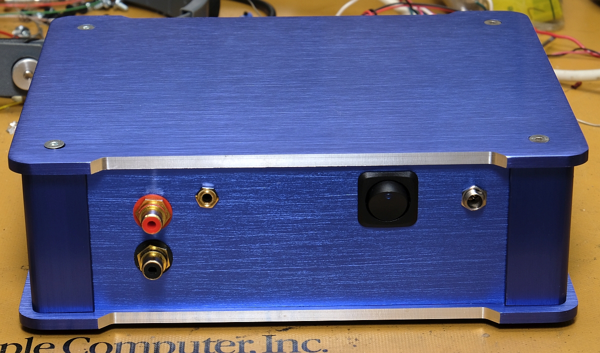

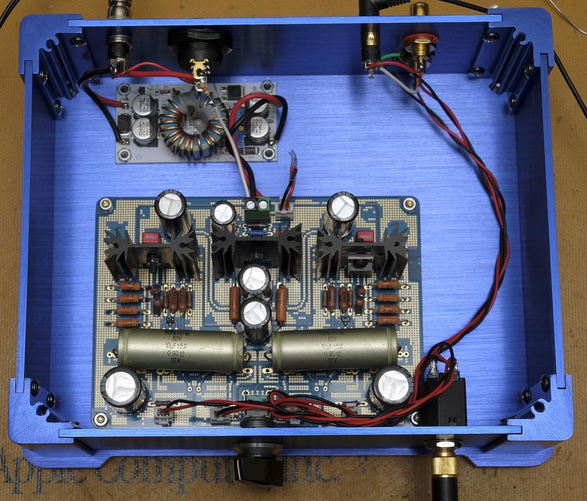

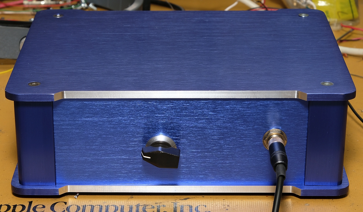

Finally finished my take on the DCA. A very nice headphone amp. I really like the ease of construction and the "frameable" circuit board!!
Thanks X and JP.

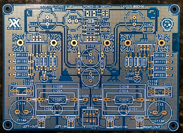

Here is the new board with silkscreen properly applied.
attachment.php
2mm thick FRP with 2oz copper traces (double thickness) and ENIG finish. Of course, covered with vias to connect both sides together for equivalent 4oz+ thick copper traces!
