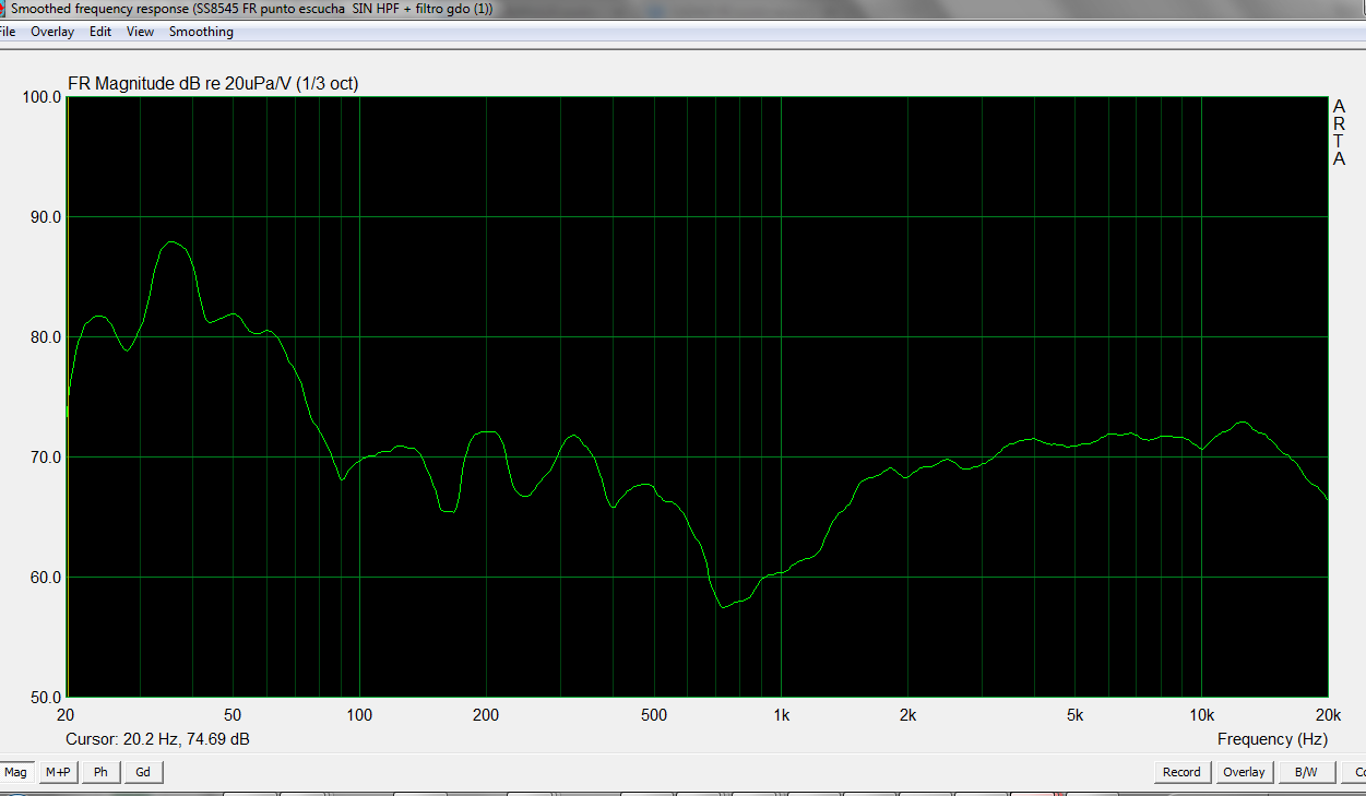

Ok, but this is what you already sent, frequency response data not the impulse file, thats why i could not open it in Arta...😀
Btw, if you export that way the phase is not exported. You need to do the following before:
* Set Minimum phsase in the View menu
* Check you select M+P (magnitude + phase) down at the left of the screen
* This will create and .frd extention file you can change to .txt to upload here.

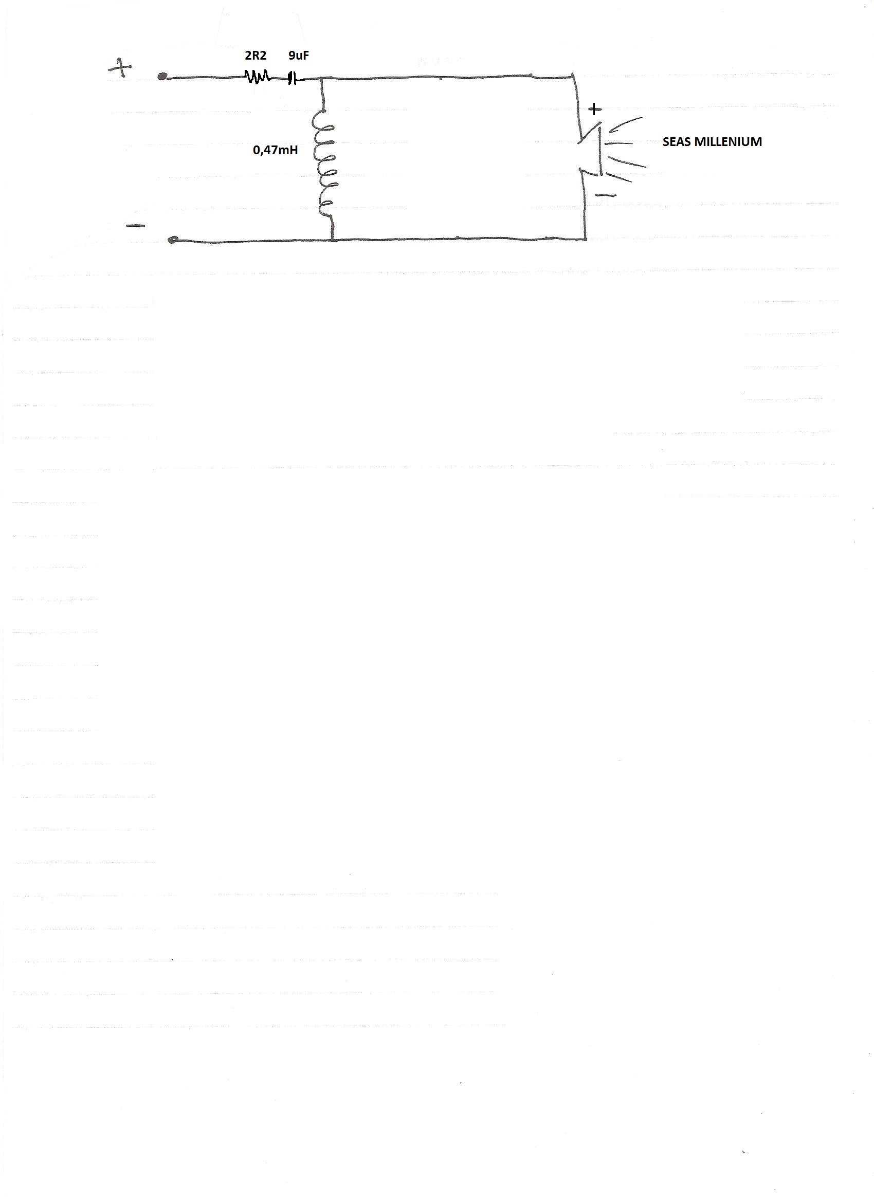

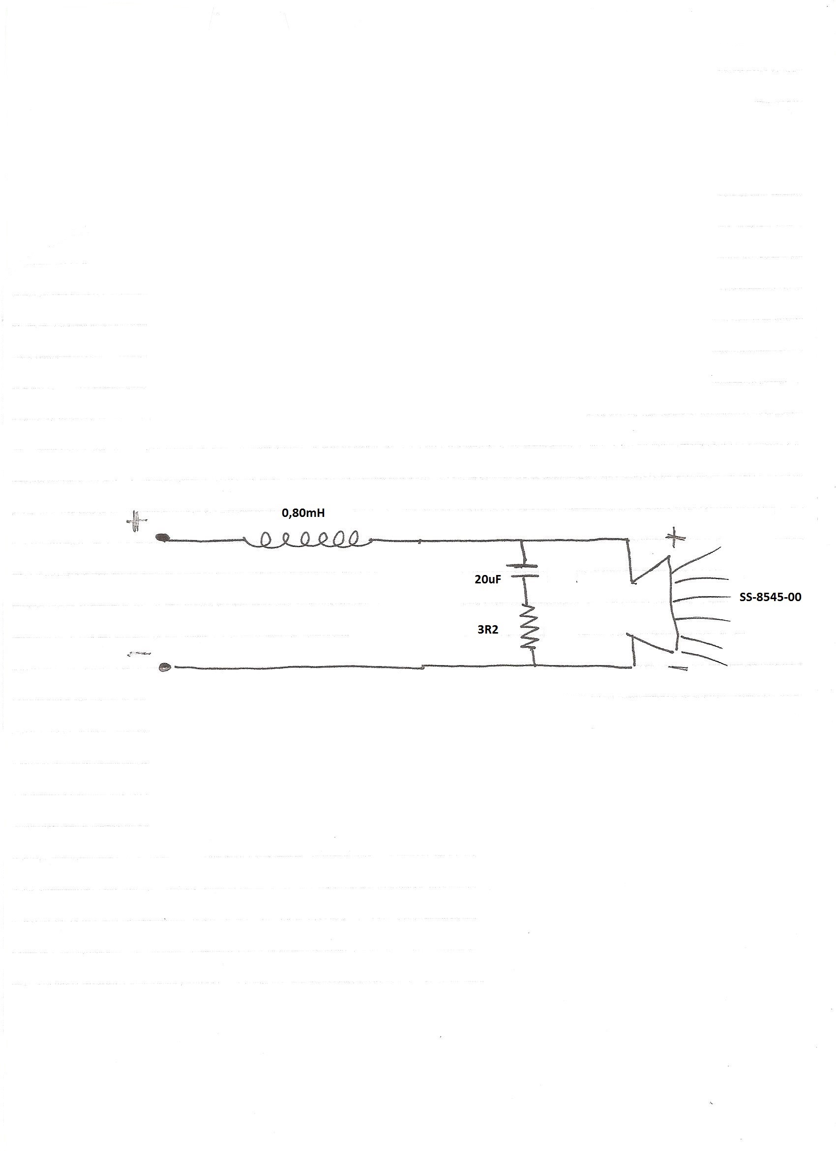

What do you think of this schematic received in a Spanish forum?
As commented before main issue is you cannot cross the SBA so low without getting a big bump under 100hz because of its impedance peak at resonnance.
Forum can't accept to attach *.frd files, I send as zip.
Ok, i could download the pirs from dropbox.🙂

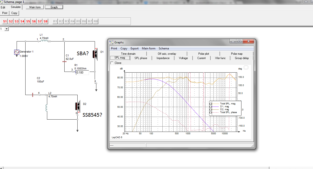

I think this might work without redesigning the whole thing.
May be removing the atenuation on the tweeter will help too...🙄

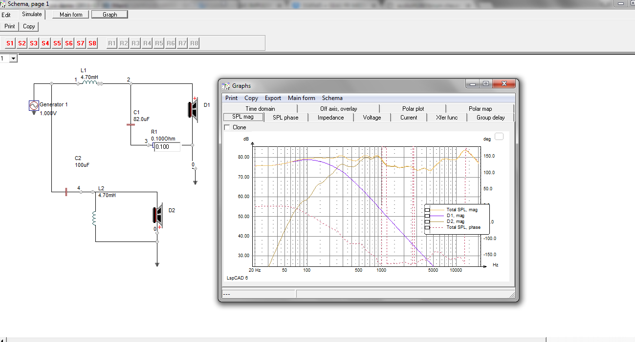

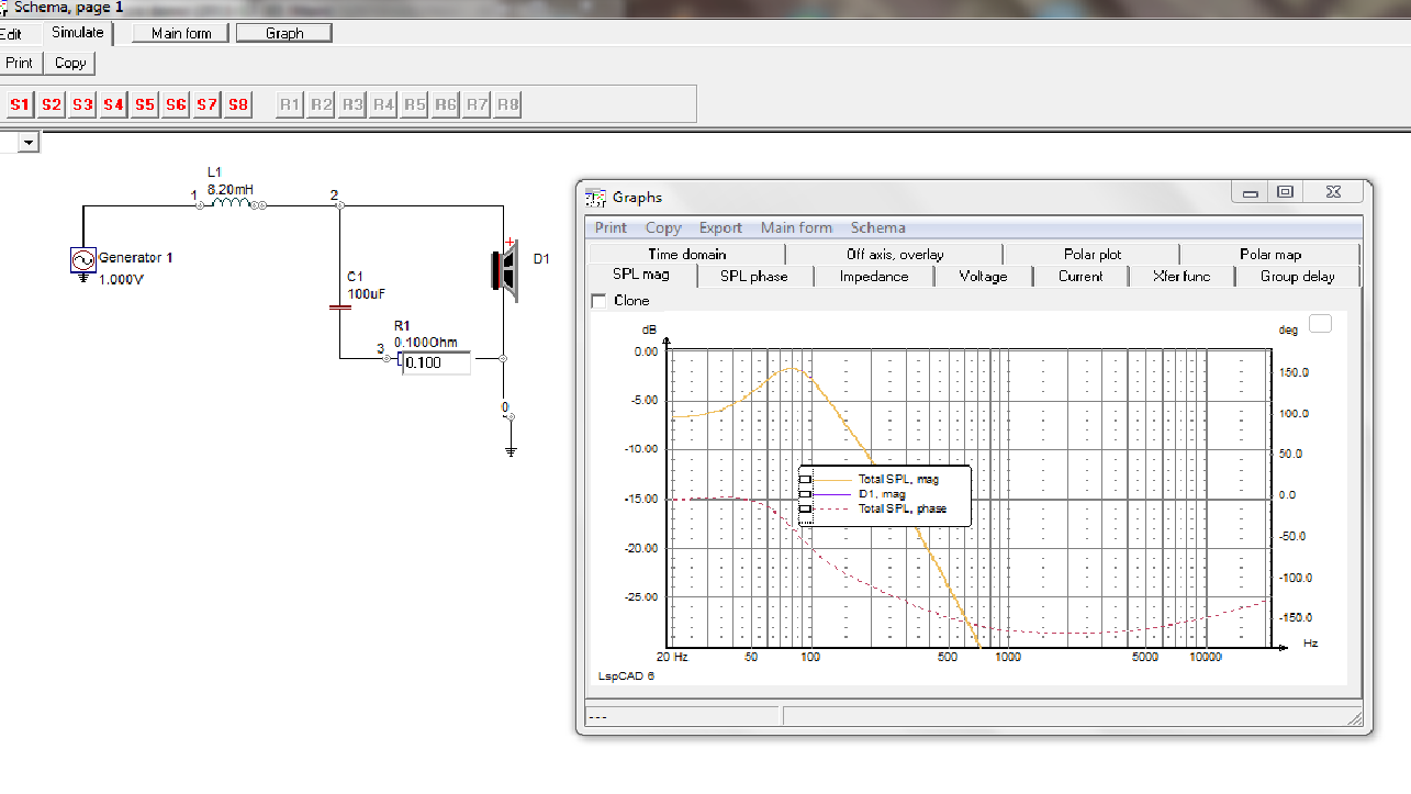

Sorry if i did not make myself understood... D1 is the SBA and D2 is not the SS but the whole monitor.
I have loaded for D2 the FR of the monitor from your measurement and as you can see the tweeter is present.
If the monitor should be redesigned all 3 drivers with the full xover would be necessary.
