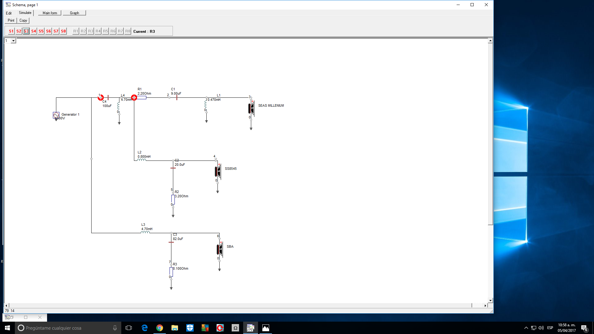

Is this file about measuring, simulating, designing, or simply about messing with wiring ?
This is the filter?
I didn't pretend to make a full sim, nor indicate a specific wiring, just testing a cross over idea, letting you play with it your own way...
Anyway you can test this wiring, or also wire it as a standard 3 way:
Low pass the SBA
Low pass + High pass the SS
High pass the Seas.
Regarding polarities, check by yourself what measures best, there is nothing sacred in any schematic because we are not on a full sim and do not have the full data we need to do that.
😀SS polarity out of phase, Seas and SBA in phase, tweeter attenuation is 2R in place of 2R2.

No no no, there is no database no datasheet nothing but selfmade fr and impedance measurements of your own stuff...
As you are still learning to measure i asked you a very minimum set of these data assuming the risk and trying to make guesses for the unknown data.
The problem seems that you have not caught the idea of what the design process is about, and i dont see how i can help you to progress further...

Sound is like graphs, too much lows, right mids and weak highs.
Sounds better with SS in phase & the SBA out of phase.
Now I will try the Seas without attenuation.

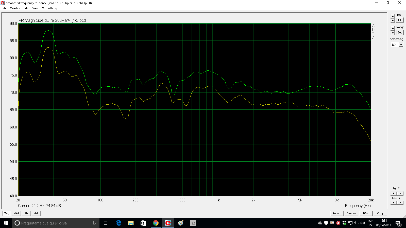

If you change polarities, check your curve first. If the curve is right, don't change polarities. The curve is right, so...
Also avoid make assessment based on the typical "the curve is not flat so the curve is wrong" argument.
This is a room curve, not an anechoic free field response.
A flat room curve at 3.5m listening distance is total nonsense, though some DRC users seem to have acclimated themselves to...😀

Better tweeter without attenuation, mids & highs sound is beautiful.
What is the curve like? Dont assess with the curve only, nor by listenning only, check both...😉
See the difference with attenuation (yellow) vs no tweeter attenuation (green)
