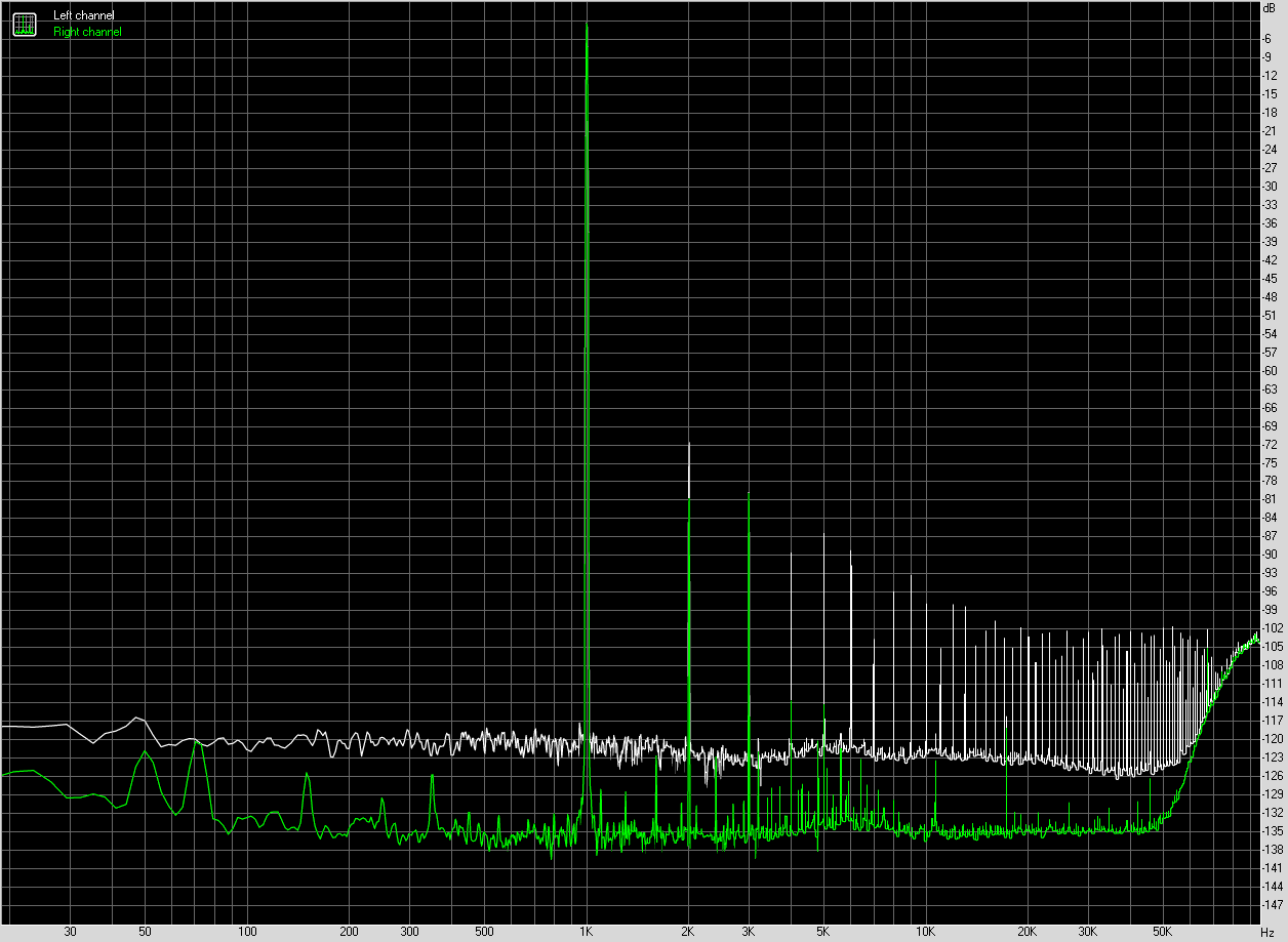

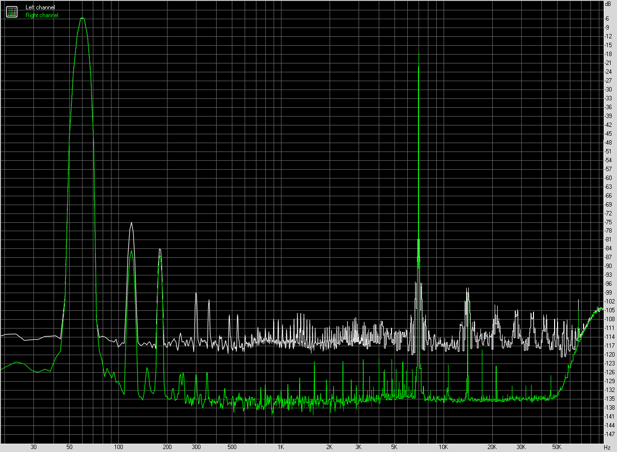

I'll take a look. Do you wish to get something like this?
1792's filter option
No 🙂 I want whatever results when 1792's datasheet-specified filter for slow or fast is selected. I'm hoping that "slow" will improve time-domain performance (hard to tell w/o impulse test). Also 1792 allows software to turn digital filter off, as prev. suggested, so one can use external DF. This should be interesting as one may be able to NOS it.

Yes, a lot. What would you like to see on them? The hard part is the noise which changes in time. It may be due to temperature change even if it's a few degree change. The current setup has some THD present and is very quiet. If I wanted to get very good results on paper, I would stick to the original topology. Too bad it does not sound good.

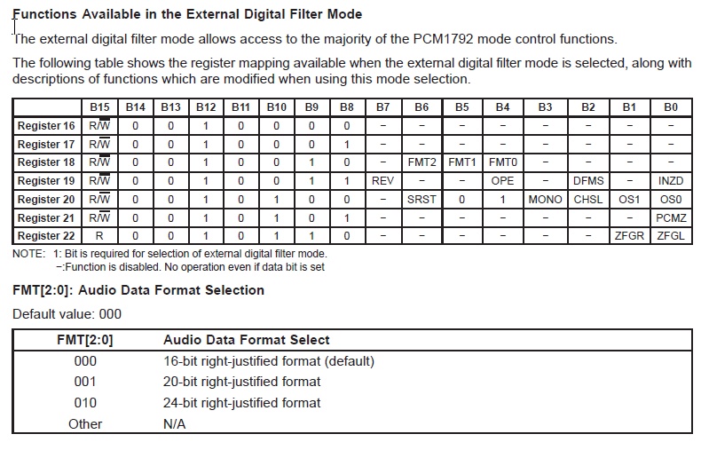

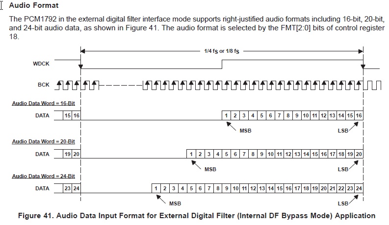

Digital flter can be done turned off. Problem is data format which must be selected after.
"The PCM1792A in the external digital filter interface mode supports right-justified audio formats including 16-bit, 20-bit, and 24-bit audio data".
CMI8788 chip supports only I2S format for audio digital data. We can not use this CMI chip with PCM1792 with disabled internal digital filter in pcm.

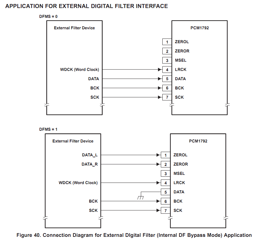

You're wrong. It's the format for the digital filter. If you disable the filter, you use external one. There are:
- WDCK (word clock)
- DATA_L
- DATA_R
- BSCK
- SCK
And the format you've said is used for the filter, not the PCM1792 data source. These are different lines. I see no problem.
PCM chip needs to be "feeded" by right-justified audio format only with disabled internal filter. I think.
CMI chip can not feed PCM chip with this format, CMI not supports right justified audio format.

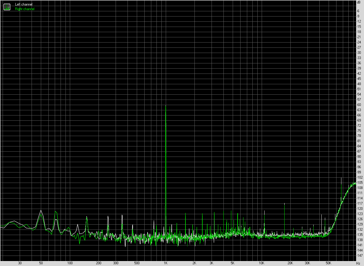

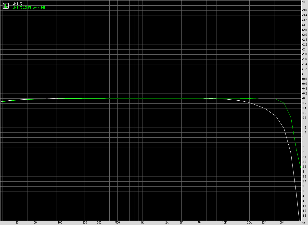

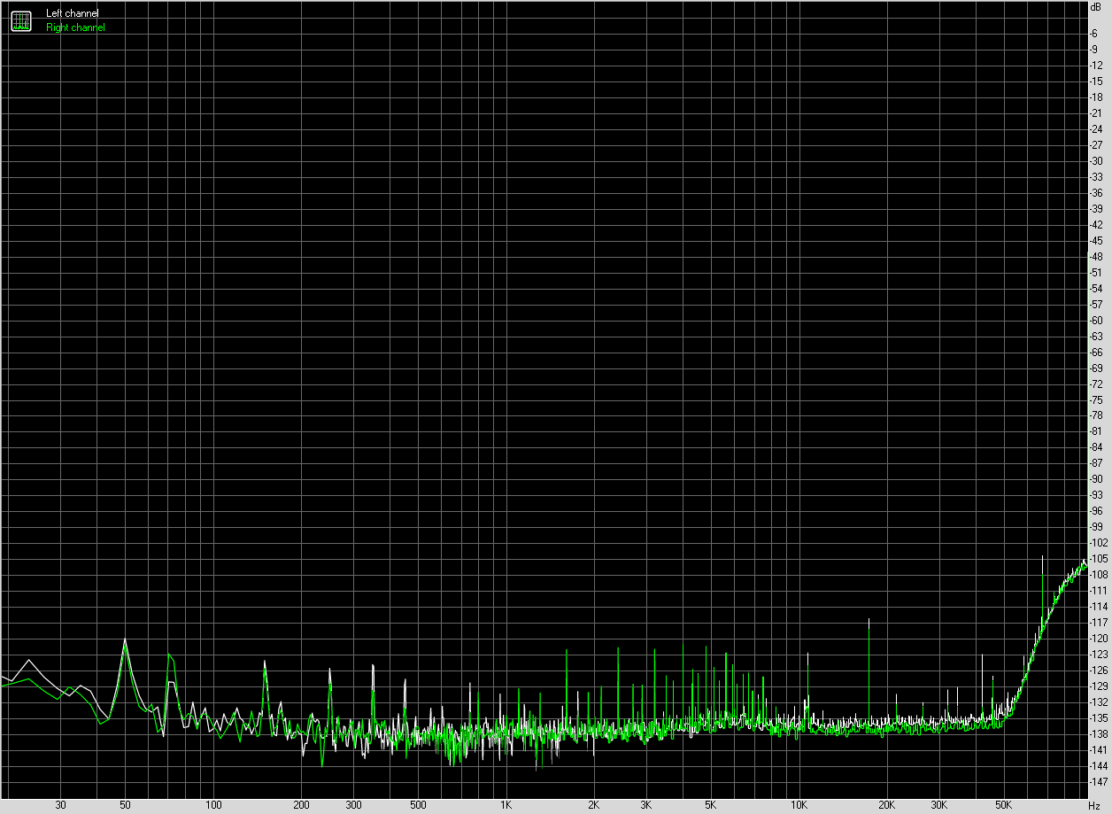

How big and which type I/V opamp feedback caps do you recommend? Stock are probably 2.2nF. Changing this value causes small audiable changes. I tried also removing this caps and leaving only resistance. Lower capacitance casuses noises level to increase and introduces larger THD. No cap means THD in whole measurable spectrum (<96kHz). Increasing cap value causes also THD increase, especially 2nd and 3rd harmonics.
Due to lack of caps of this type I use through hole ceramics, 2x1nF. Still noise level is higher and I think the opamp become a little unstable. What's your experience in this matter?
Added pictures: left channel uses new feedback caps. Feedback resistance 250ohm
This situation happens when the TPA is set for higher gain. Way to deal with it is to not use the gain. Strange, I modify only the I/V section and tried this with 2 different opamps. The same results. The feedback capacitor should match the output capacitance. AFAIK the PCM1792 has the switching frequency of a little more than 400kHz. The current opamp is set to filter ~300kHz. In one application I had the filter at 21kHz. Didn't sound open and airy but wasn't very bad.
