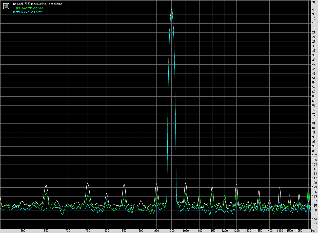

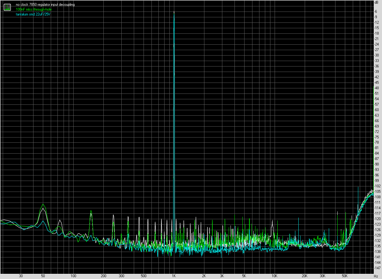

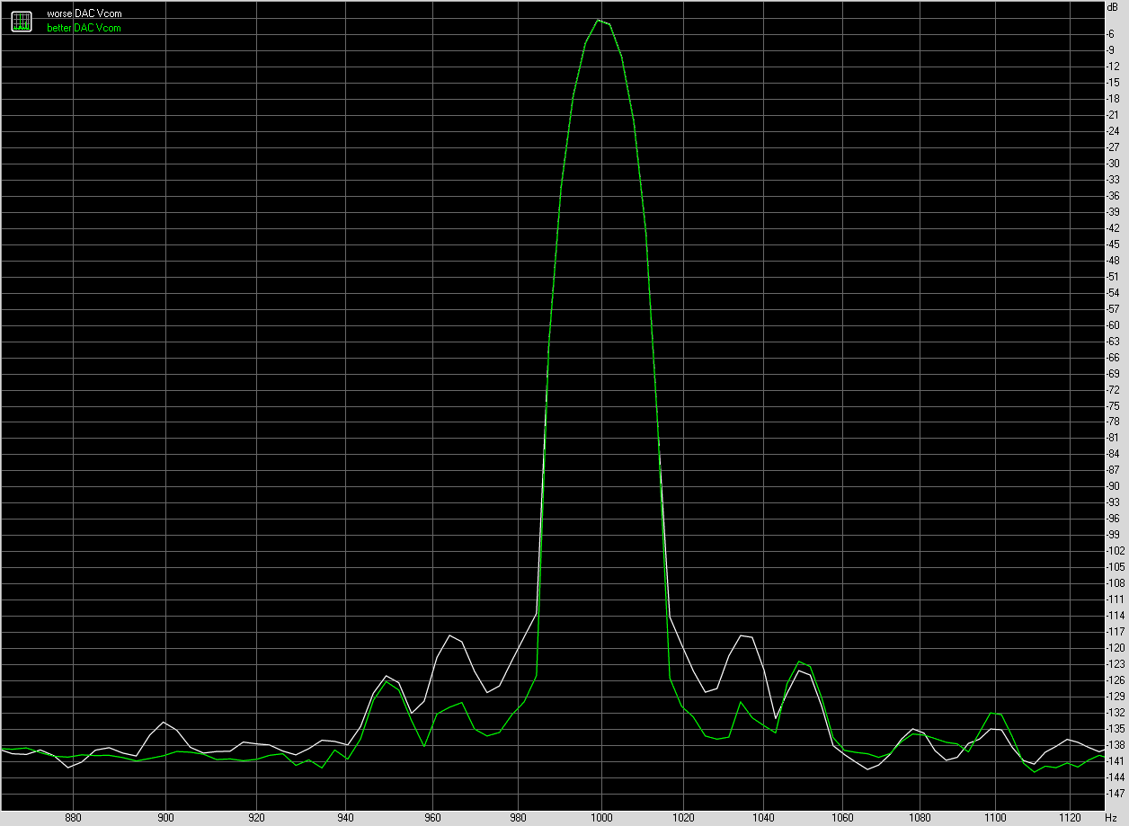

Take a look at the measurements I took today. I usualy had 100nF, I removed it and the sound was awful. Added tantalum, still fresh. The difference is measurable.
Which cap are you talking about?
Some reg. designs use BOTH (small and large value) caps per their datasheet suggestions (if the above is for LM7805, are you using datasheet suggestions?). Parallel the two and listen/measure. Or try the default 0.33uF per Fairchild PDF.

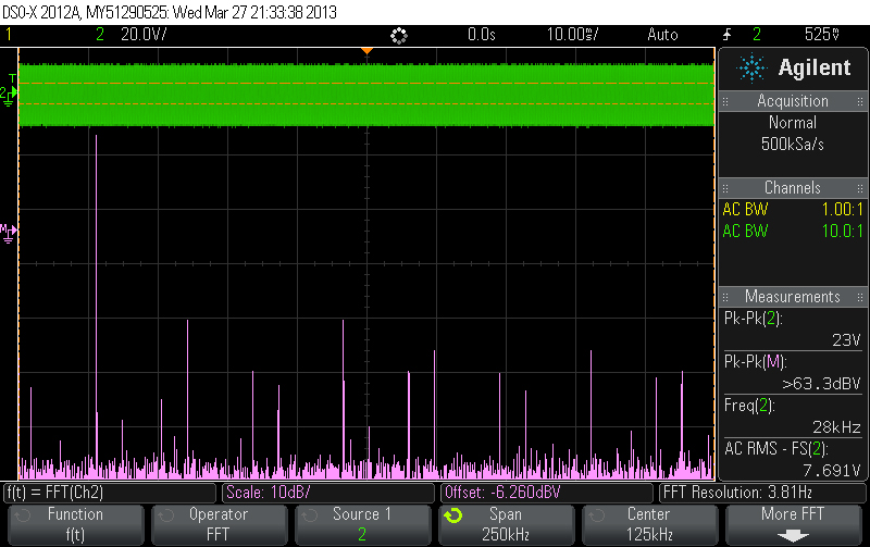

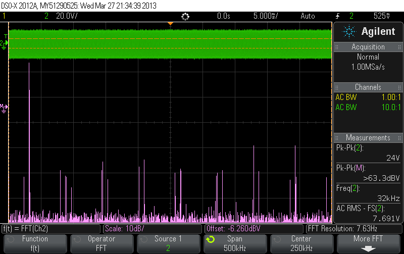

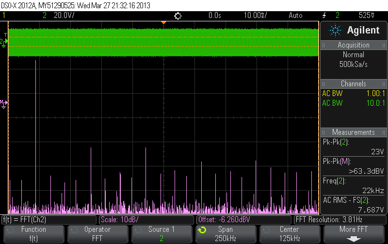

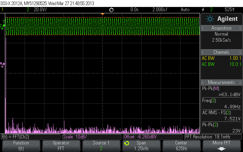

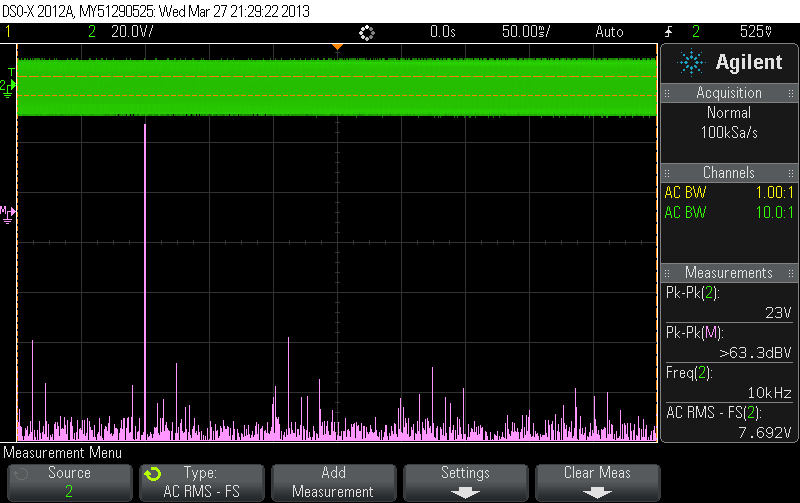

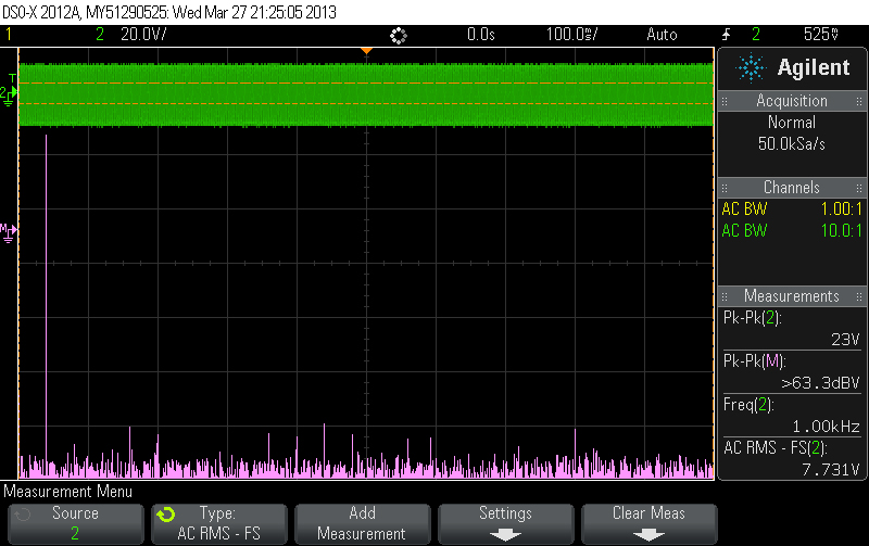

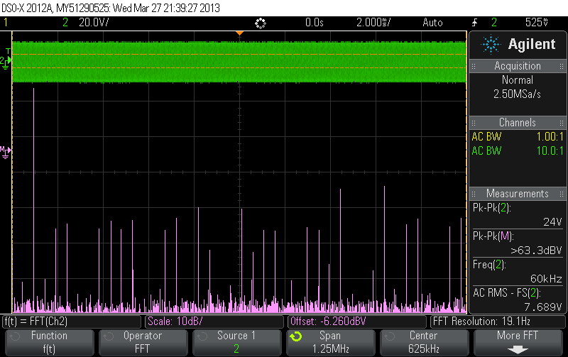

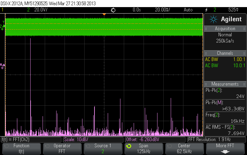

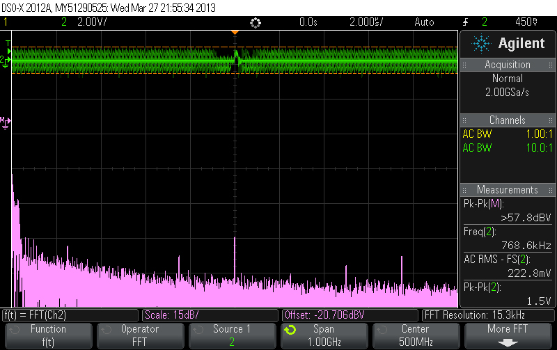

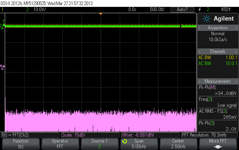

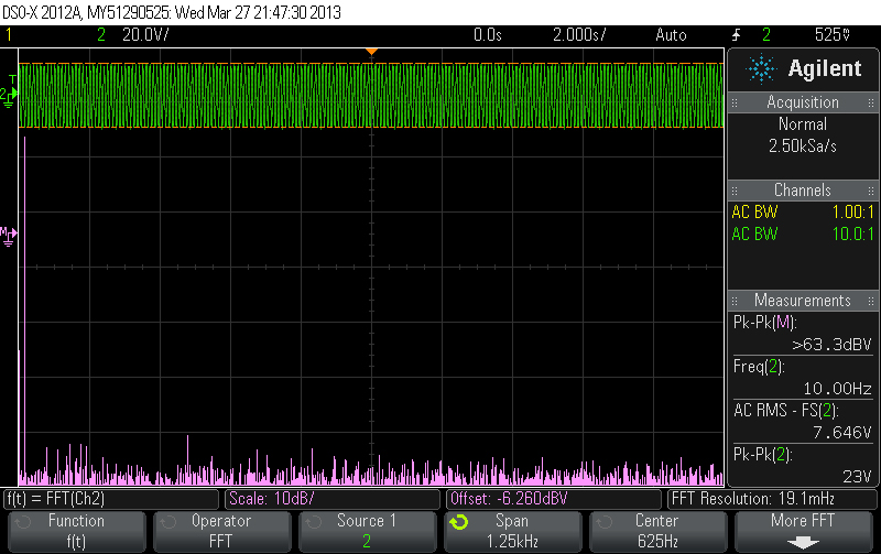

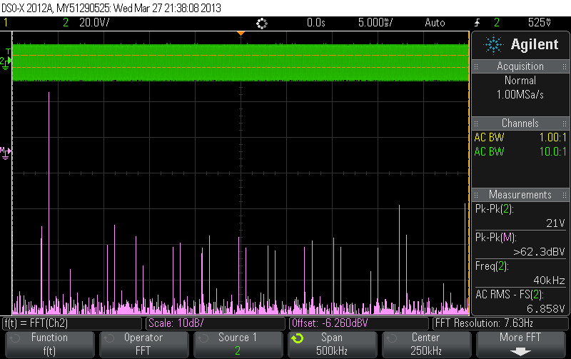

I come again with some (better/right) measurements...
I have generated (Audition old/new) the signals (see pictures): -2dB, 192Khz sampling, 32bit. ASIO 32bit/1ms is used to play out the signal. Picture 9 have an -3dB signal. Oscilloscope coupled directly (10:1) to the RCA output on one channel. I assume that another one have similar parameters...
That`s it! Looks good, looks bad, is another story. It sounds just wonderful (much, much better than an original card) and this is important at last...
(Maybe I will do something about the HF noise to lower that at the output...;) As one can see, the output Vpp level is all the time the same, no matter the frequency which goes through... )

Good measurements Coris. I already wanted to give you the idea of using oscilloscope thinking you've got the access to the academy lab gear and by your knowledge thinking you are the student. You might be able to try the Agilent impedance meter as I used to measure cable. This time you may find the proper capacitor setup and getting the whole measurement up to 110MHz like was in my case. All in a few seconds.
Have you noticed very high noise floor at 60dB? It may be due to oscilloscope resolution limit. I see you moved from 2V peak-peak to 23V at output. Was that true? That's a bit high. My record was ~10Vrms from the I/V opamps only.
You've got some HF noise but it's the limited sampling rate distortion. The generated signal might not be clear enough. Try the ARTA plus the Jitter test. You won't get any distortion from the sampling rate. But to measure jitter this way you've got to have much lower noise. Peaks are HF clock noise, smoothed base of the main singal is the LF noise of the clock.
If it sound good, then it's ok. Too bad we can't compare our cards. What was funny from my headphones is that the drivers acted like a window do the new room. Sounded like there was another room inside and at normal size ;-)
You may see the description. The 7805 input cap. The datasheet shows only most common connection. For the audio application it has to be tuned. Paralleling tantalum and ceramic caps for audio? No. The resonance will kill the final sound. However I use such a connection in one place. Probably not for long.

The 2V scale I used for no signal measurement and HF noises. It were to low signal there to be seen something on 20V scale. I had to use 20V scale for output measurement, because the high level signal...
I have on final opamp power rails +/- 15V, so there is quite normal that is on output 24Vpp. I think is right like this. The NSR is very good over the connection cable (BTW, not even shielded cables...). It is lowered this high level output at right level on the other end (amp input) by an potentiometer. It give me a very good dynamic this way on an unbalanced amplifier...
It is very possible that the generated signal were not very good/accurate. I couldn't control that. Else I had to get in to the board, and I just thought is to much work to do it so. To digital generate a signal is not just the right way to do that, but anyway...
I have seen that HF noise I have is a square non recurrent signal. Quite good defined and very hard to synchronize it to. I do not know very well where it can come from. It may be just noises induced from somewhere in the computer...
To be honest, I do not want very much to work further and find in this area.
The resulted sound (as it is my board per today) is just amazing for an computer sound card.

I minimized semi-HF jitter (+/-50Hz) later too. The Vcom caps are on the board, to the left of the DAC. The stock is AFAIR Nichicon Fine Gold 47uF 25V. The stock measure is not available. It depends on too many things. The datasheet says to use polarized 47uF caps for each channel. There are two caps, each for every channel. Someone may change only one of it and hear the difference between speakers. Right now I'm using low ESR ceramic cap from TDK - C2012, 10uF/10V for HF jitter reduction and AVX - TPSD tantalum cap 220uF/10V for LF jitter reduction.
So if i understand you right, you have soldered 2 capacitors per Vcom rail.
Have you tried low leakage current capacitors bypassed with ceramics?
AVX Tantal 220uF/10v has CV of about 22uA and low leakage current capacitor like Nichicon KL 0,2uA.
If you will try that combination, can you also make measurement and put it here?
