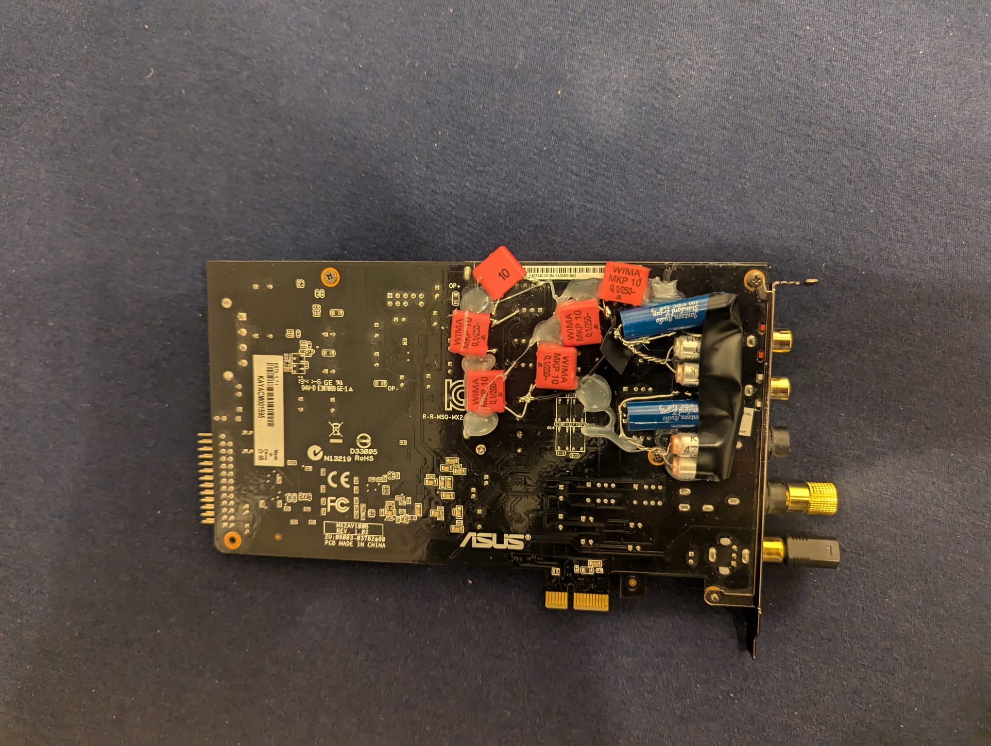

Yes, that caps are the final AC coupling caps. Better replacing it with non polar ones of an higher capacity value (10 -16v rated), and paralleled it with good film caps (1-2µ or more)
Thanks!
I actually had everything I needed already in my workshop.
So while I upgraded the card from Burson V6 to V7 (the Wima caps were already in), I replaced these with 220µF Nichicon ES, parallel with 1µF Jantzen Z-Cap and two 47nF Styroflex (I wanted to use 100nF but did not had them in stock) each.
That one of the caps is bent is on purpose so the card still fits with my network card next to it.
It sounds amazing!

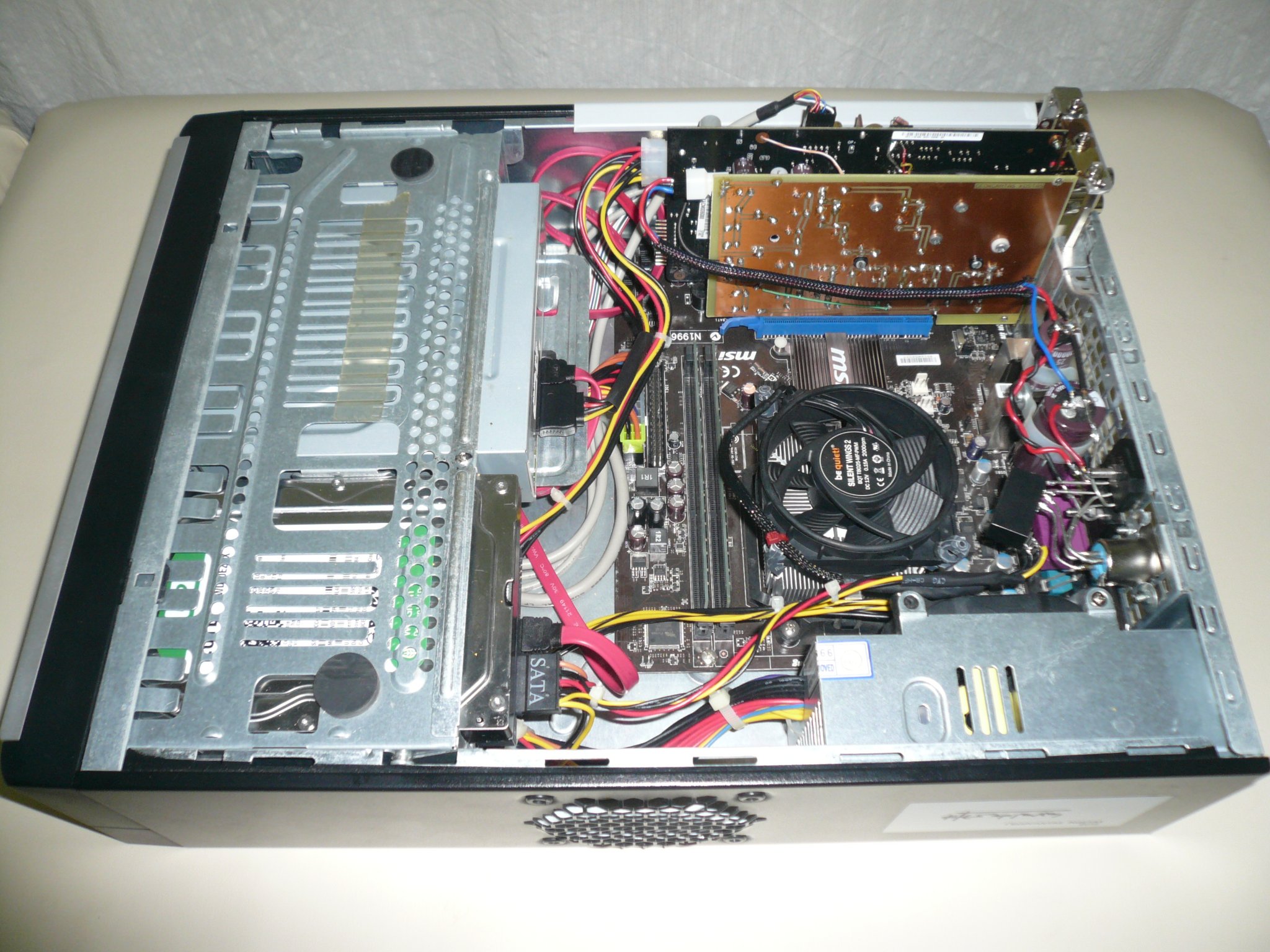

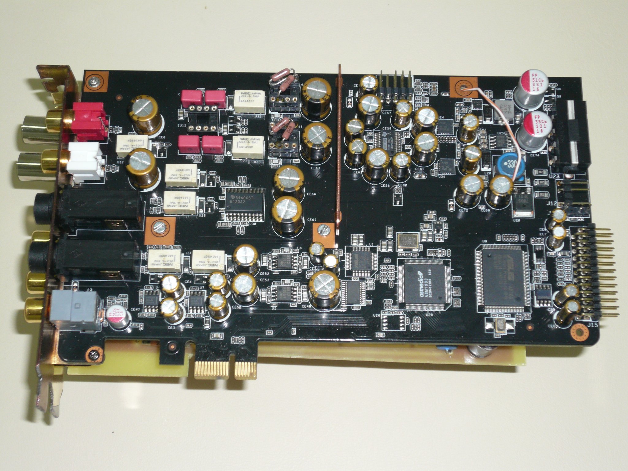

It has been quite a few years I moved from PCI soundcard to usb DAC mostly because there was not enough room to apply any more modifications to Xonar STX. By the time I quit it was looking like this

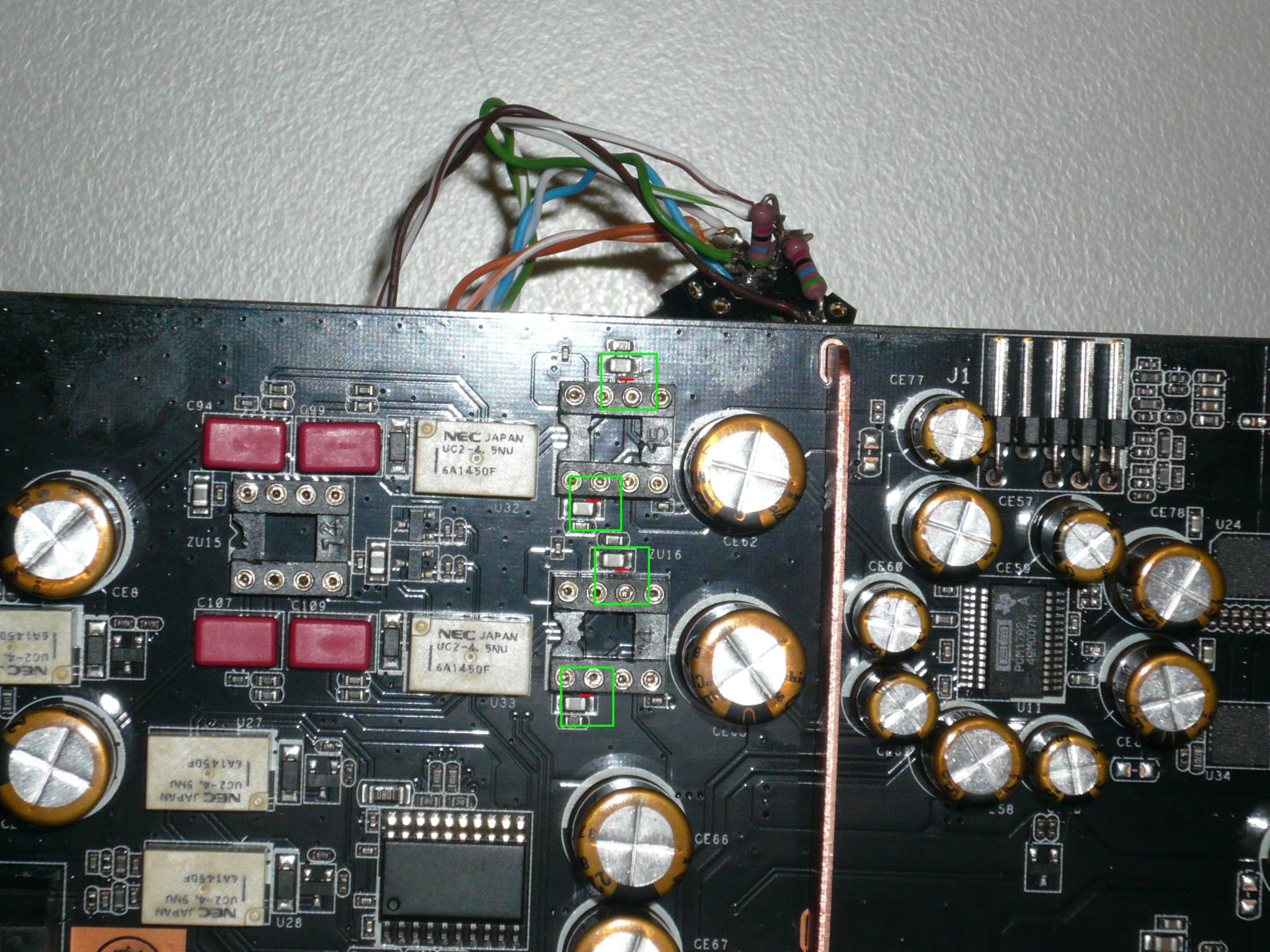

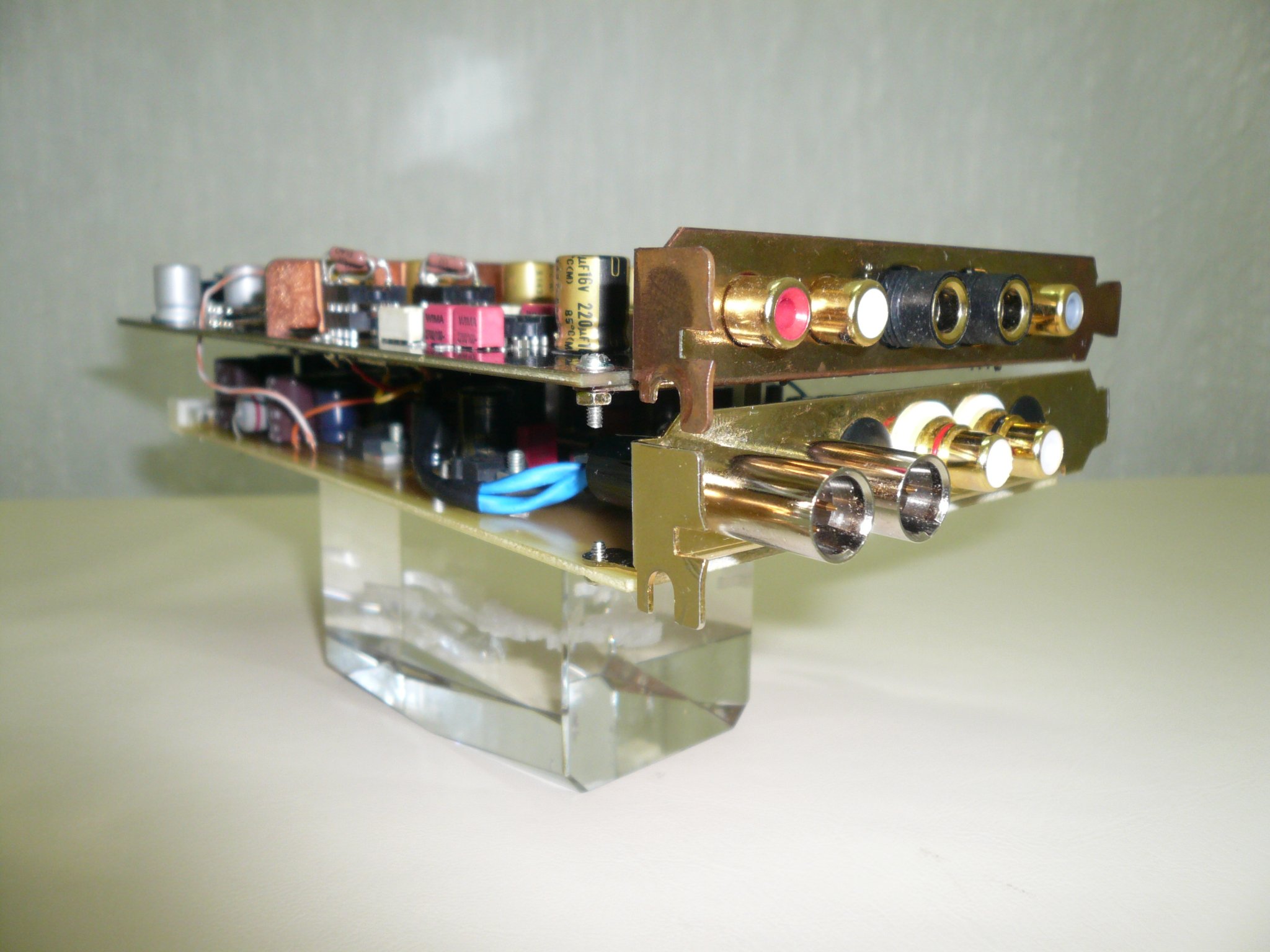

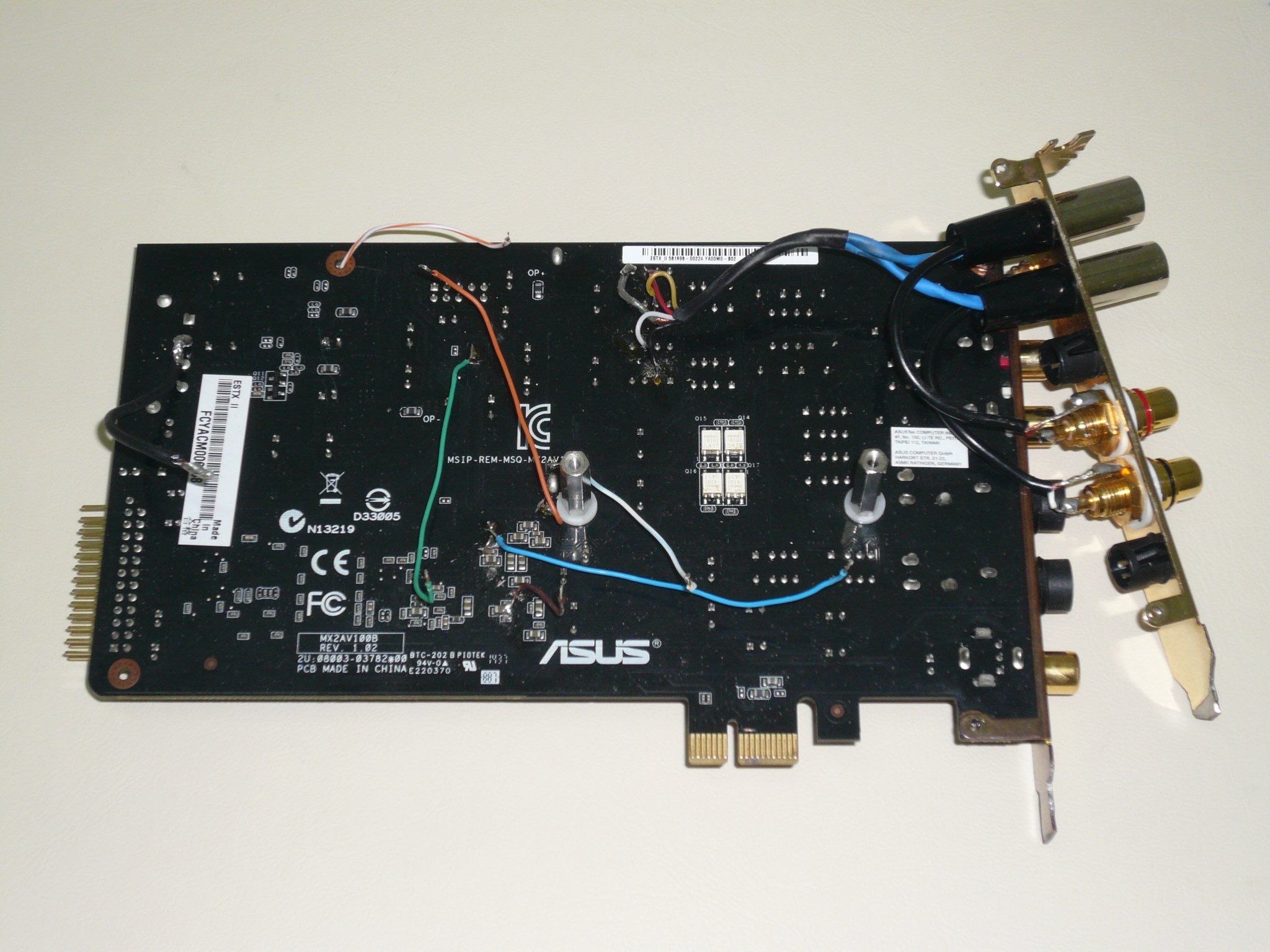

A second PCB is attached underneath like a double slot PCI card, holding dedicated regulators for each chip on the soundcard involving cutting copper traces and the alike. I also converted the output to balanced passive I/V. I cut the RC filters on the opamps feedback network, and wired mini XLR. The I/V resistors were soldered on opamp sockets and allowed to test different values from as low as 2 ohm up to 100, 22 ohm being a nice compromise.

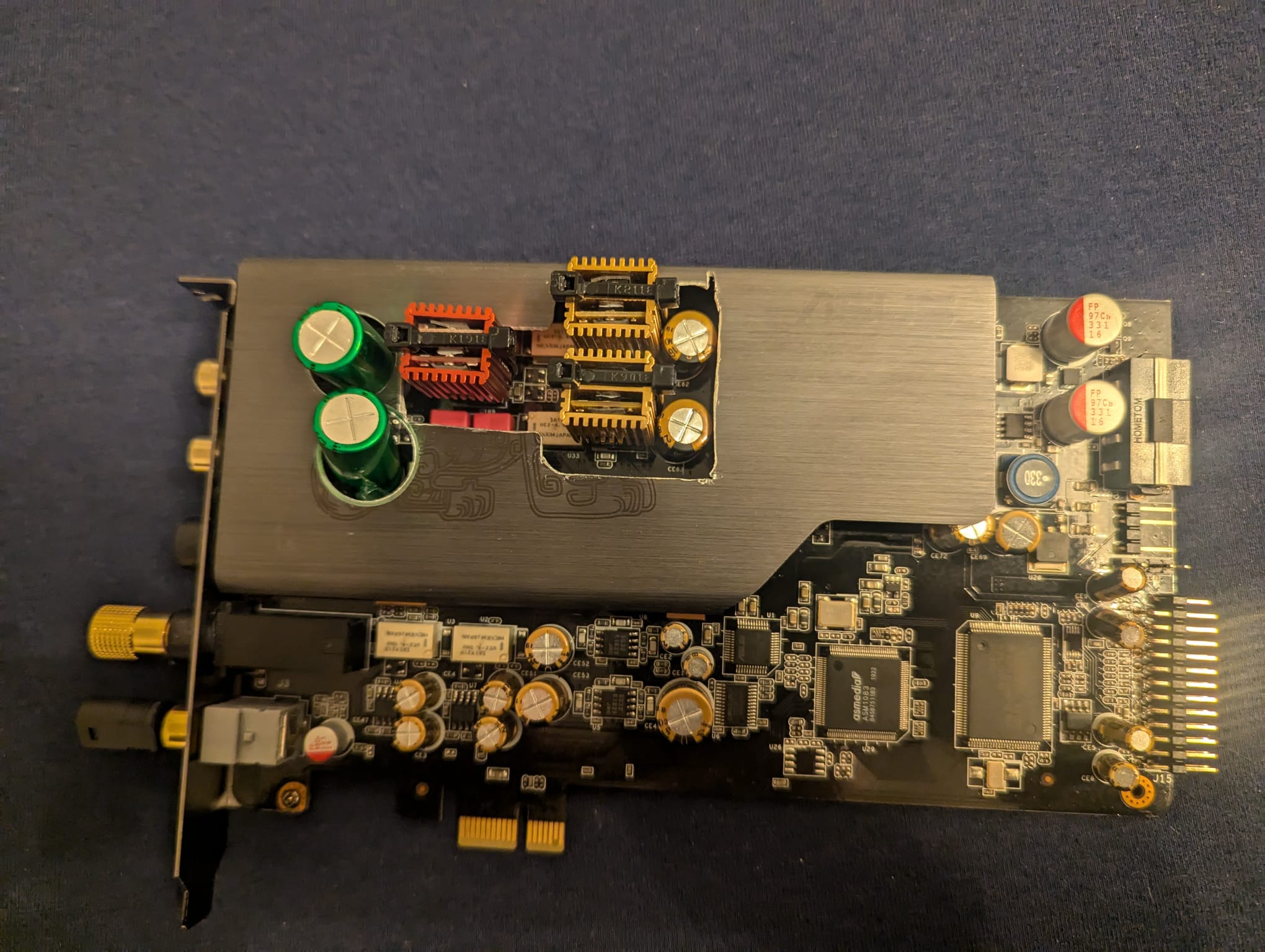

Ah ok. You might want to see if you can find an Essence STX II 7.1 with the daughtercard. It doesn't offer balanced outputs but it does have separate RCA outputs for all 8 channels which is quite a big improvement over 3.5mm stereo jacks. I went from the D2X to that and it was a pretty big improvement.
I used REW to do room correction with Equalizer APO.
