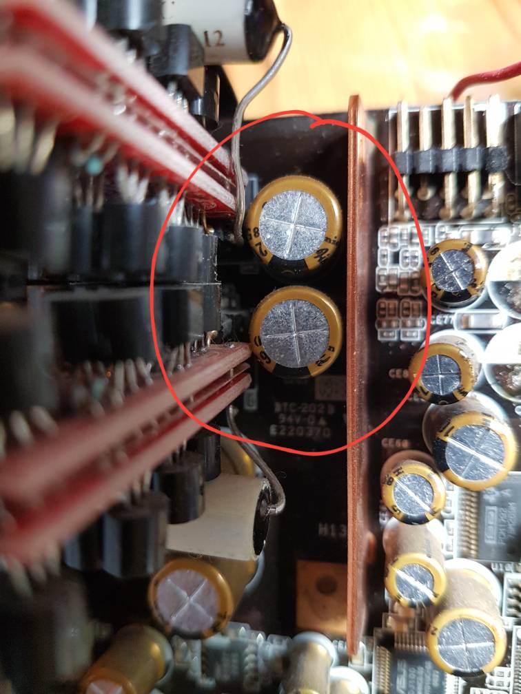

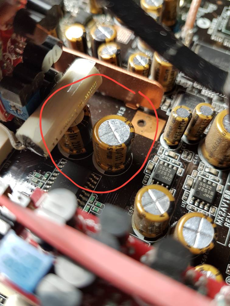

So... Metering out my board, external power is coming into the board at the attachment points just fine. 2 pairs of filter caps next to the opamps, however, are missing one of the input voltages, either the +15 or -15. So the power going into the opamps is just 15v instead of 30v.
From here, I can't see where else to check... I also don't see any bulging caps or damaged components. 20170906_185447.jpg20170906_185414.jpg
Well, is quite a time since I have been there (into the STX board)...
I think you should go step by step, measuring the +/- voltages from the connector to the point you find only one of these rails. I understood you are missing the -15, right?
If you can measure the current of these +/- lines, it could be useful to see if it may be a larger current on one than on other one. If so, then maybe a filtering cap it could leak too much, or so...
You see on the picture here the caps involved in filtering these two rails (before the opamps power inputs. Try to measure the surrounded components (there are two ferrite bead there also), and maybe you will find where the missing rail it actually disappear.

Thank you for the reply! You may recall, my board is one of the highly modified ones. Those 2 larger caps are removed and that is where I attached my external PSU.
Power is okay at the attachment points. I'll meter the remaining two caps and 2 beads and get back to you. Thanks for your help!

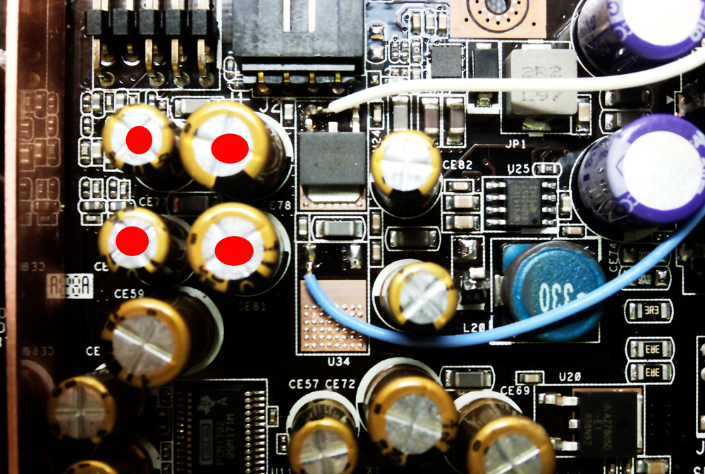

IMHO adding external power supply to the molex won't make much an improvement. There's switching regs ICs on the board that provide +/- 12V for the IV and headphone amps from +5V on the molex and they're noisy. Also the 5V analog for the DAC is powered from +12V of the molex through a 7805 - here you will get SOME improvement. 3.3V comes directly from the PCIex slot and it's... dirty.
The best results would be to add linear regulated power on the board with separate feeds to +12,-12, 5 and 3.3V.
If you really feel the need to add external power to the molex I'd say 2.5/3A for the 5V line and 0.5/1A for the 12V line.
I've connected the molex many times AFTER the rest of the PC was on and I think you will have no problems powering the molex first as long as the external supply is grounded to the PC supply (even at the molex connector).
In short you will make no smoke around if the supplies share the same ground.
