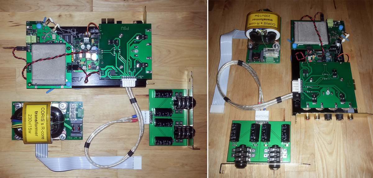

In my approach (previous picture) I use a special designed flexible PCB to connect my DAC board inputs to the Asus board (through galvanic isolators).

The (very) final version of my STX mod
R core transformer for power supply, main line filter added, and improved grounding in AC area, as a much more proff approach for the XLR connections (dedicated board).

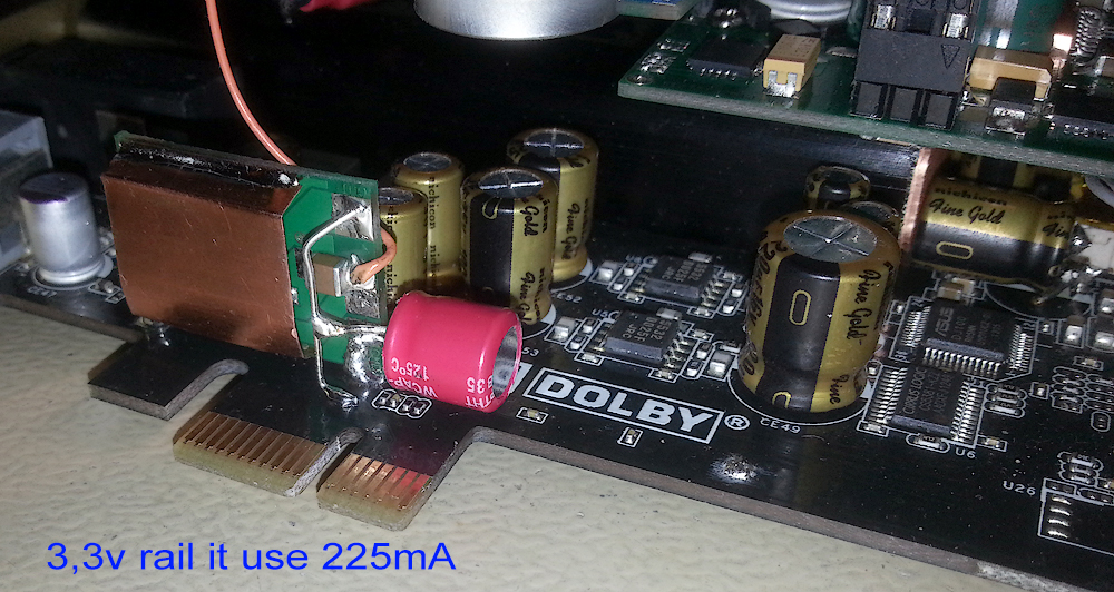

I mentioned in one of my previous posts (745), about my (very) final mod version for ST/STX sound cards.
Well, I found out about a very important detail, which I have ignored it until now: the 3,3v rail for the digital stage on board. This power rail is coming from the computer motherboard (through PCIe connector for STX board). There is a quite big ferrite bead which is used as filter on this power rail (picture).
I disconnected this rail from the computer power system, and I used one of my ultra low noise 3,3v regulators (based on ADM7151), to power the digital stage of the sound card (I used also for this purpose, one of the power rails in my dedicated PSU for the system). Please note that this 3,3v rail is a digital one, and it must have as GND the digital ground on the board/computer (in my case completely isolated from the analogue one). The result: exceptional, and over all expectations. I never imagined the digital chips involved in this sound card design and processing, are capable for such fidelity, and very high quality for the outputted audio signals. They are indeed, when it get the right very low noise power.
To power the processors on board by a low noise (analogue) power supply it is the same crucial as doing it for the DAC chip, and the post DAC analogue signal processing circuits.
The dynamics of the signals are improved a lot, the soundstage, and the fidelity of the reproduced sound components it is only unprecedented. The bass components are very powerful (at the same volume level), deep and very pleasant to listen to. The volume of the soundscene is larger and the sound elements very well defined as positions. The overall impression: extreme fidelity.

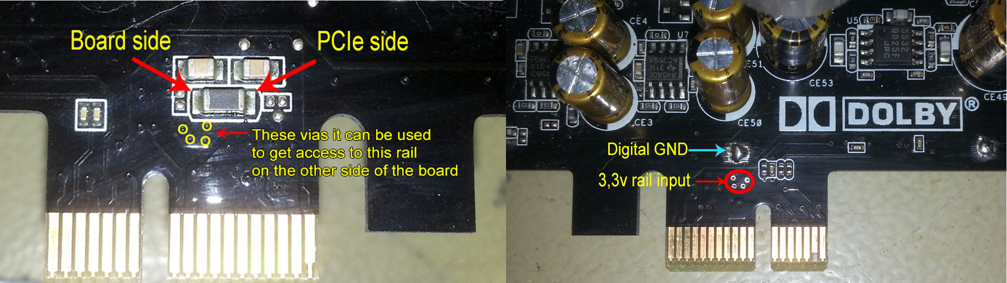

Well, all the informations are already in the pictures I published in my previous post. However, without knowing some basics in this field, may be quite difficult to fulfil the task...
The eventual 3,3v regulator it should be placed so to input its power in the point marked on the picture (vias), and the ground connection could be right beside (creating a GND point by scratching the ground plane of the board in that area).
An external power supply for this board, should be ON/OFF synchronized with the main power system of the host computer.
