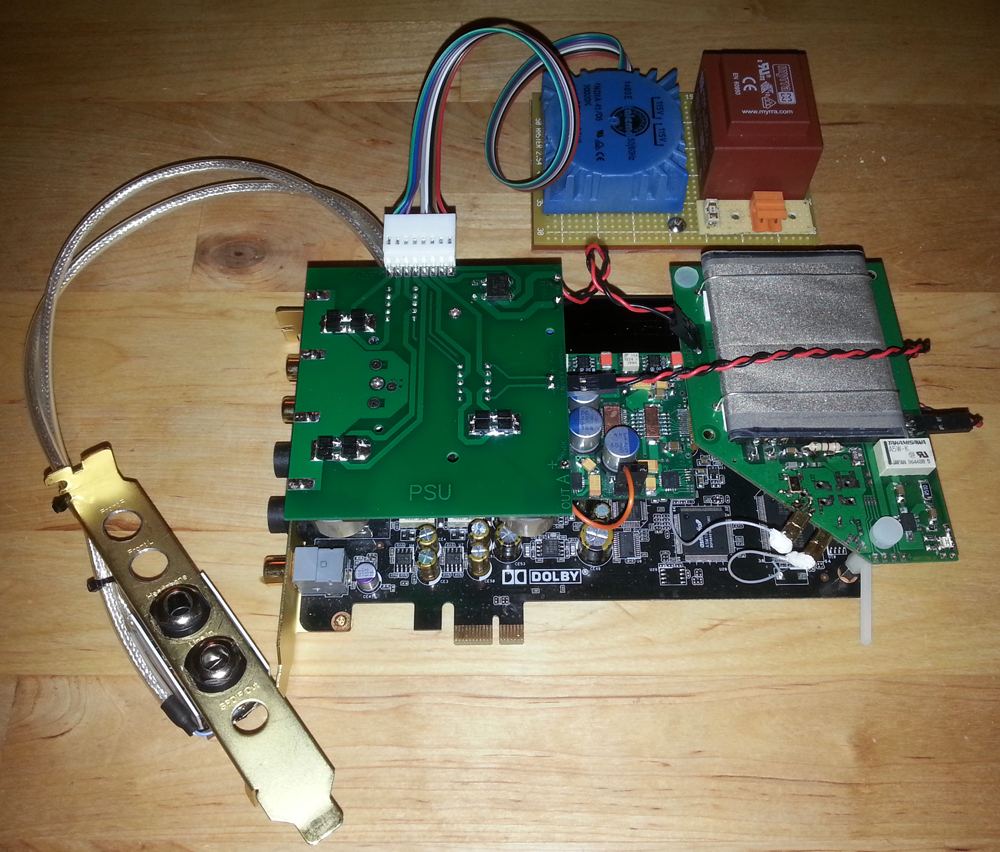

I've done the next mods with great results to my Xonar Essence ST:
- External power supply for 5V, +15V, -15V directly soldered to the out pads of the 78xx regulators.
+-15V use two lm340 fixed and for the 5V I use lm317 plus a cascaded lt1963A.
- AD8599 opamps on all the three positions.
- Removed output capacitors and replaced them with wire.
With all the mods, the soundcard starts to sound a bit magical, but i want more.
What option do you thing is better for the next step?
a) Build 3.3V power supply with lt1963A. But I'm not sure where can I solder my 3.3V and where to cut the 3.3V line from PC.
b) Upgrade to a 5V clock so I don't have to build a new 3.3V power supply. I think that the on board clock is feed by the 3.3V line. Is this correct?
So a 5V crystal will improve things due to clean supply. What crystal do you recommend?
My PC power supply is a TP750C, it is not "bad" and the SQ is greatly improved.
The best mod for me is the power supply for 5V and +-15V. I think that simple lm317/lm337 boards feeded by its own transformers and rectifiers improve the soundcard the easy and cheap way. Don't use high current versions of LM317 board with transistors that ruin the noise/ripple...
Super regulators are nice, but hard to implement and expensive.

3.3V is on the back of the board right at the PCIex connector at least on the STX see ferrite marked in red. It's a shame that the processor and DAC digital 3.3V is powered via PCI/PCIex on these cards.
Crystal on ST isn't powered. Only oscillators are powered. You have the clock conditioning on the ST CS2000 on board which ensures jitter stays low, so I wouldn't mess with the clock for PCI ST.
Post a back picture of your ST and someone may point to where to insert the 3.3V. COuld not find a back pic for the ST.
My discreet pSU is outputting correct voltage -+15.6V though....
The capacitors for the OPAs and the headphone amp are 16V... so don't go any higher with the supplies.

I work now to a more elegant/professional mod for an ST/STX card. There is about a completely new DAC design using the same PCM1792 chip, and also a new I/V and final stage. There will be also two solutions for powering the analogue stages: using the built in (moded) PSUs, or an external high end PSU. I will come out with some pictures in the near future
