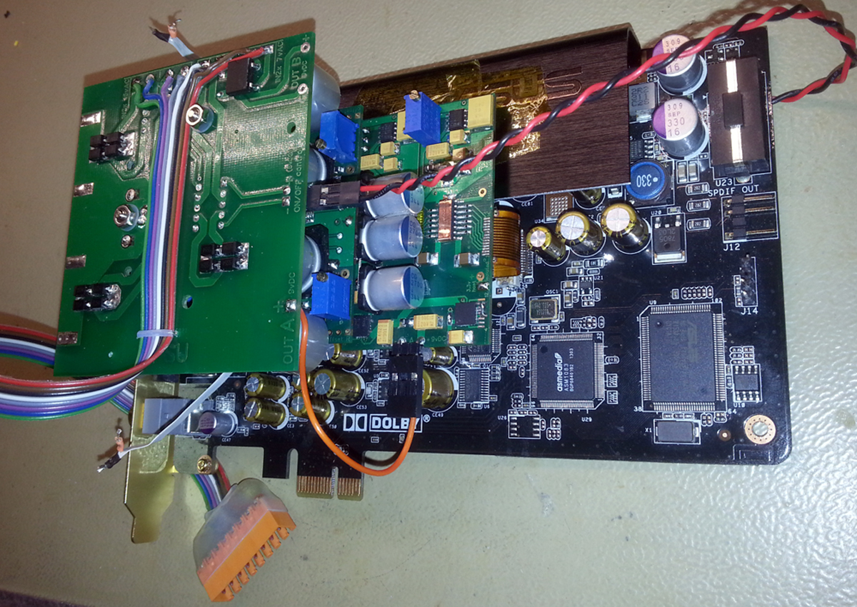

Fully electrical isolated from the rest of the computer, redesigned DAC system, with its own ultimate low noise regulators.
If you may go back into the thread, you may see also the battery powered clock board, special designed for this board.
A new final upgraded/improved version of this complete mod it will come out in the next weeks.
The only intervention on the original board is to mount the connector for new DAC system over the original DAC chip, as removing the original resonators, and connecting the coaxes for new clock system.
Send in your ST/STX, and you may have the mod installed. For more details PM me.
