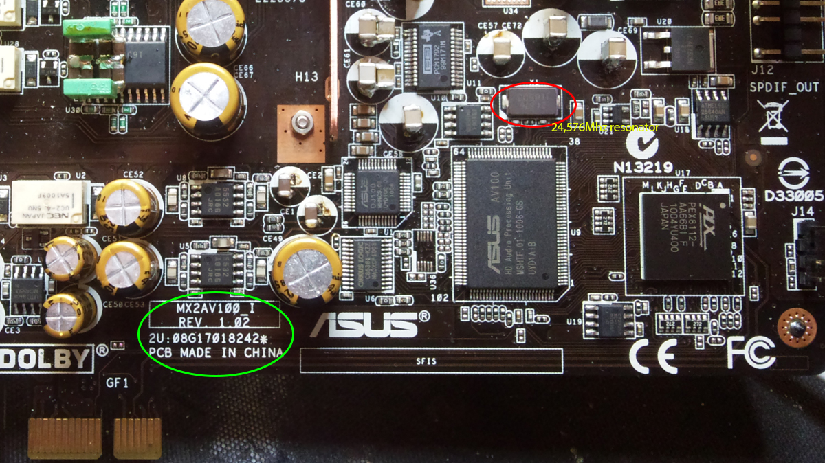

frog993, let me explain how power supply is arranged. Strart with molex +12V and + 5V
1.) +12V thru three 3.3 Ohm resistors feeds the 7805, that in his turn supplies analog part of DAC and auxilary consumers (ADC and relays)
2) +5V is converted by the HF invertor into +15V, that feeds the 7812 and into -12V (in fact, it would be better to have -15V and 7912 then, while there is place for 7909 on the PCB). Thus, we have splitted power supply (+/-12V) for I/U and output stage as well as for the headamp.
+3.3V comes directly from the PCI and feeds digital part of PCM as well as DSP.
The picture belows shows the power paths.

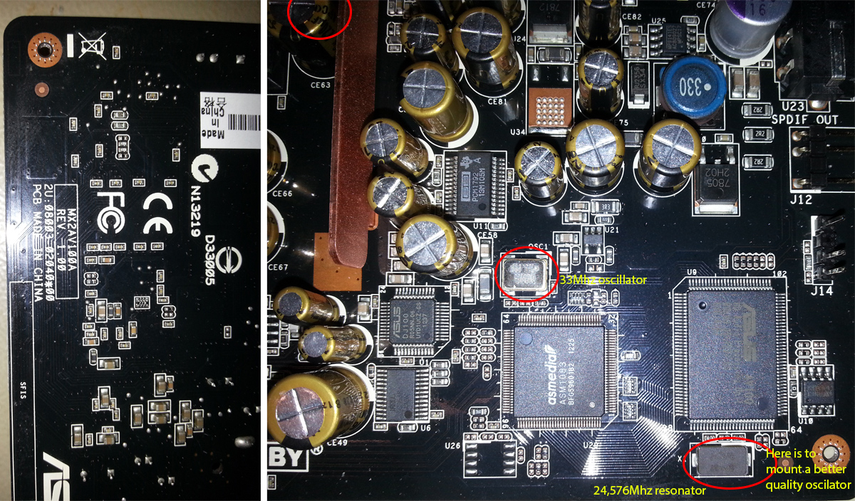

Changing the op amps without having a better power supply for the audio board is quite nonsense. The same is about a better clock...
Having a better oscillator with a bad power system is not very logic too...
So... The first step one may take, is to provide a better power for the board. This is not very easy mod! A serial PSU for the analogue stage of the board is recommended first. The same PSU it may be used to get 5v and 3,3v, for some stages on the board. Do not forget that the driver software of the sound card it need to see 5v and 12v from the computer, to not generate errors...
The second enhancement is to put in place a better oscillator. Powering this oscillator from a battery is the best one can get in this area. Moderate difficultly.
Having those mods in place, one may try further to experiment with another op amps, caps, and so on.
But, the most important, before one may proceed to modifying the sound card, is to be ensured that the sound card run on a quite good computer system, tweaked for audio use. Here is about having in place a good motherboard, processor, an efficient OS and the rest of the audio software installed.

For the ones interested in ST/STX boards: there are issued two versions (at last as I know now) of these boards. 1.00 and 1.02. Some chips and layout of the boards differ a bit. I do not know what is better of these two, but logically it may be the 1.02 version, even though I bought only in the last time an 1.00 version. It looks to me that 1.00 it may be newer, but then is a very strange way to number it the versions...I can see that 1.00 version it have a oscillator more for the main processor...
Is quite hard to identify the audio card versions before buy it. There are presented as the same.
I experienced this in the last time... So just be aware about.

What does the extra osc say in terms of frequency? I've got a hunch what it could be, but...It looks to me that 1.00 it may be newer, but then is a very strange way to number it the versions...I can see that 1.00 version it have a oscillator more for the main processor...
According to what Samuel Groner found out when testing the LME49860, common-mode distortion at lower frequencies seems to improve quite a bit at 21 V vs. 15 V, though the difference is marginal by 10k. Should be measurable anyway (though at a THD1k of <0.001% even on the stock card, it has more to do with sport than anything else). The reduction in input impedance distortion is interesting for applications with high source impedance, but an opamp isn't likely to see that on a soundcard.PS
A note on the so-called better sounding operation of the LME 44v op-amps @ 22v rail vs. 15v, I would advise one to read the spec sheets of these op-amps and pay special attention to the 15v and 22v THD / IMD graphs. There is a negligible diffrence between these two supply ratings.
It seems to me that the 33Mhz oscillator drive (clock) the ASmedia processor on the v1.00 board. On v1.02 board this oscillator it does not exist. It looks to me that the PLX chip in v1.02 is replaced with Asmedia chip in v1.00. This is the EAX processor, with some other functions.
Even though the numbering of versions, it seems to me that v1.00 is newer than 1.02.
BTW, my STX v1.02 is few years old, while v1.00 I have bought it few month ago...
