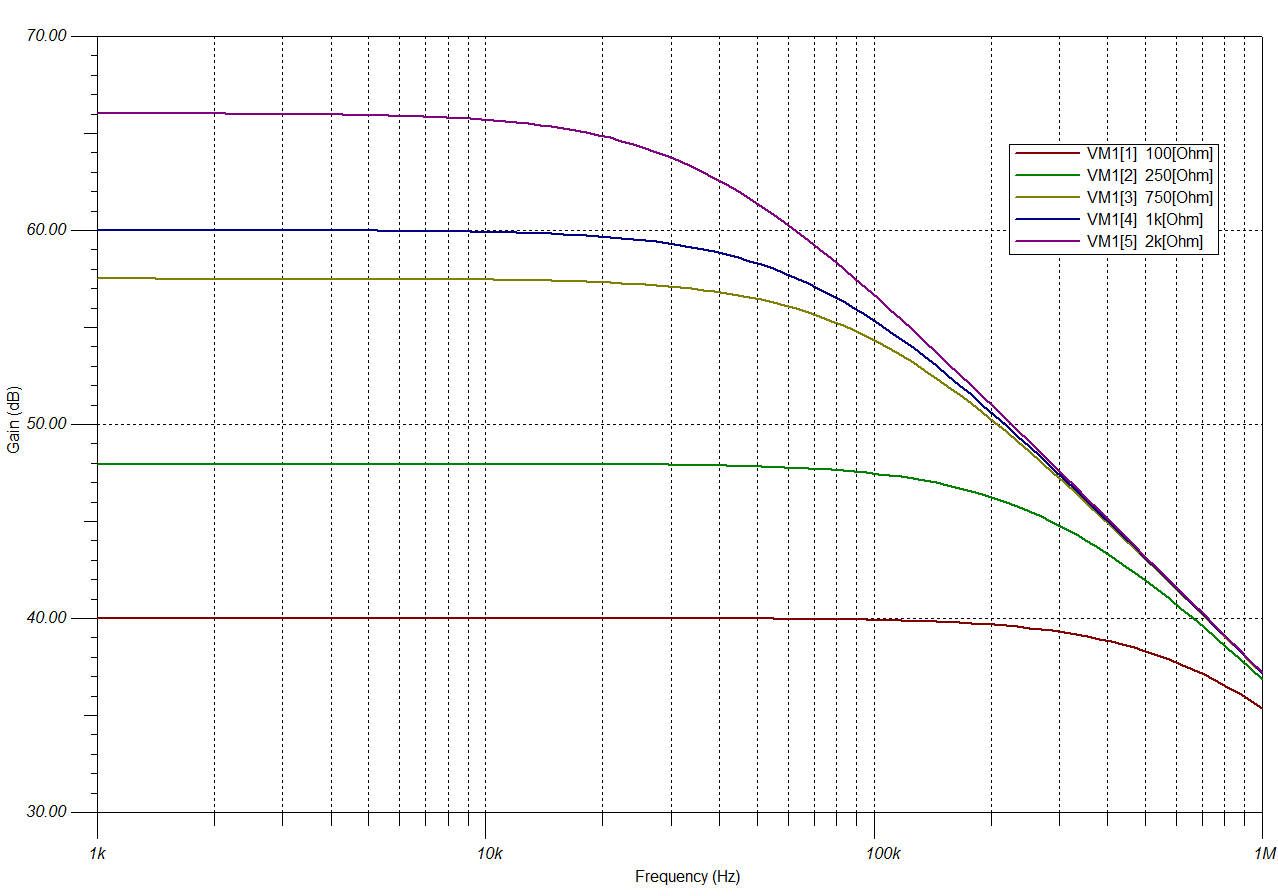

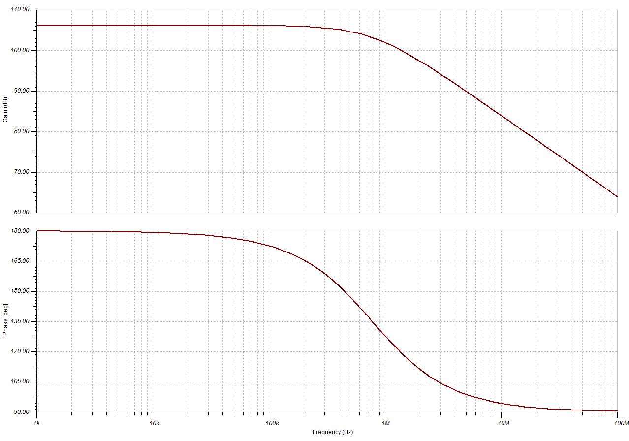

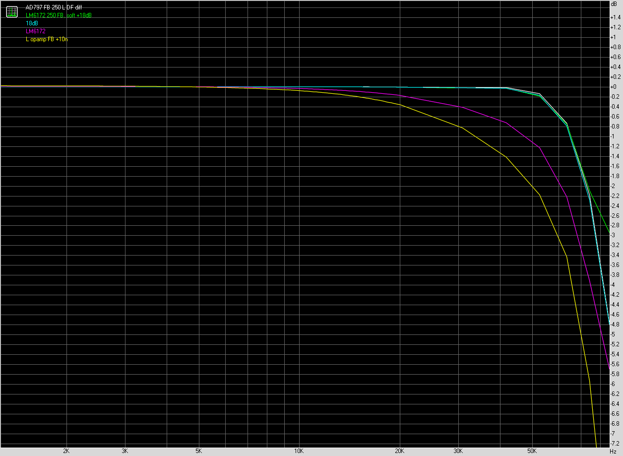

I simulated the I/V circuit with the TINA. Before I just tested the feedback filter. Now the whole I/V is present and I plan to add the TPA circuit. I placed the output resistors too and simulated with LM6172 using ideal R and C elements. The stock bandwith is much wider.

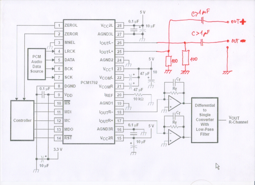

Yes, I did. I actually build it my own I/V circuit and final stage. The basic tip here is use high precise and thermal stable class resistor for I/V conversion. Those resistors are quite expensive, but is about only two of such here. Good decoupling on those stages are very important too, as very short connections between DAC chip and I/V stage.
BTW, use few teens pF caps on I/V resistor.

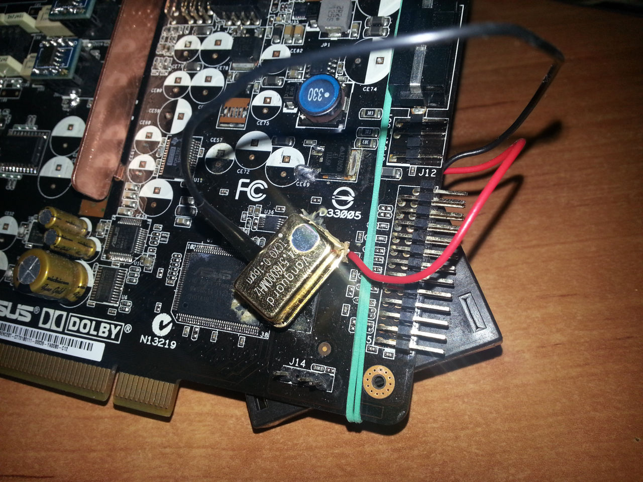

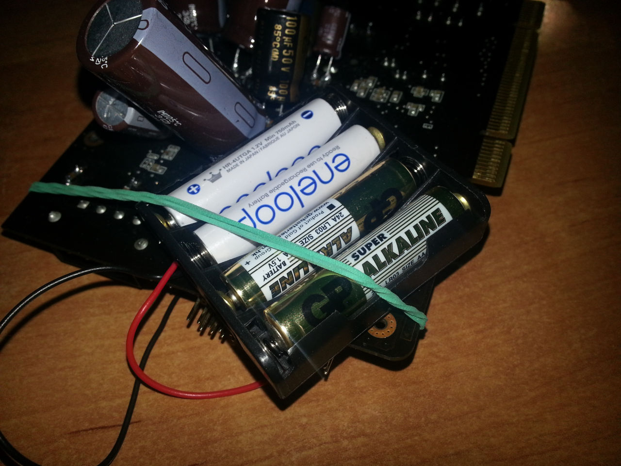

I've just removed last electrolytic caps on the xonar board: Sanyo SEP 330u/16V on the 5V molex. These are mounted only on the ST board, the STX uses AFAIR 270uF oscons, series not known to me. In the datasheet SEP are good. I find other caps to better in this place. Measurements tell the same.
I'm switching to the battery clock power supply today, no voltage regulator, no caps. What may I expect to hear and measure?
Good idea!
I see in the pictures that you used some standard batteries. I`m not very sure it is the right solution... It is not so much power in those kind of batteries, and it may have enough internal resistance, and maybe enough noise because that. It get discharged quite fast and what`s next? Stop playing to change the batteries?
I may use an enough high power capacity battery, as Li-Ion or so, and not at least, rechargeable. A relay it have to connect/disconnect the battery to/from oscillator, when power ON/OFF. When power off, the relay can be used to connect the charger to the battery.
A mobile phone battery is the right one to be used here. It have huge A/h capacity to power that oscillator, it decharge very slowly, and is enough small.
A such battery deliver quite long time 4,2v after fully charged. It may be enough for that 5v oscillator. But I want to use an 3,3v oscillator in that place. The processor works very well with a 3,3v oscillator... But one can also use two phone batteries serial connected (7-8v) in this case...
You may calculate (assure) the right current (data sheet) for the oscillator when powered from battery. I will recommend to simulate the current/tension needed by the oscillator using first resistors network connected to the battery. Measure and assure everything is right before connect the oscillator to the battery. Do not forget to interconnect a fuse between battery and oscillator. I have experienced an oscillator which malfunction and it shorted its regulator to GND. Using battery such malfunction can end with fire...
Use very short connection wires and ferrite bead in between on power rails. You may want to use an decoupling (100µ ceramic) cap right on the power inn pin of the oscillator.
I do not know how it may behave Vanguard when powered from battery. But another kind of oscillators (specially CMOS) I have powered this way it works wonderful on battery.
I will not tell much about the sound out of a such powered oscillator... You will have a pleasant surprise...🙂
